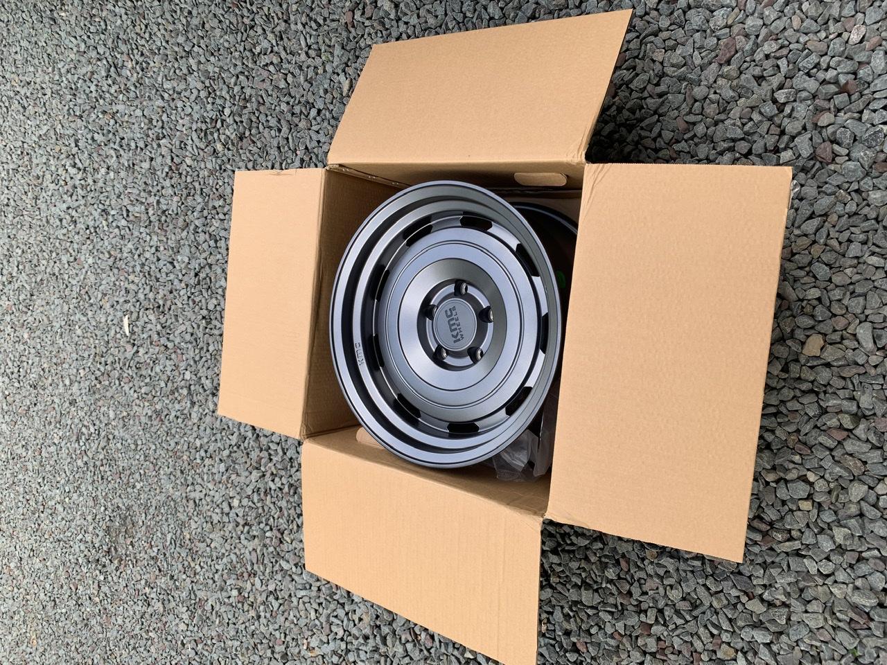

I've been hemming and hawing on wheel selection when I noticed that the gray versions of the Roswell wheels by KMC (1 of 2 finalists) were significantly cheaper than black. Enough cheaper to where I ended up grabbing 5 for a full spare. They are being powder coated so color doesn't really matter.
Wheel Specs:
Offset: 0mm
Weight: 26lbs
Tires:
Make: Toyo Open Country A/T 3
Tires weren't cheap but I've been wanting to run these since they came out. The reduced width vs. 12.5" will help cut down to the ice in winter while slinging a tad less sludge down the side of the truck.
All in all, I was able to get:
5 wheels
5 tires
Set of 4 black spline lugs
$2,243 shipped from Extreme Customs although I had to call in to get that pricing.
I'll update the posting when they come back from powder and when mounted.
