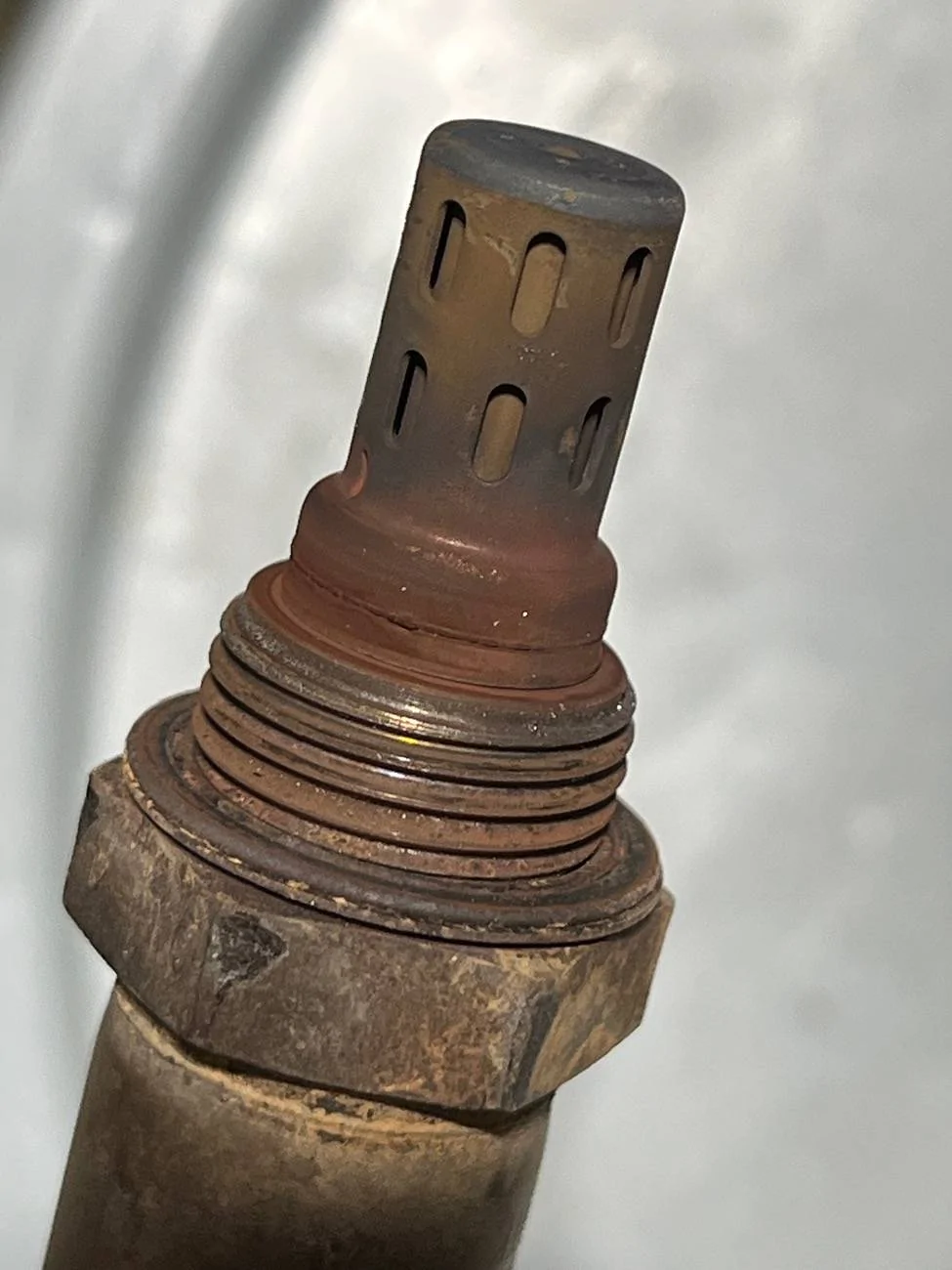

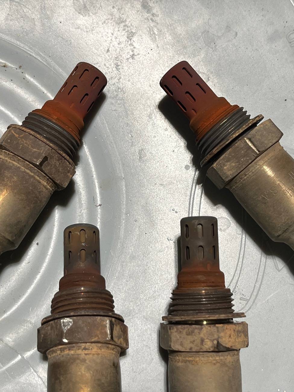

Changed Out Oxygen Sensors

@Hootbro have you tried other brands ? I seen extreme terrain had Bosch brand O2 sensors dont know which of tbe 2 would be for upstream versus downstream though
Have not changed a O2 on a Gladiator but have on my then owned 2018 JL. Used a OEM brand NTK/NGK O2 sensor.
Tend to stay away from non OE branded aftermarket. DENSO would be my first pick if NTK/NGK was not available. I also tend to stay away from BOSCH aftermarket unless I know they are the OE for what I am replacing.

Thanks @Hootbro 👍 I will buy OEM .. good price on moparpartsgiant.com 50.00 range
