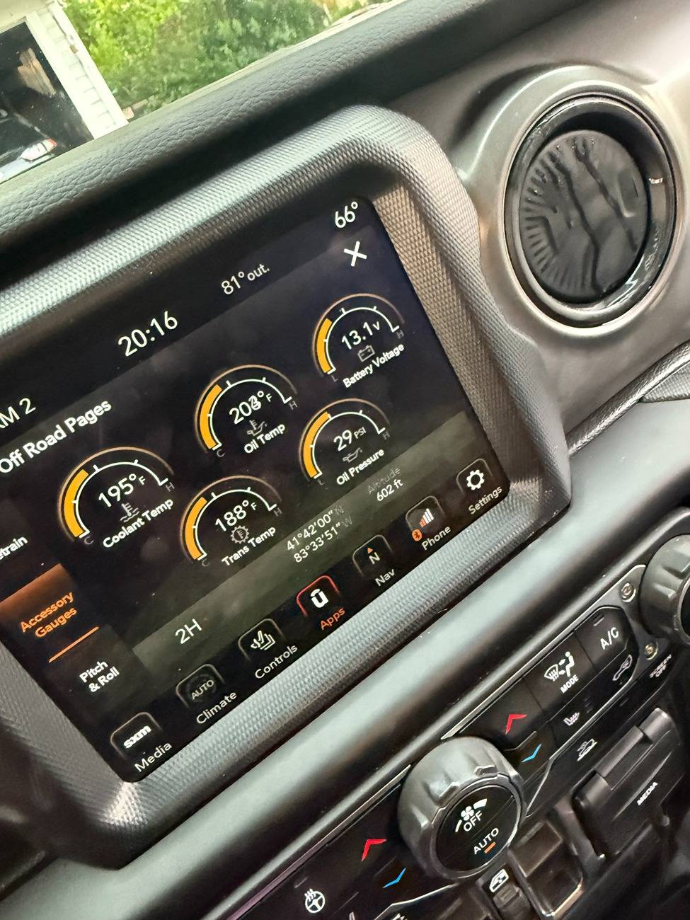

How do we feel if I go to dealer and have them change all fluids every 30k miles? That should help with long term of vehicle like 300k miles of engine and trans?
And then I take it these are all the normal readings, or what are the normal values here?

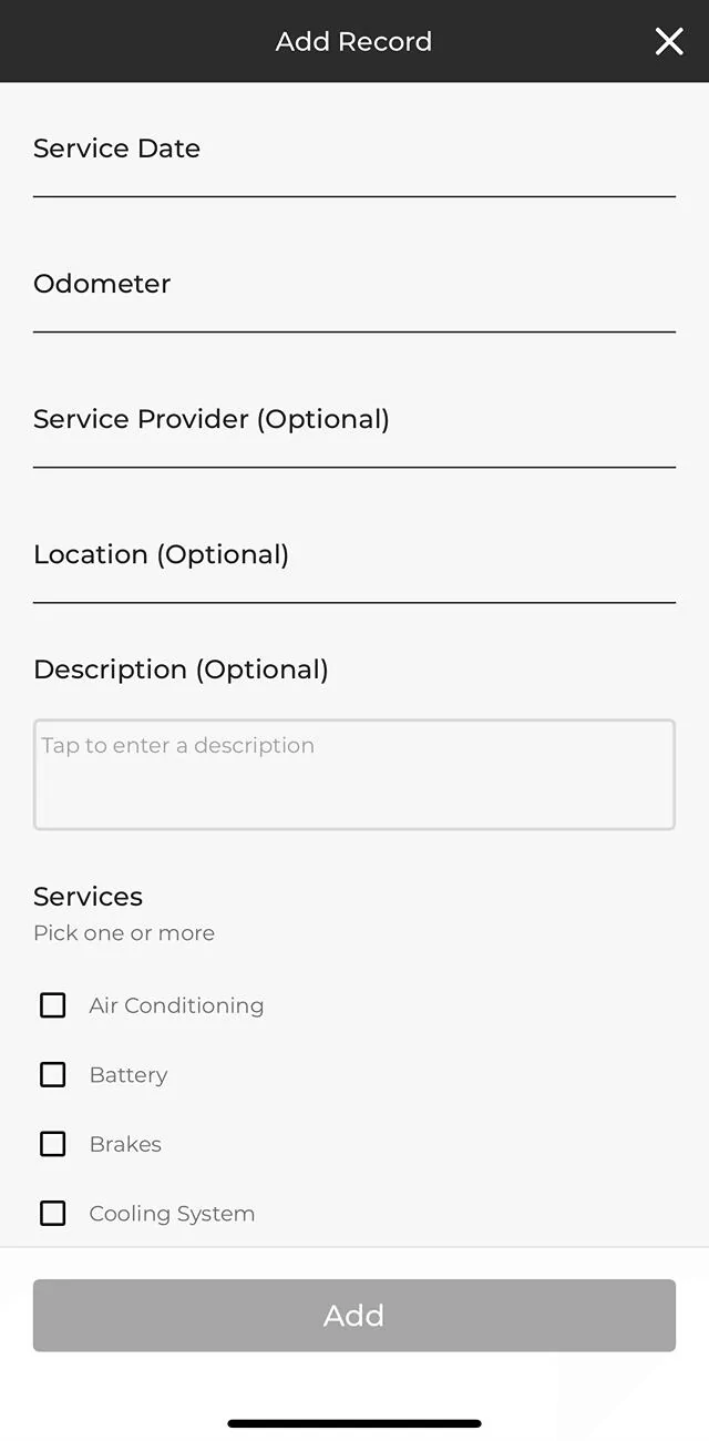

I’ve done my own oil, diff, brake fluid. I make sure to document what I’ve done and keep receipts. If you have the Jeep app, in the “history” section of Service and Maintenance, it will show what work the dealer(s) have done, but also allows you to “Add a Record,” if you want to document it there as well.
Jeep Gladiator Changing Fluids & Temps 1752680918520-4d

Those readings are more than fine. You could run hotter than that and still be perfectly fine. Nothing wrong there at all.
As for the rest - waste of time and money.
