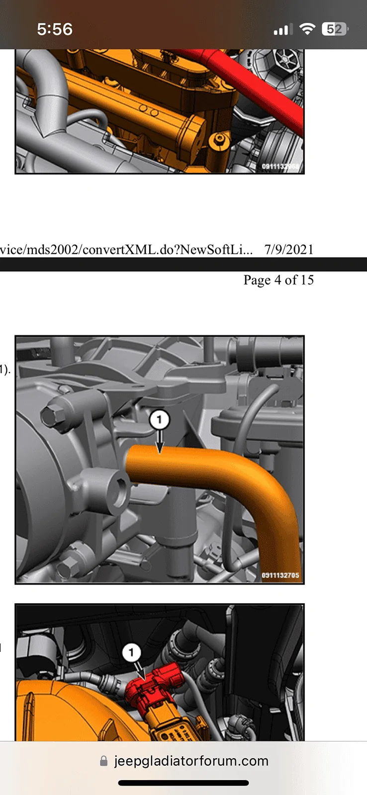

I think that I found my answer here ( for question #2 ), from JK Gear & Gadgets =>
I'm still not sure what he did to remove that hose with the weaved cover, but I can see it free-hanging after he has the intake plenum off.
