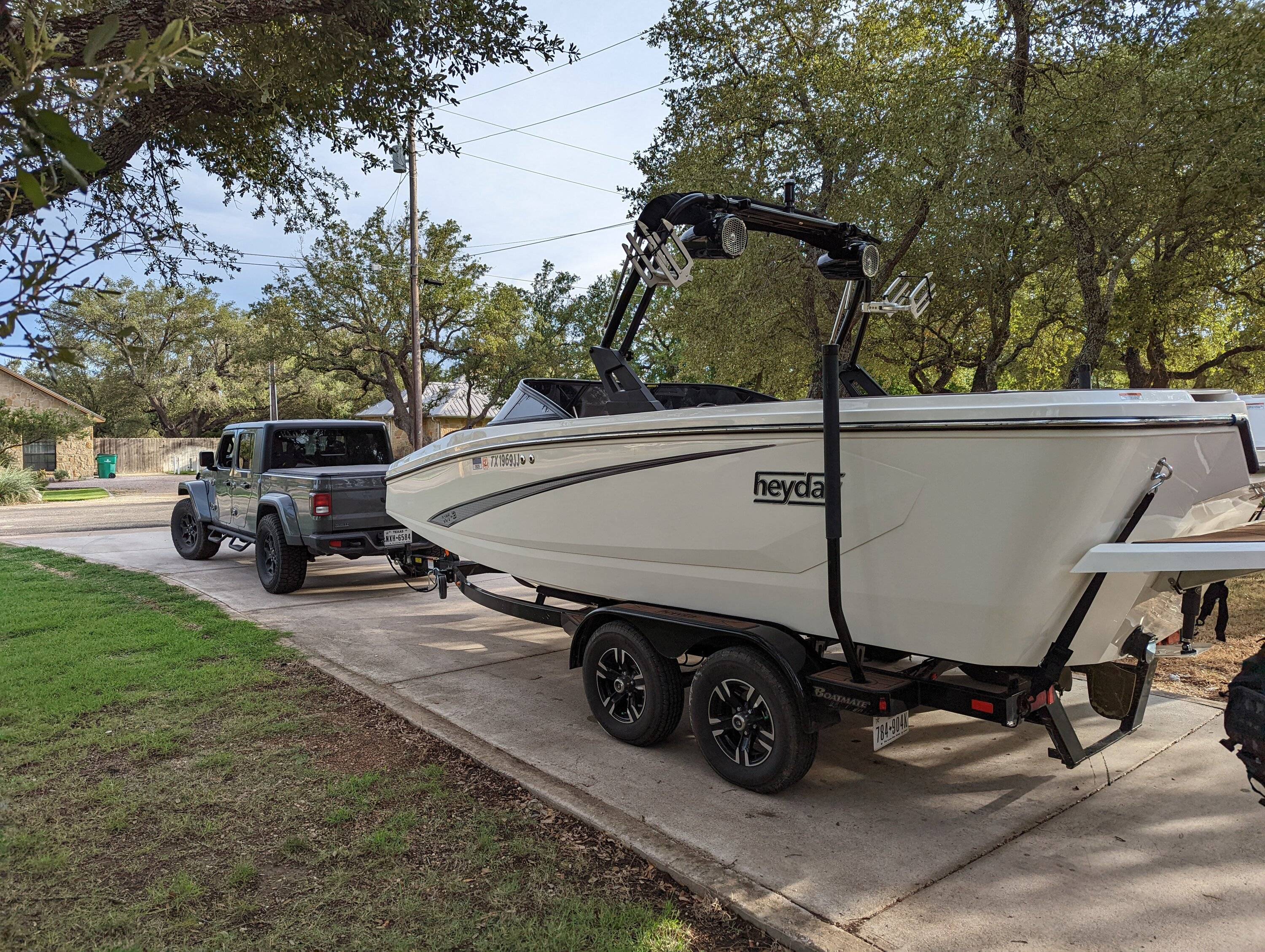

That’s a 19ft’r, I’d be happy pulling the new 22ft’r but after that the beam will be too wide for me to see anything behind me even if I ran extended mirrors. The Gladiator is just too narrow to tow the larger boats on the regular.
Can’t wait for boat season.
Good luck I

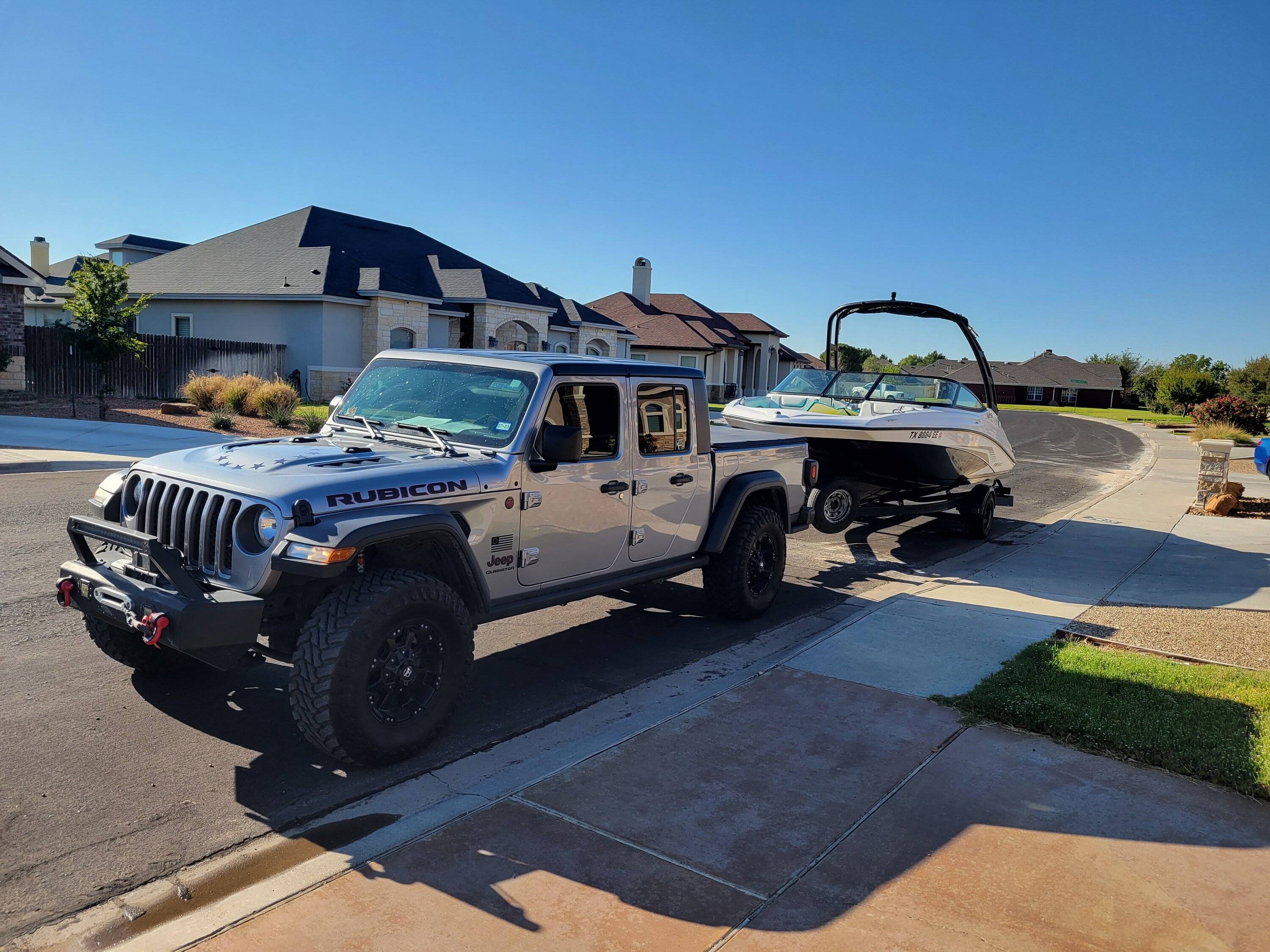

I tow this through the Texas hill country just fine. Just be smart about not going to fast and leave stopping distance. Surge breaks really do quite a bit to help. Stopping is always the biggest concern when towing.
