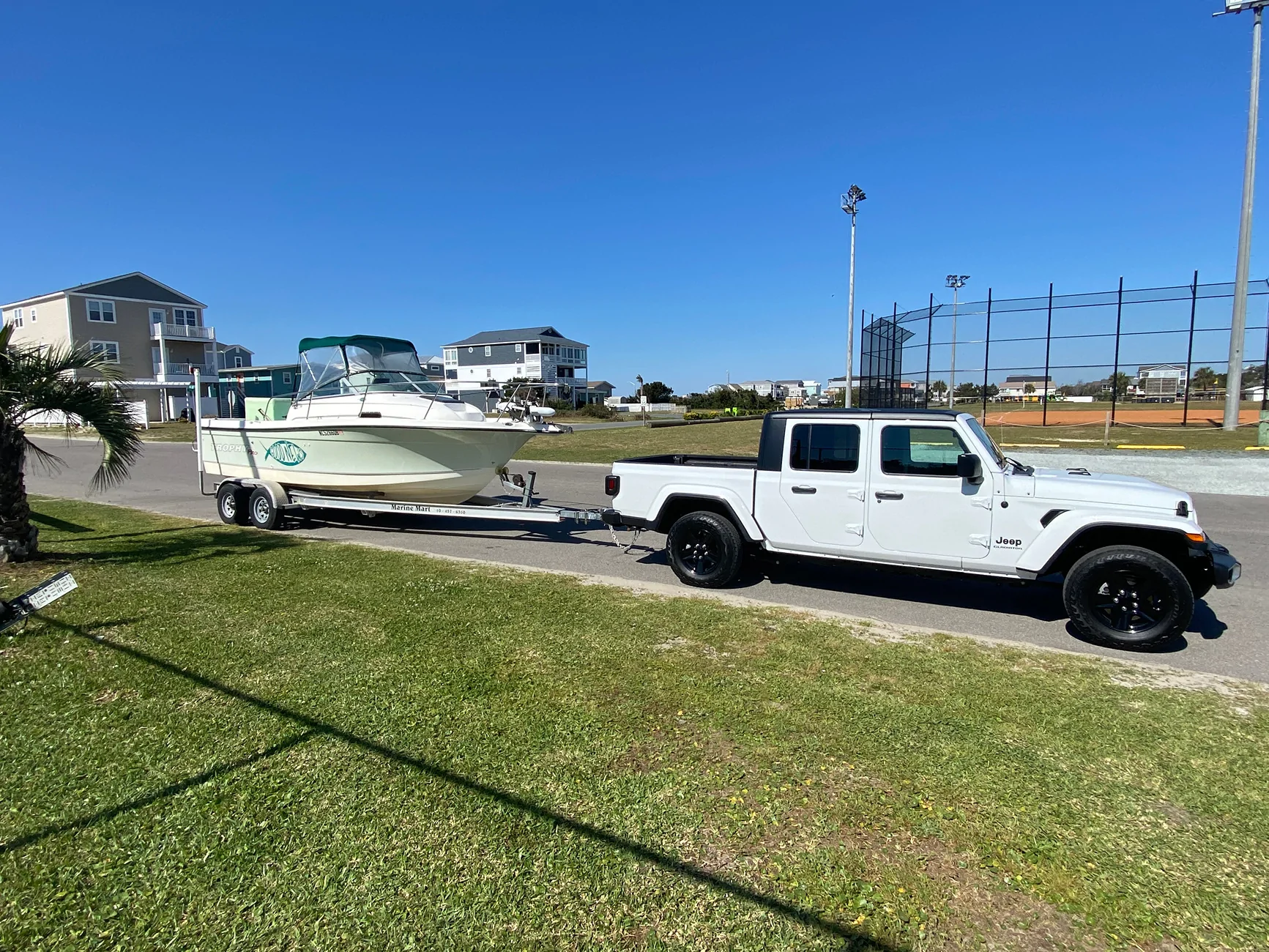

22' walk around. I figure 5-6k fulled loaded. No problems but it's flat around here and the ramps are in good shape. '21 Max Tow.
That's exactly what I was looking for,awesome!, Thx.

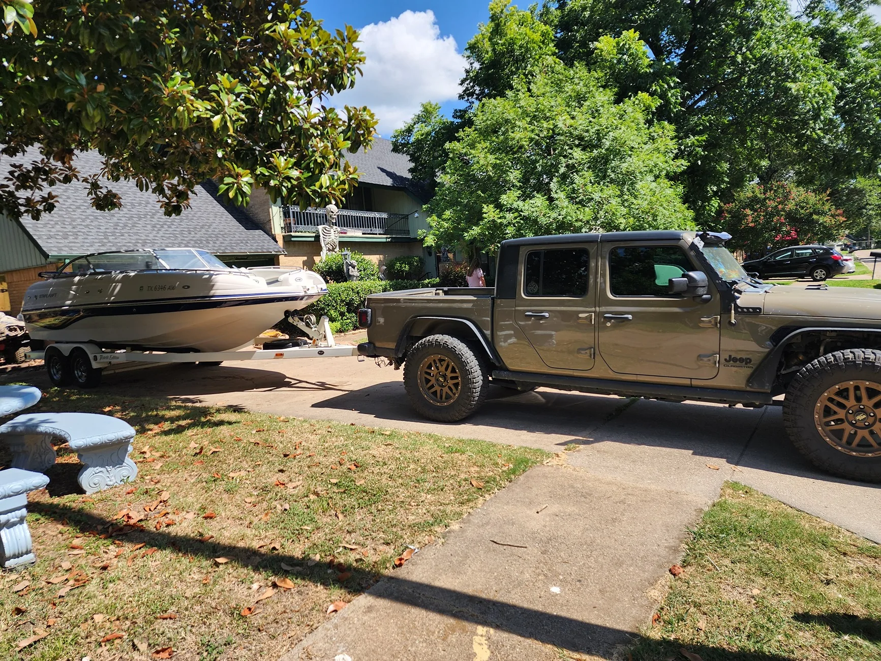

I have a 2020 Max tow and pull my boat around Texas. It is 23 ft long and maybe 4500lbs and boat ramps are not a issue.
