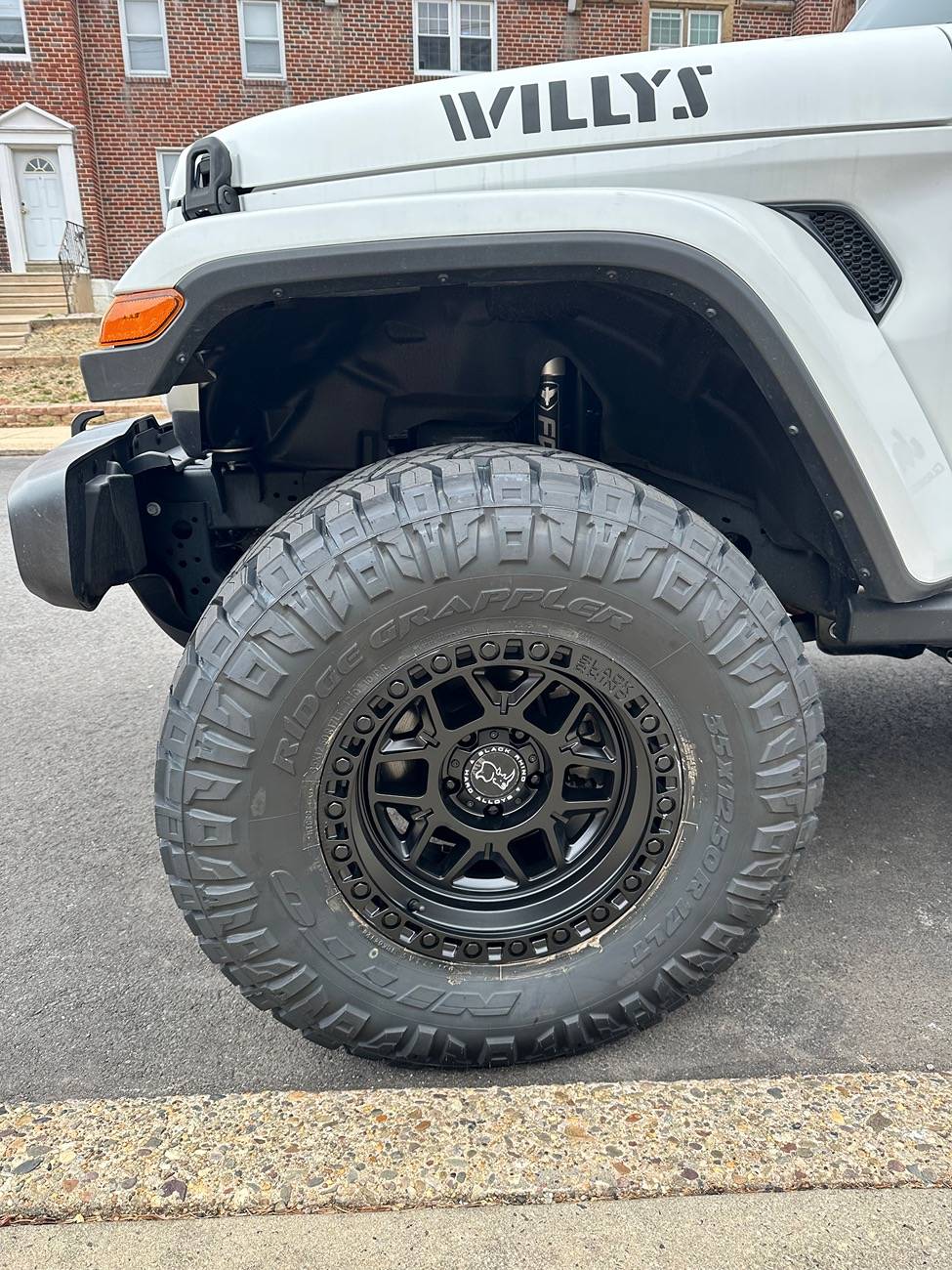

2024 Willy’s Gladiator. Just had installed and now sits higher on driver side and raked rear still. Maybe I assumed this system would make everything sit even ??? Checked springs, all seated correctly. Everything final tightened on ground. Only put @ 100 miles on it so far but feel it should be sitting a lot more even and not raked + driver side higher. I have read issues with spring rates oem vs aftermarket and how oem springs account for fuel tank weight and such. Going to check spring part numbers next to make sure they’re not backwards somehow. Love the feel and ride ( way better then stick ) but esthetically it’s driving me nuts. See some running an additional 3.4” front spacer to level the rake but what about the driver side higher ? Can I run a 3/4 spacer w an additional 1/4” passenger side shim ? Not huge wheeler but want things even and safe. Thoughts suggestions ? @Clayton Off Road any input or advice ? This is the 2.5 ride right kit paired with Falcon monotube shocks.

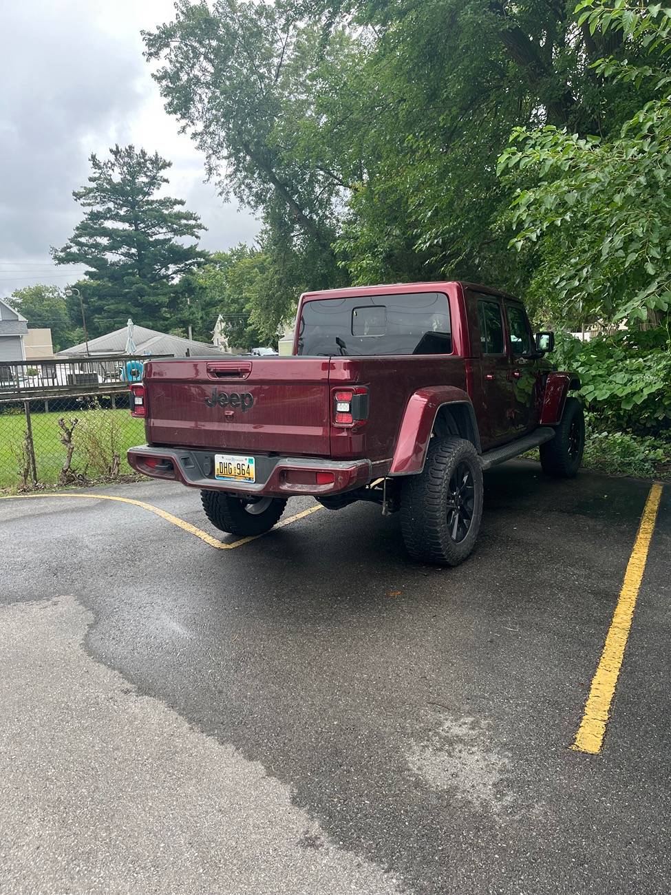

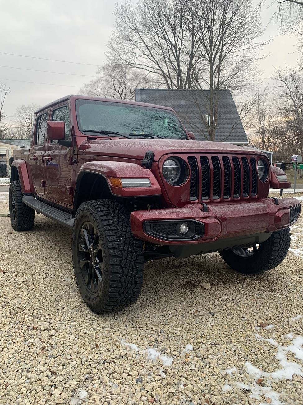

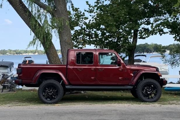

I have a Clayton 2.5” Ride Right and it sits almost level front to rear.
Jeep Gladiator Clayton 2.5 rr system uneven ?? IMG_4243
Jeep Gladiator Clayton 2.5 rr system uneven ?? IMG_0512
Jeep Gladiator Clayton 2.5 rr system uneven ?? IMG_4617

Yea was worried about the shimming passenger side part. I ordered the daystar 3/4” spacers for front. Hoping to install soon when I have time 🤦‍♂️🤦‍♂️ wife and kids like to ruin that for me. Still need to order the 5th wheel n tire ( that will help w some rear weight since stocker still under there )
