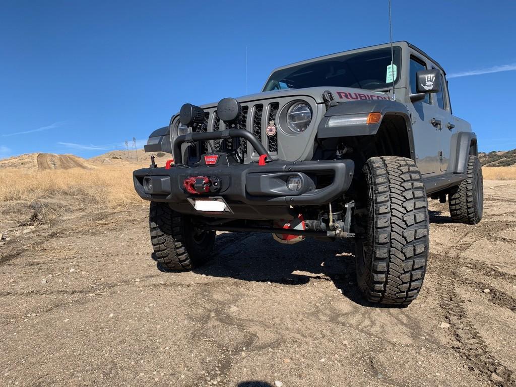

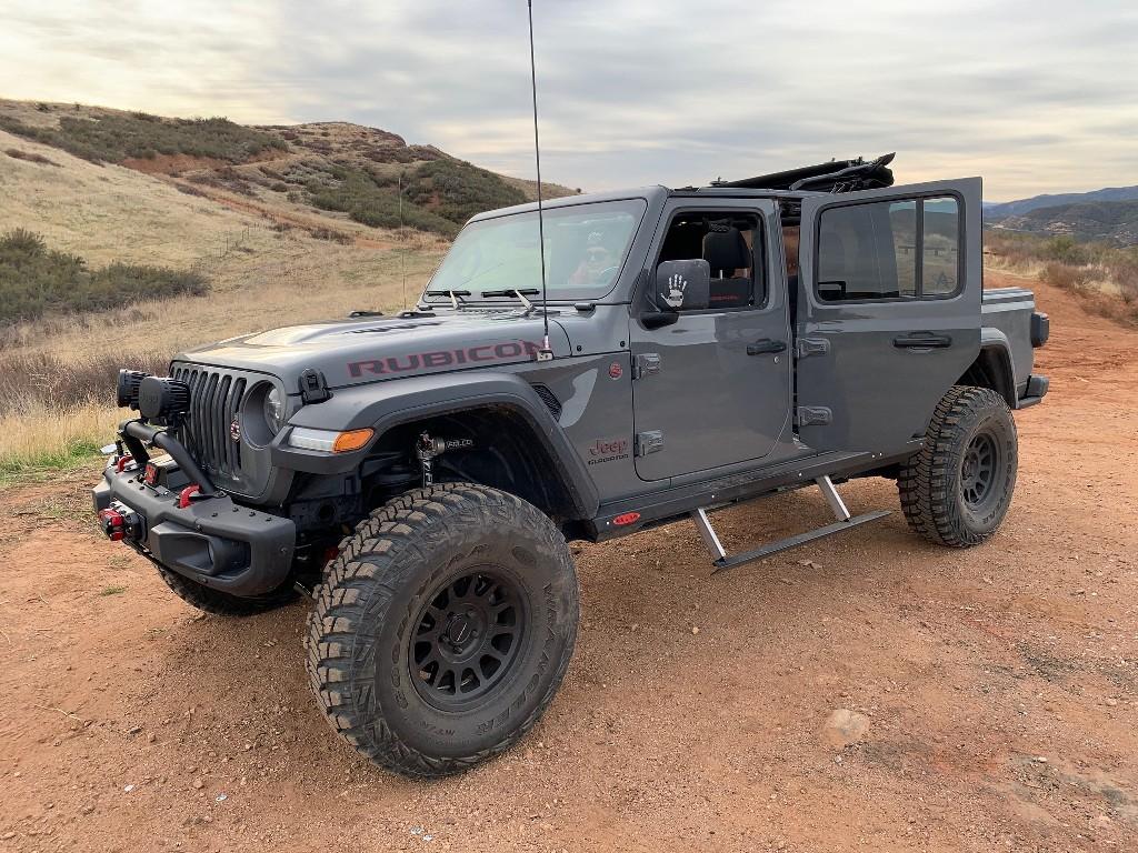

Thanks ! Goodyear MTR Kevlar - 37x12.5x17. They are a big 37, true to size. They will not fit in between the frame rails of the spare tire location -- even if they clear the track bar. I have a Patagonia MTR as a spare, same size, but, it is 1/2" or more shorter. Wheels are Method 703 "bead grip" in zero offset. Tires stick out about "1/2 a lug" from the rear fender on the Goodyear MTR. No rock/mud slinging on the body with the RSE sliders there.

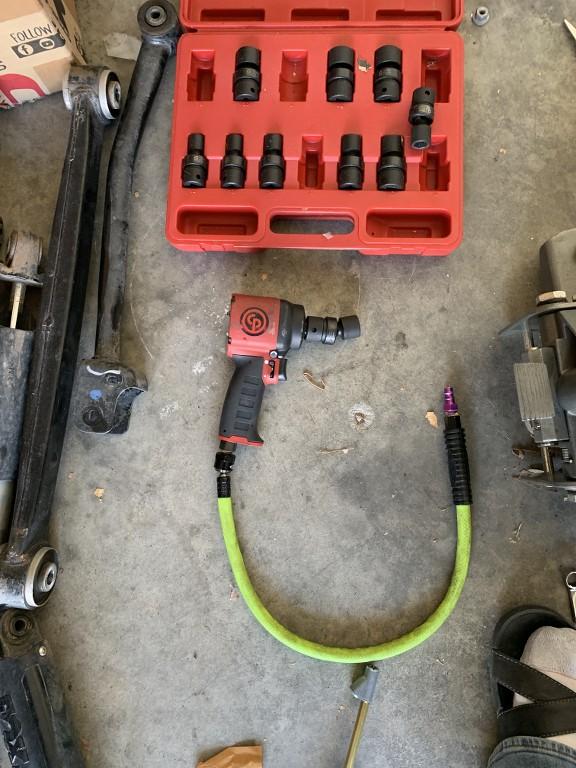

5. My mini 1/2" impact with the impact swivels - 18mm, 21mm, 24mm was used for almost everything - for sure all the control arms. This made it a ton easier. I attached a pic.

The Rock Slide Engineering Sliders are fantastic. My girlfriend says they are the best mod. The are great for keeping the paint clean. With the big height now, they also offer a nice platform to walk on to work on the top of the Jeep and it is an easy quick step to the rear tire to get in the bed. I have the armor for them too. They are exceptionally well engineered and they fit perfect. There are a lot of things to do for the installation, so, plan a few days. Unfortunately, they are very expensive and very heavy, but, that is the only negative.

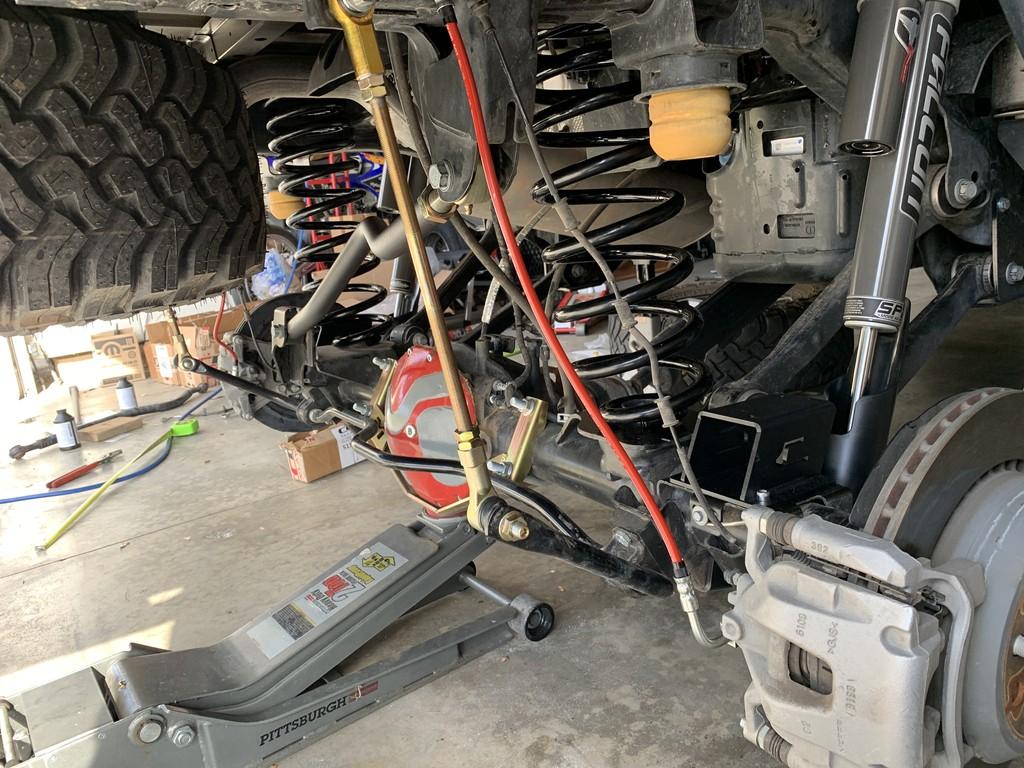

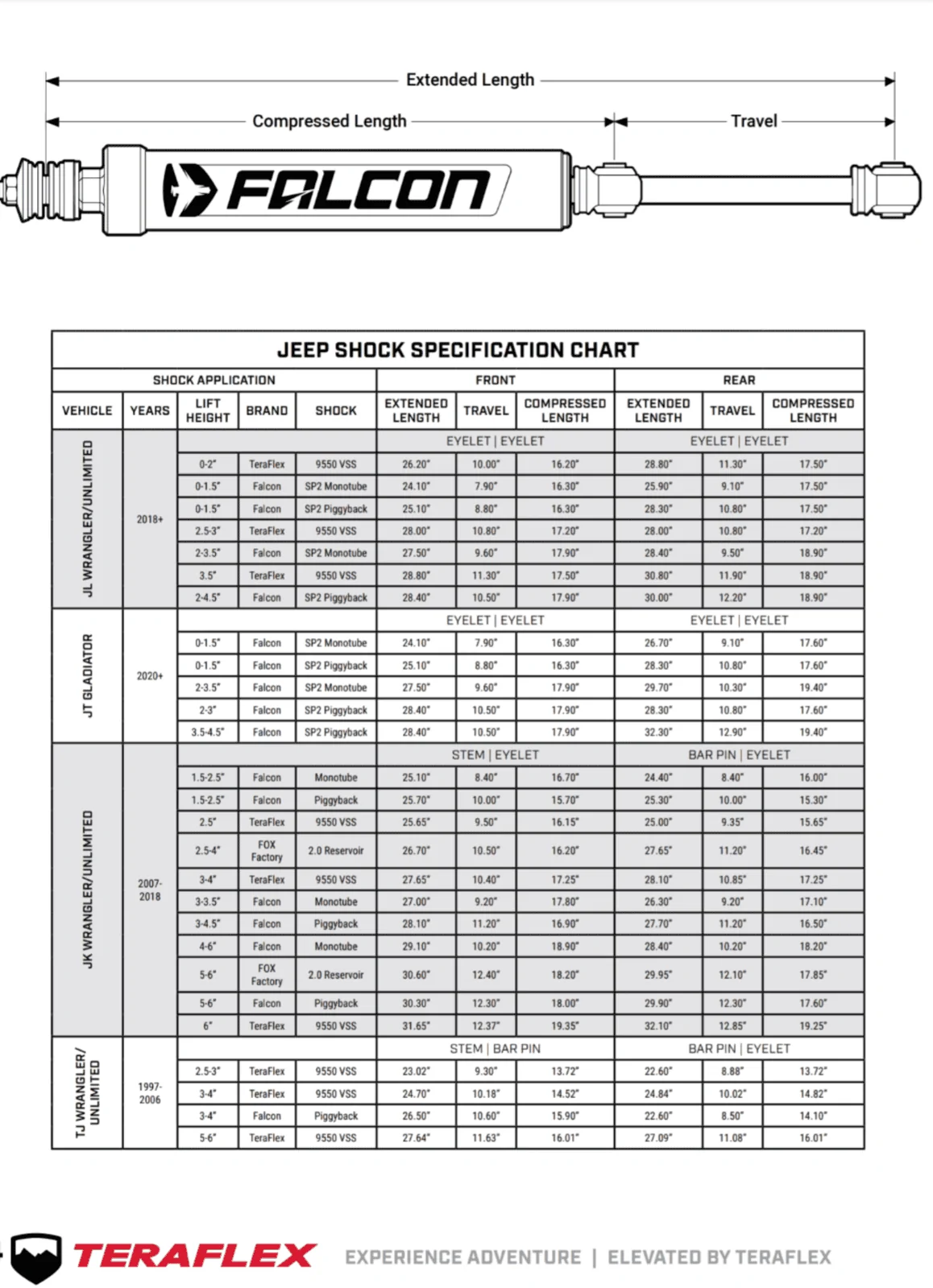

Brake lines - yes. Shock Length determines this, and the Falcon SP2 3.3 adjustable rear that I bought is long. Take a look at this shock chart, it is whopping 32.30 inches long. So, I needed the extra brake lines. The Falcon SP2 mono tube is 2.5 inches shorter, so, you may not need the extra brake lines for that shock.
Regarding front drive shaft, I changed it because it was recommended. I did not try running the stock front driveshaft off road.
Jeep Gladiator Clayton Off Road JT Suspension Systems 1613055143594
Here you can see that even the red extended brake lines are at their limit when the rear shocks are fully extended. I also needed to pull some frame mounting tabs off the wheel sensor wires to extend them.
