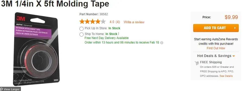

My lights I bought from the above eBay auction came with two strips but they stuck to the paper and were useless. I used a clear gorilla tape that was double sided and just cut it to thickness and stick it on the same spot as the old lights.
I used this tape. Looks identical to the original. My local Autozone stocked it.
Jeep Gladiator Completed halogen to led install on it rubicon Annotation 2020-02-17 075321
