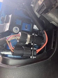

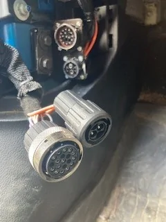

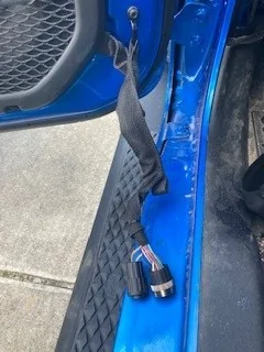

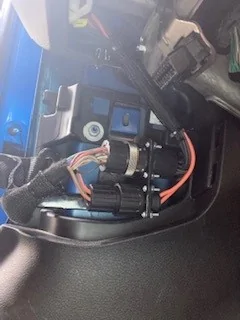

I took the step and converted mine to these two cylindrical plugs that use round (much stronger) pins and sockets. I wanted to do it with one plug but I couldn't source one that would fit under the cover and accommodate the two different size gauges required. There are actually four gauge sizes used in the OEM plug but 3 of them are 20, 24 & 28 gauge. These can all safely go in the 16ga sockets of the larger, 19 pin round connector (this number accommodates all options according the door plug maps except for the two window wires). The two for the power windows are 12ga so they had to be put in the separate, smaller 4 pin connector (only two cavities used). Both of the new round connectors they are bayonet-style quick twist connectors. I can do them with one hand and can just "feel" for the aligning keyslot when connecting them so I don't have to contort my body to connect-disconnect them

Agreed! The one I made is a pigtail on the truck body side(i.e. one end plugs into the oem connector and the other has the two cylindrical pugs mounted on a custom made bracket bolted under the strain relief bracket hook. The door end I just went ahead and crimped on new terminals for the new cylindrical connectors. A pigtail on the door side seems like it would be bulky,
