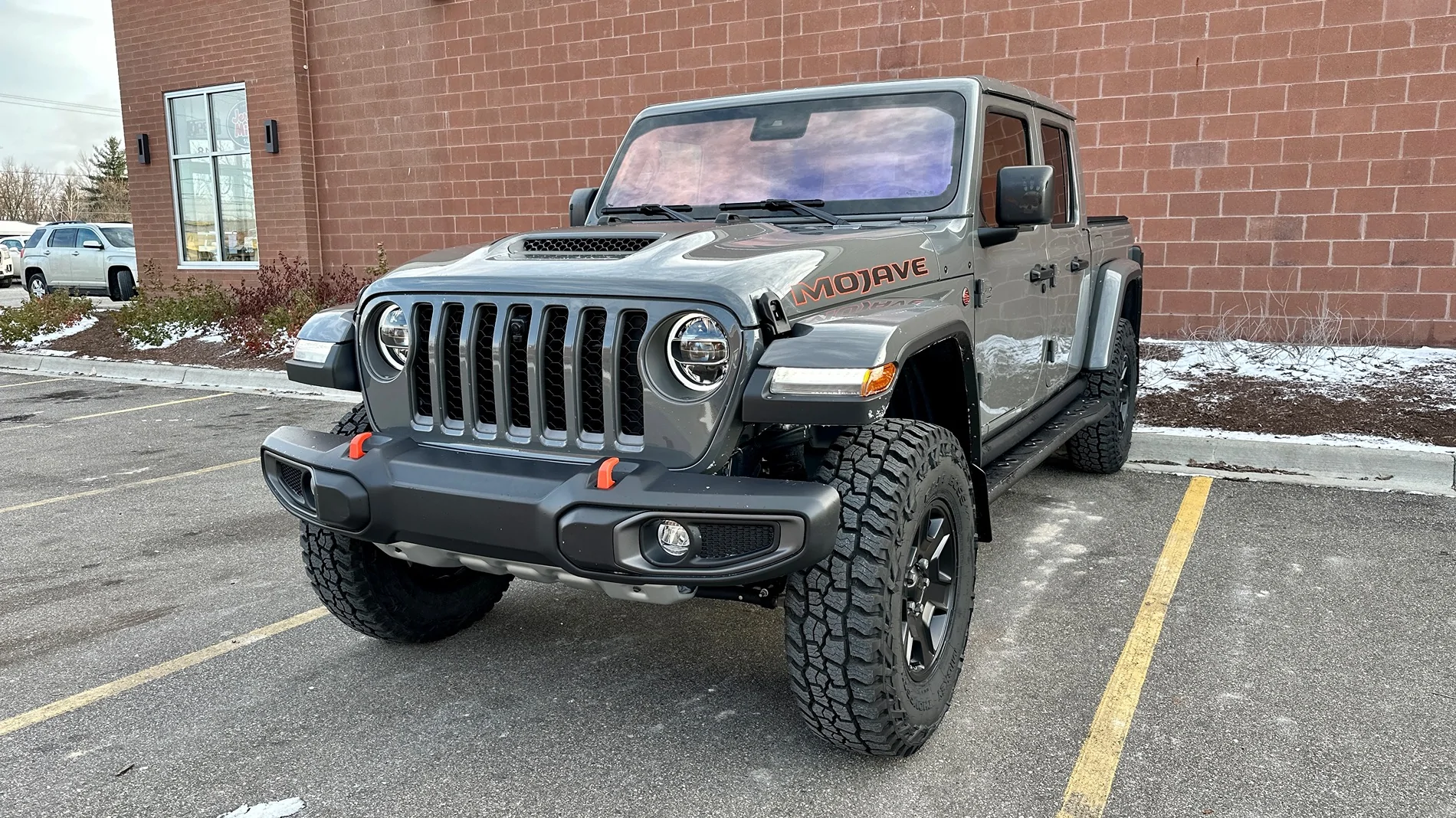

@OffAxis2021 can you go into more detail about your setup? I have a 2023 Mojave and want these exact same tires. I hope to put them on my stock wheels with no lift. I also hope I don't have to run spacers.
You will be absolutely fine without any lift and on OEM wheels without wheel spacers.
Two months after new Jeep purchase, I had an AEV 2” (f/r) lift and GCBs installed (top hole utilized). Was NOT at all necessary, but I wanted to. No other component modifications and it drives 100% as expected. Smooth AF.
Pictured with above mentioned AEV lift, OEM wheels and 1.5” wheel spacers, but again… NOT at all necessary. Wheel spacers simply for aesthetic (tire poke).
2 months after new Jeep purchase, I had an AEV 2” (f/r) lift and GBCs installed (top hole utilized). Was NOT at all necessary, but I wanted to. No other component modifications and it drives 100% as expected. Smooth AF.
Pictured with above mentioned AEV & 1.5” wheel spacers, but again… NOT at all necessary. Wheel spacers simply for aesthetic (tire poke).
Thanks, I really appreciate it!
You’re welcome. I did edit the fact that I do run OEM Mojave wheels with said 1.5” wheel spacers to achieve the aesthetic I was looking for. Tires were just a little too tucked for my personal liking. Actually… I have a picture. OEM wheels. No wheel spacers. Post AEV install. Not a great photo, but limited.

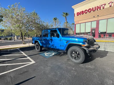

I went to the 255s in AT3W shortly after getting my '22 Mojave and have been happy with them.
