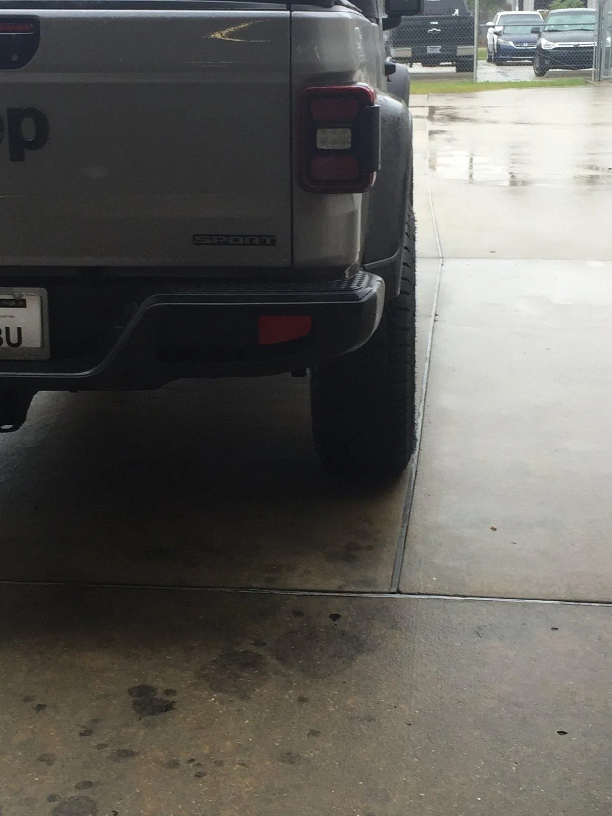

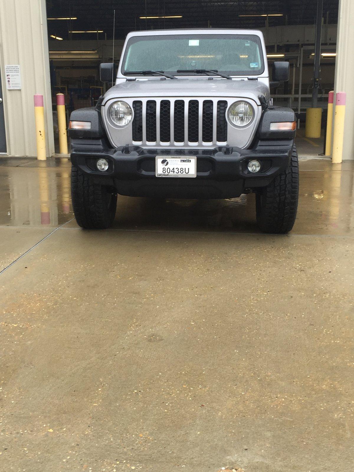

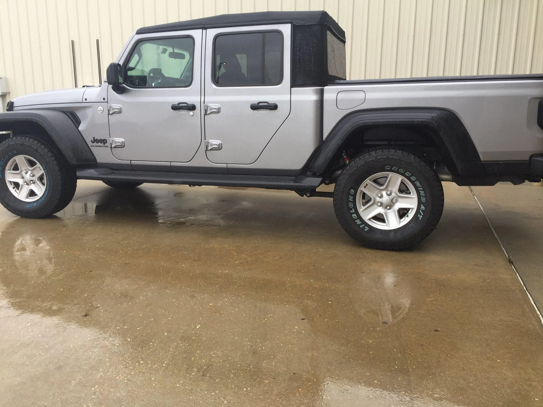

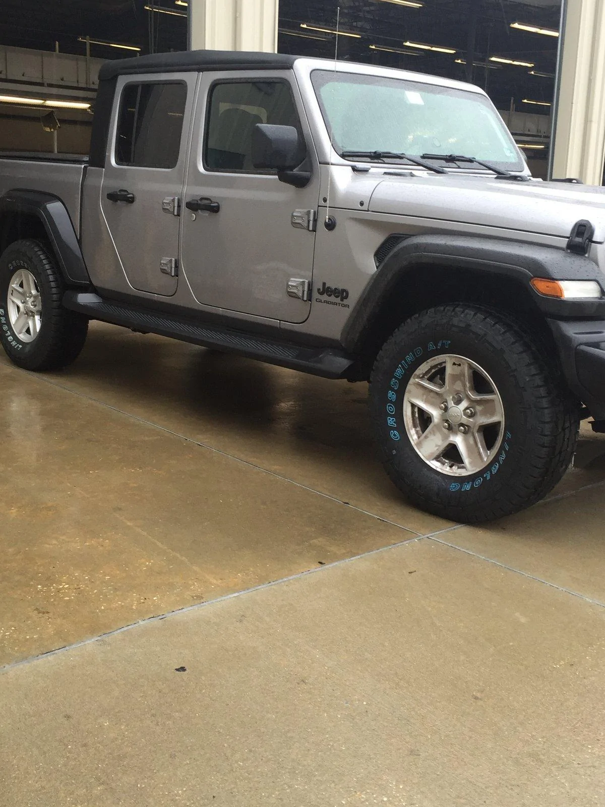

I’m getting my 305/70/17 A/T’s mounted tomorrow on my Sport S / no lift other than Rubi takeoff suspension and shocks.
Lookin at a rubi take off myself. Did you end up with a height increase vs stock Sport S? Any downsides if you like the Sport S suspension already after the switch?
