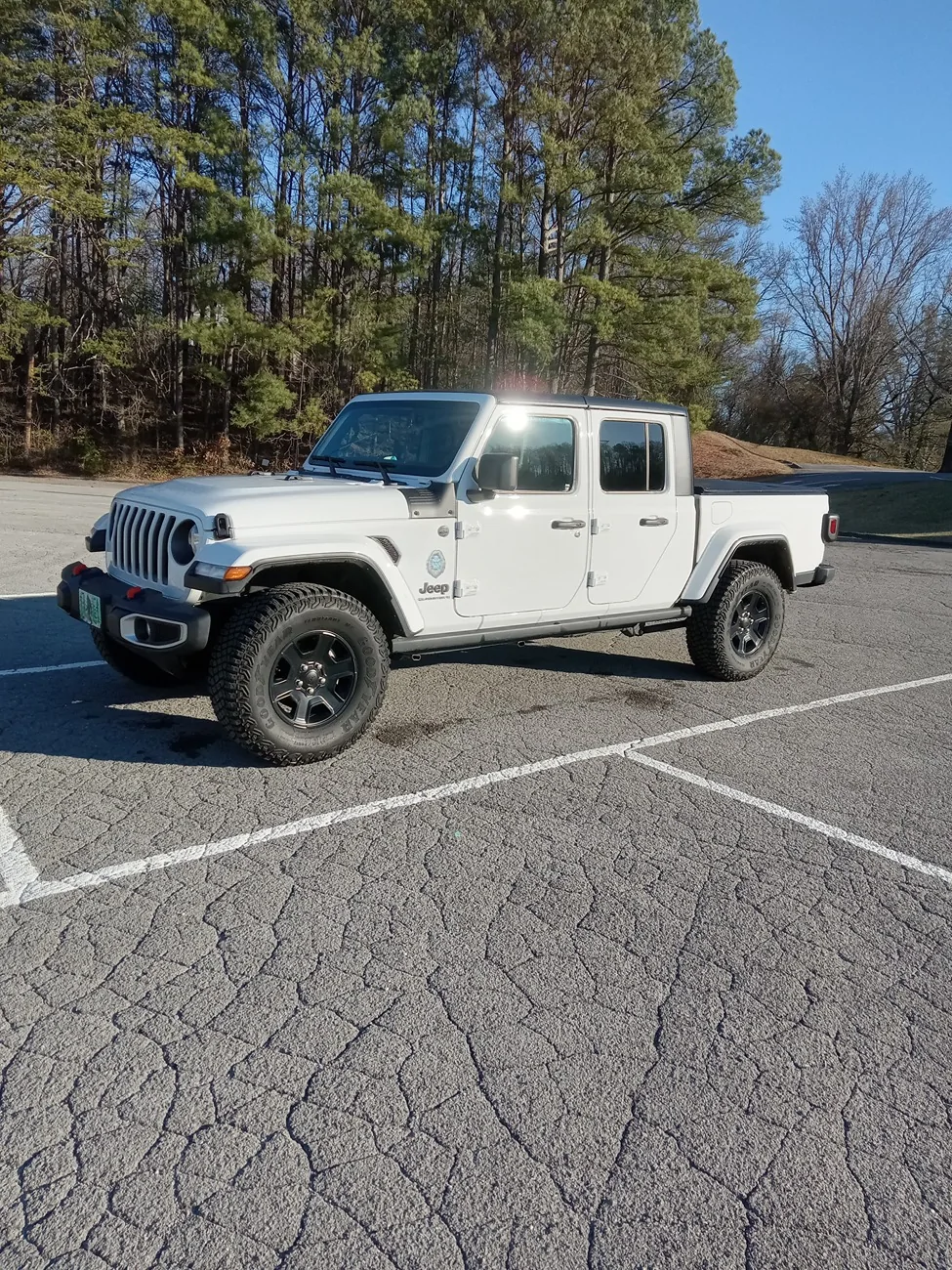

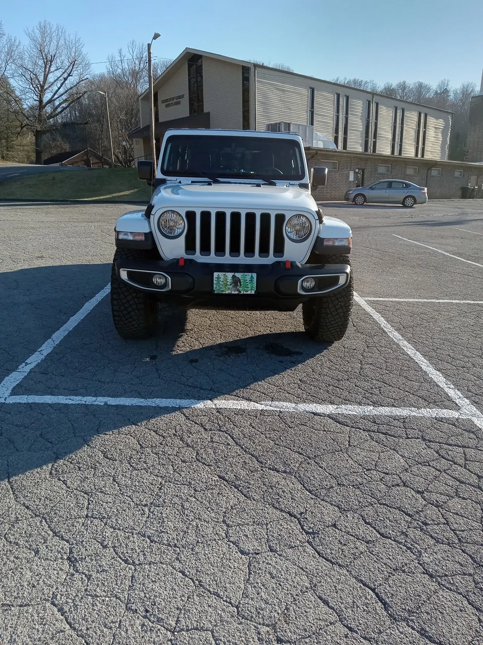

315/70R17 on a previous Gladiator that I had were 34.4". I had 1.5 level on front. Worked well for me. I did have 4.10 gears though.

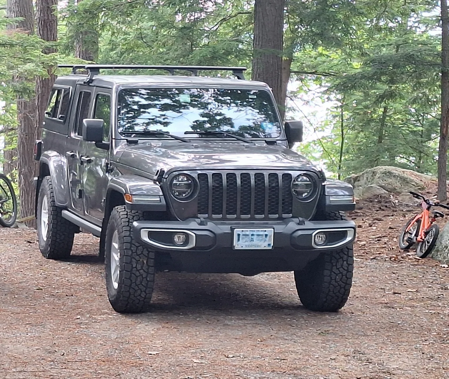

NHJeep4x4
Sep 6, 2023
54
New Hampshire
2022 JT Sport S Ecodiesel, 1987 YJ

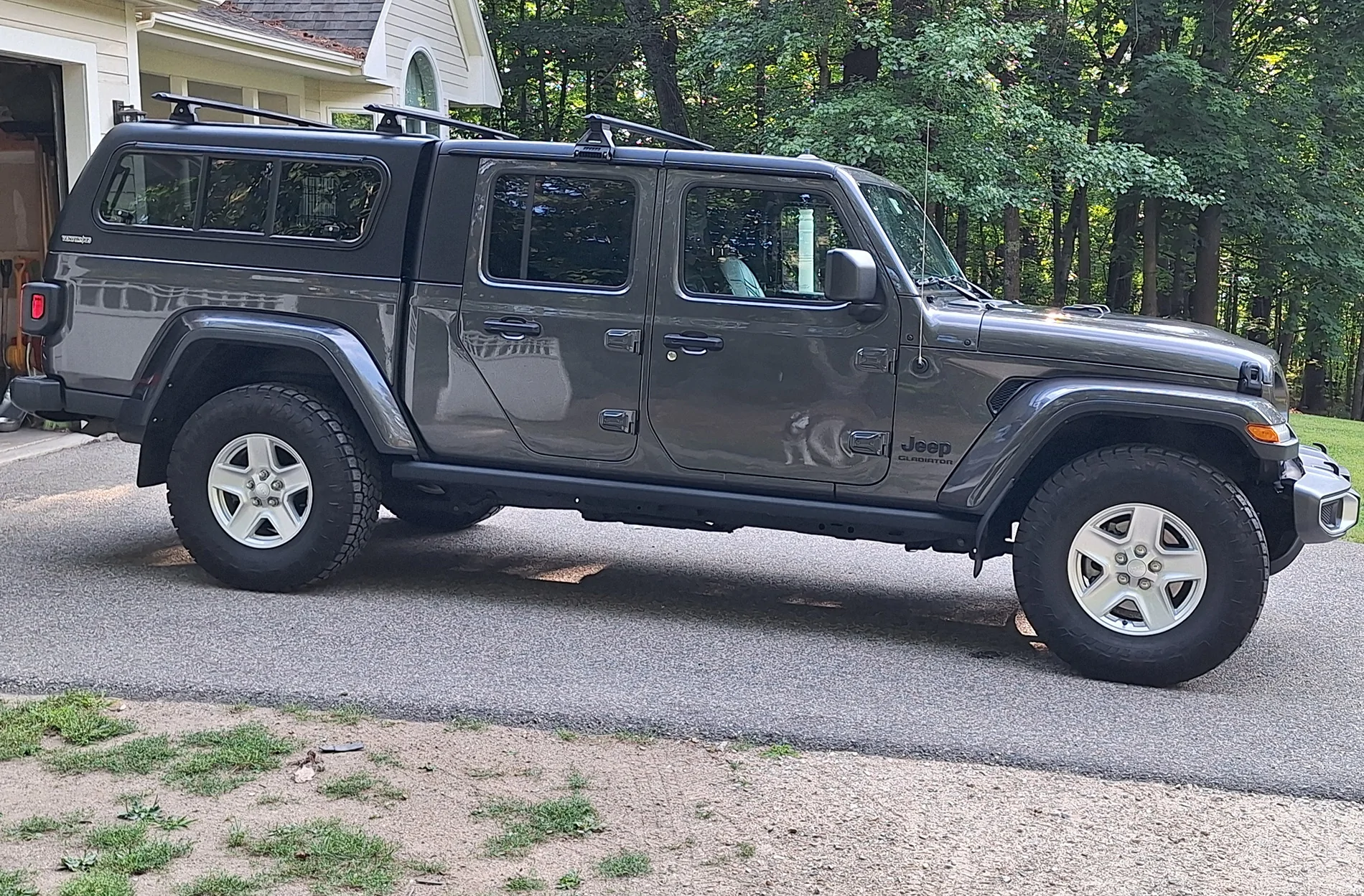

I have Toyo Open Country AT3s 35x11.5R17, load range C, and I really like them. They measured 33 5/8" tall mounted with vehicle weight when new and are about 10 1/2 or 11" wide overall as I recall. The narrower profile does not rub anything using the stock wheels on the narrower Sport S axles, and they stay neatly tucked under the flares. I did use a 1" front coil spring spacer and 3/4" rear. The front rubbed slightly offroad under articulation once or twice. I did not regear from 3.73, but I have a diesel, and the power loss is not substantial. The computer is re-calibrated using the AEV ProCal Snap. I lost a mpg or two, but not terrible, and they do grip much better than the factory highway tires so some added drag there. I have probably close to 20k miles on them with no signs of uneven wear, and they appear to have worn very little (no actual measurements taken).
I also just do the occasional simple trail, and these are great for that. I have found on road traction to be good in wet or snowy conditions, and they are not very loud on the highway with dry pavement.
I would also advise against load range E tires. I had those on a Tacoma, and the ride was much worse.

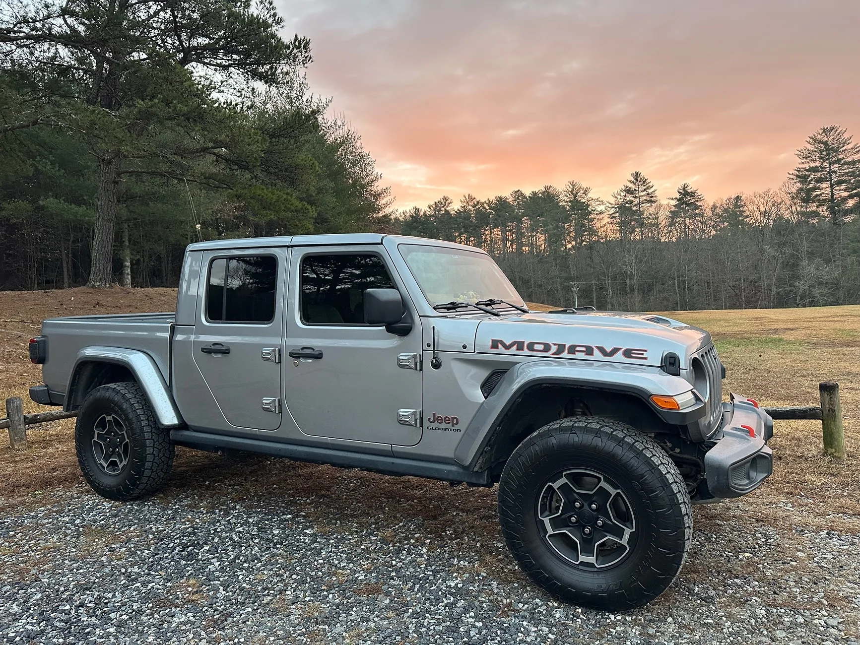

Harleync
Jun 9, 2024
63
North Carolina
2024 Gladiator Willys

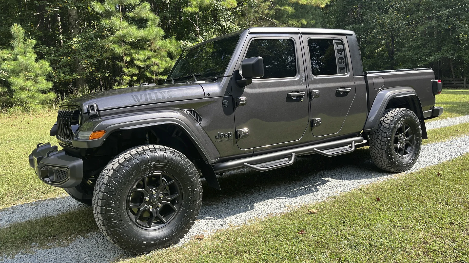

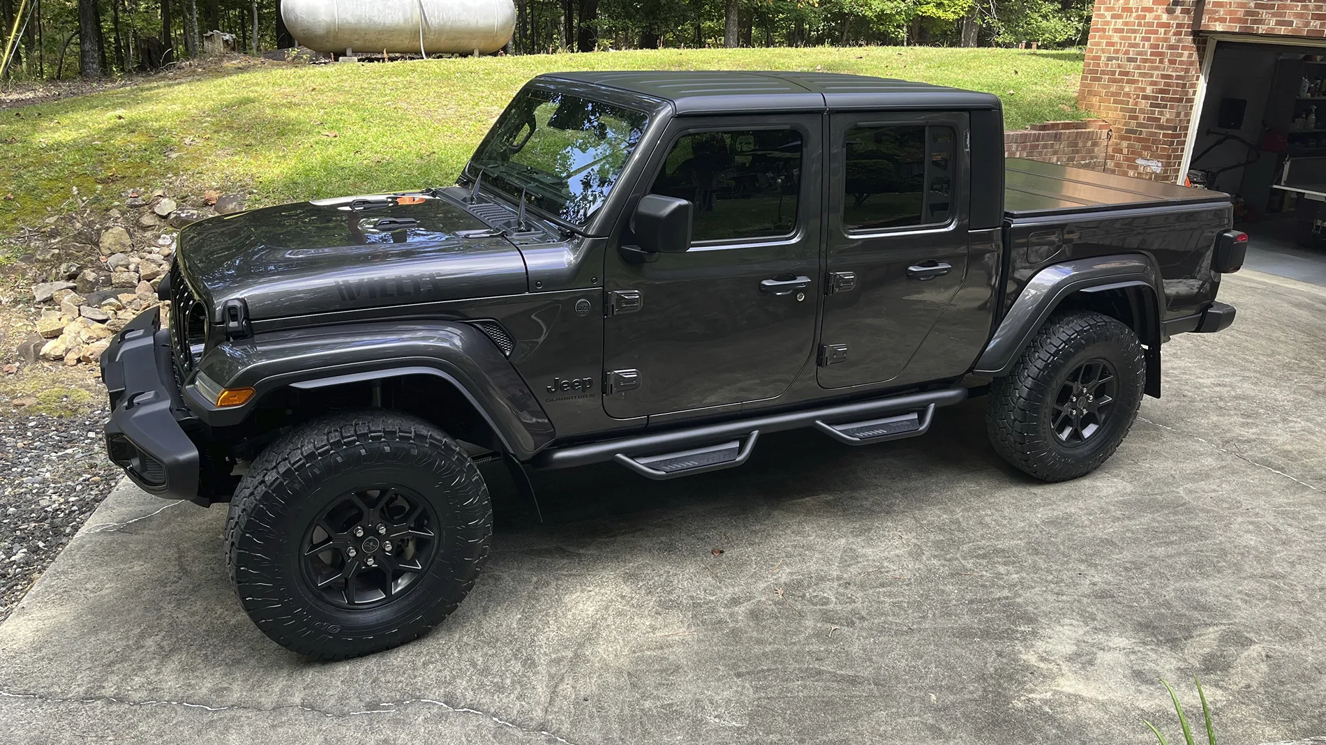

I also am running Toyo AT3 35/11.5/17 on factory wheels and 2.5 lift but had to install 1.75 wheel spacers because I hitting the lower control arms. I went with the 11.5 width because lighter weight, better gas mileage and was hoping that they would not rub. Instead of buying new wheels I had 1.75 spacers installed. I do have about 2 inches of wheel poke. Most of my miles are Hwy so this set up works for me. I changed the speedo with Jscan and getting around 18 to 19 mpg all around driving. And hitting 8th gear easy with this set up.

Which Teraflex 2.5" lift are you running?
Harleync
Jun 9, 2024
63
North Carolina

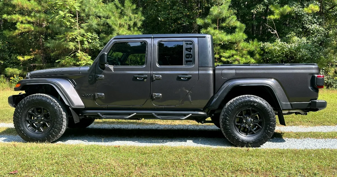

Teraflex ST2 Sport. I also added with the lift Adjustable lower control arms, Bilstein shocks and adjustable track bar. It rides smooth as butter going down the road. This lift is for people that drive on the HWY and occasionally hit the trail. More for looks instead of offroad. Idea of how high 40 inches from the ground to top of the fender extension in the front, rear is the same.

2022 JT Sport Max Tow
Thanks. I had a Metalcloak 2.5" lift on my 2016 JK 2 door. I may eventually do something on my truck, but the offroading I plan to do in it won't be as rough as what i did in the last Jeep.
Your truck looks great btw. Saving it for reference later.
