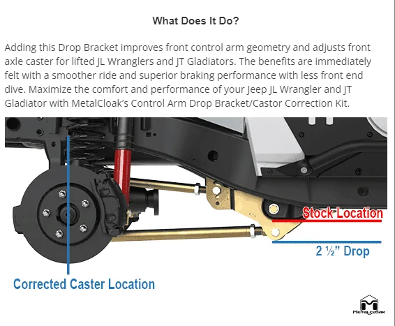

IMHO, I am choosing to go with drop brackets instead of longer arms, to keep them more parallel with the ground. Im going with metalcloak personally, they have a good demonstration on their page .
Jeep Gladiator Control arm question 1660751194256
No, I am not affiliated and I paid full price for the brackets..
