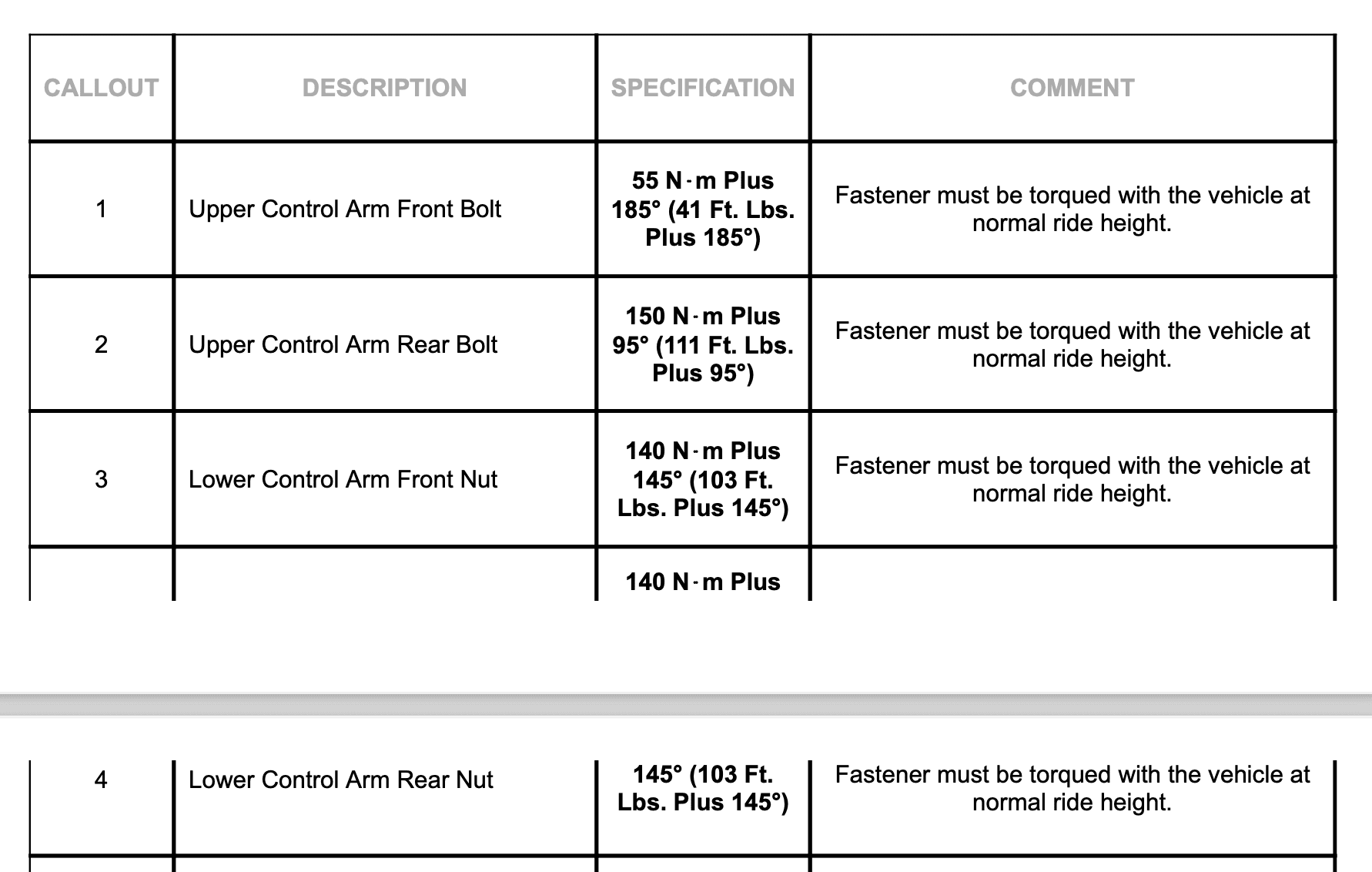

If it hasn't been mentioned already, the impact is very handy for the final torque on the LCA bolts. The factory specs are torque + degrees. Below are the specs from the 2023 service manual. It is a whole lot easier to torque to these lower numbers then use the impact to turn it the additional degrees. Plus you don't need a high-torque torque wrench.

That is what I did yesterday. Torqued all 4 LCA bolts to 103 ft. lbs, then marked 145 degrees. For some reason, my DeWalt DCF899H wouldn't move them to the mark, it got them to about 110-120 degrees. I then tried to move them with a 36 inch breaker bar, they did not budge, so I said good enough, marked the bolts and nuts, and will review in 30 days for any movement. I see these specs call for the torque on the nut, not the bolt. Hmmm....
EDIT:
The factory LCA bolt heads are 13/16 or 21mm, the nuts are 15/16 or 24mm. I was always taught to apply the torque to the bolt head and hold the nut when the bolt head is smaller than the nut diameter. So I wonder why the TechAuthority says to apply the torque on the nuts for the LCA's?
