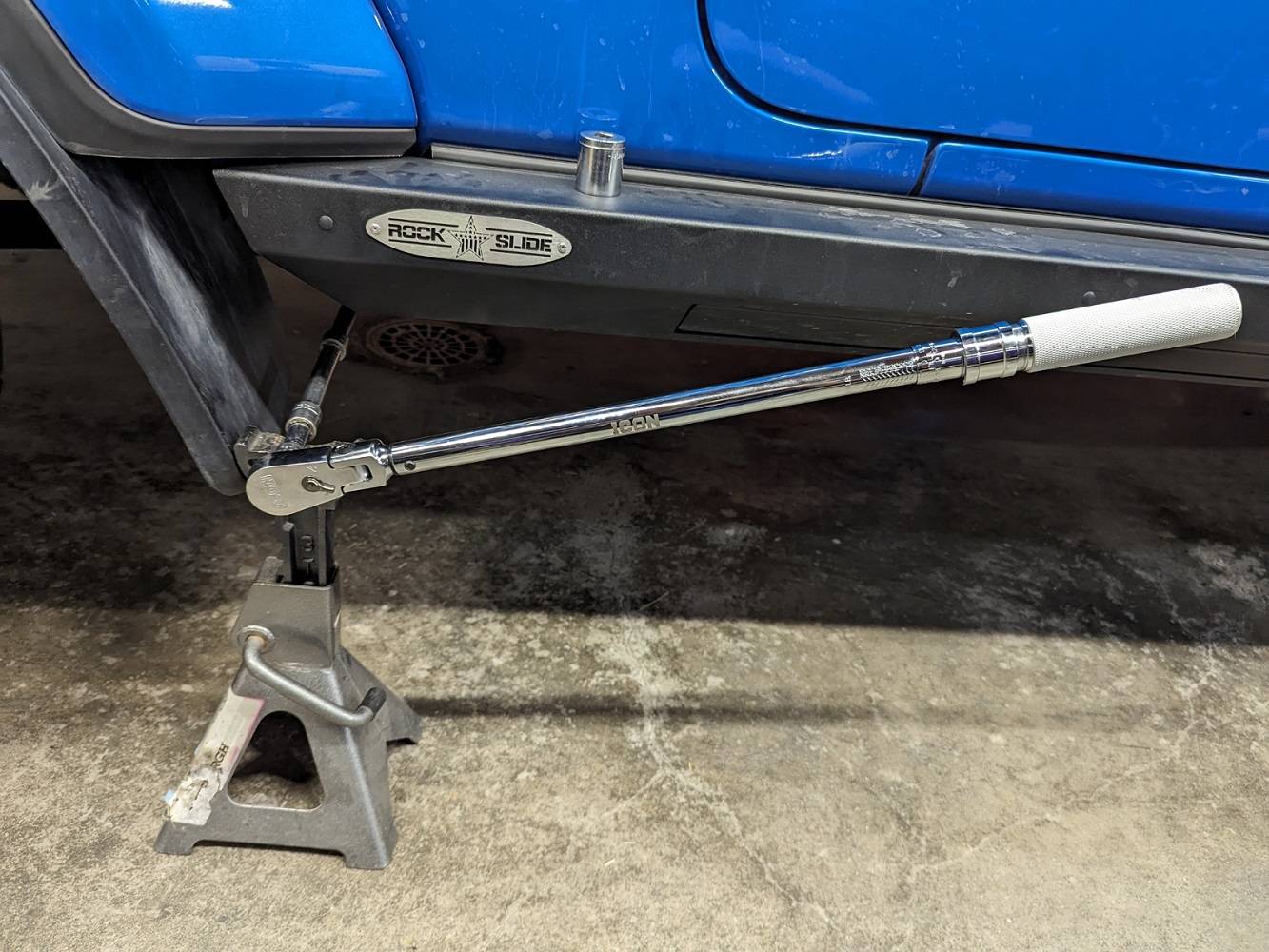

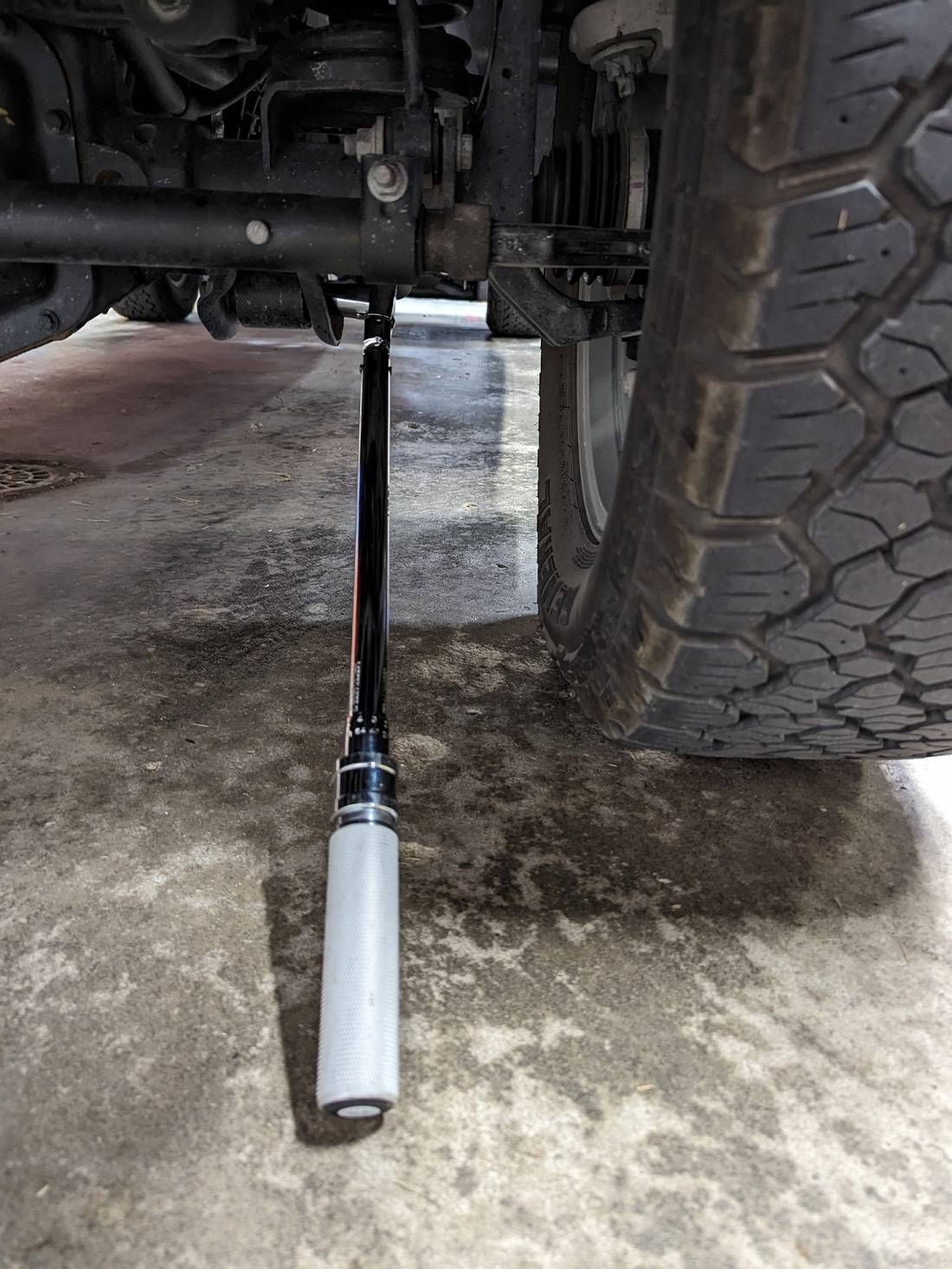

Without a lift I am never able to get the leverage I need to torque past 120lbs with my torque wrench. I wish I could fond a 190lbs, but 170lbs was the closest I could find...
The lowers are easily done from outside of the vehicle, not under it.
Uppers, that's a different story.........

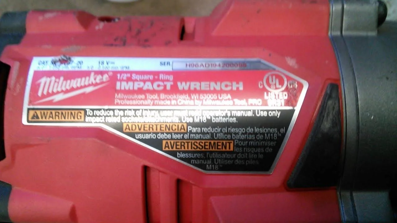

My impact (besides the multiple air type)
