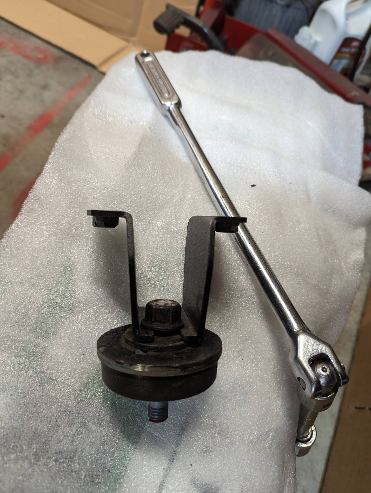

Be careful - I broke a BODY BOLT with this - not even 18" long (I think I measured it at 15")
Jeep Gladiator Control Arm Bolts PXL_20230324_010326126
