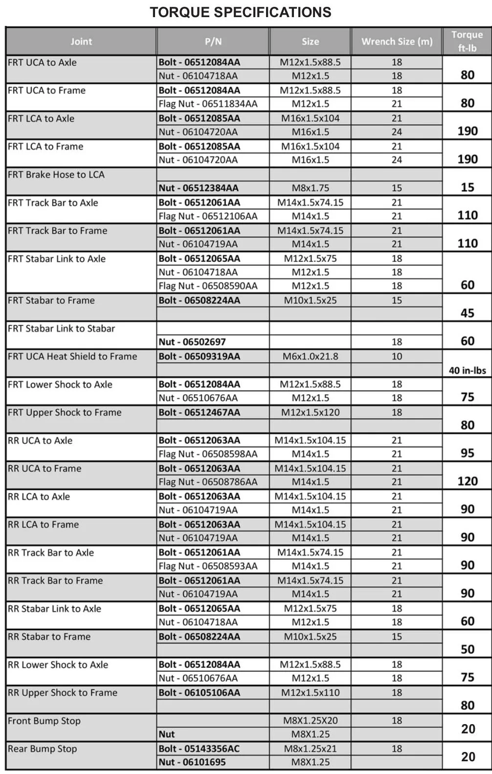

Factory ends up a bit over 200.
I had no problem with quality sockets and a bar, but eventually started using my Milwaukee cordless impact to loosen things.
You do need some serious leverage to get to FACTORY torque plus degrees on them.
