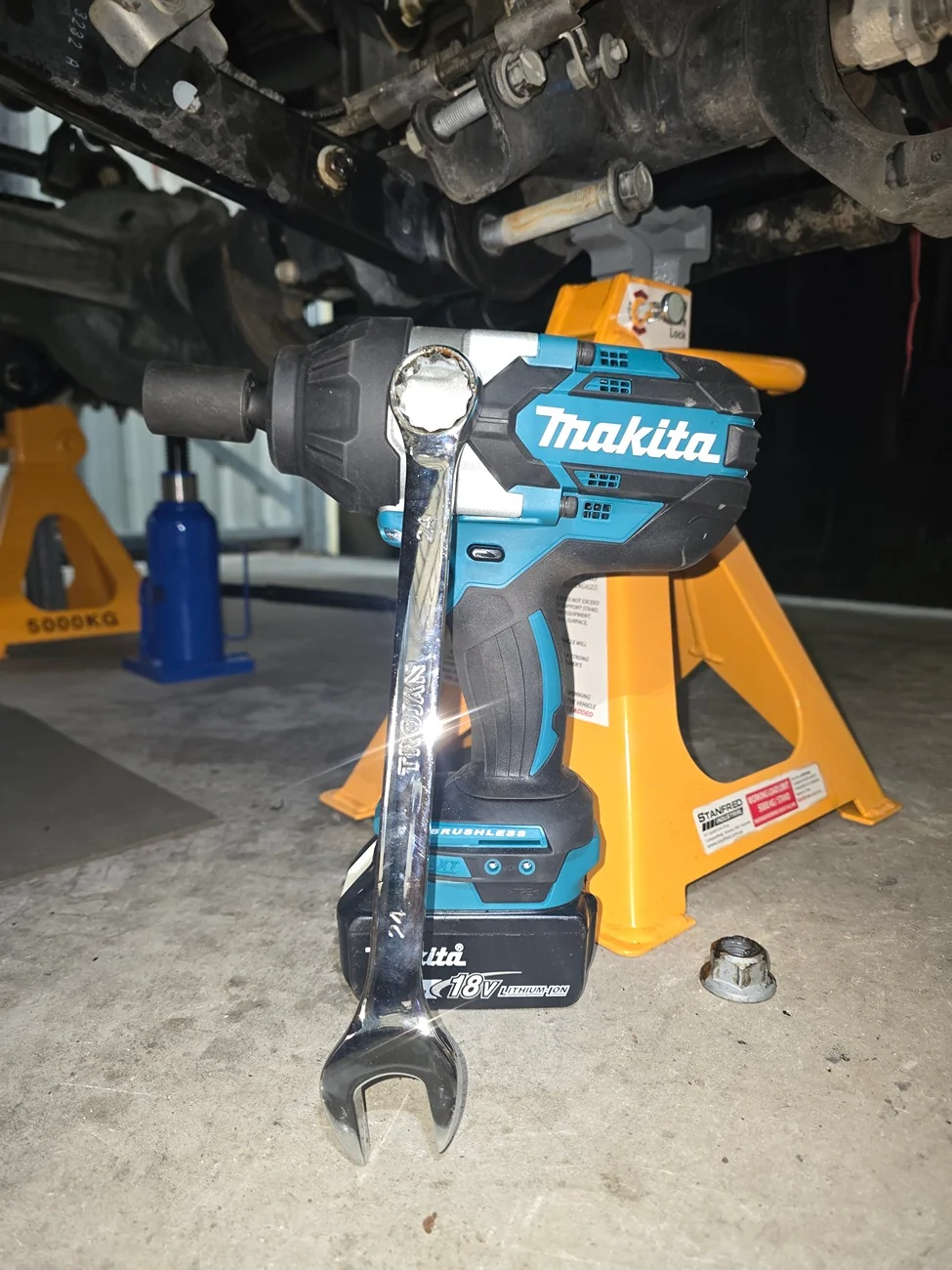

This beauty did the trick.
Makita DTW1002Z, very similar power to the Ryobi mentioned elsewhere in the thread. It made quick work of the bolts and managed it all on medium when using B'laster PB. Definitely a worthwhile purchase.
