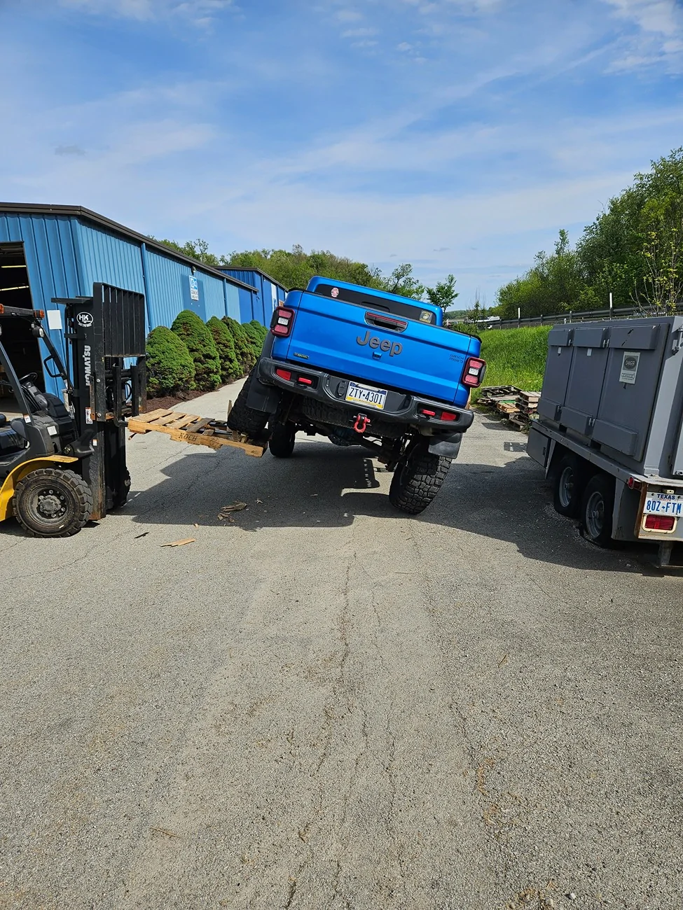

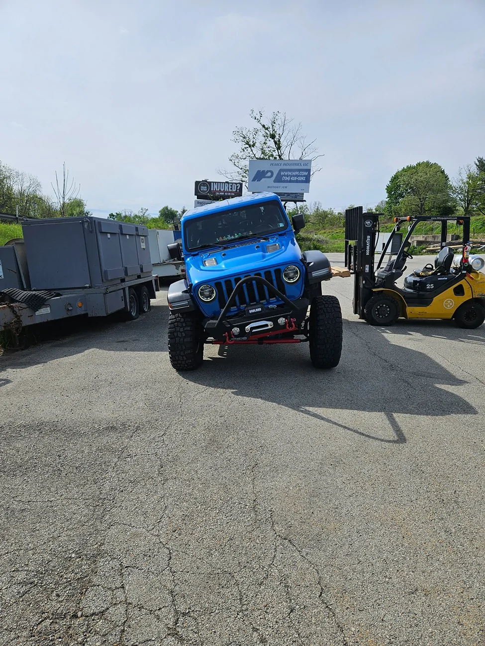

I have Core arms with the Johnny joints. Got the front upper and lower arms. Rear upper and lower arms. Front track bar. Rear track bar is a bent Clayton. Core doesn't make a bent rear track bar to clear 37" spare tire. Steering linkage is all Core. Keep the Johnny joints greased. They should last a long time. If you get them. Remove the ends and slop a lot of anti sieze inside the tube threads and on the adjuster threads. I've beat on mine a good bit. The powder coating is pretty tough. If you get the Johnny joint arms (Crawler), get Johnny joint tool. If you ever have to take them apart. Makes it a lot easier.

How is your flex with those arms and the Johnny joints?
