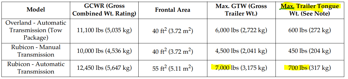

and........nobody mentioned frontal area. This makes a huge difference in these 'lack of torque' monsters.

The frontal area is a very under discussed consideration. With my current Tt im just a little shy of the max frontal area. It makes a difference for sure.
