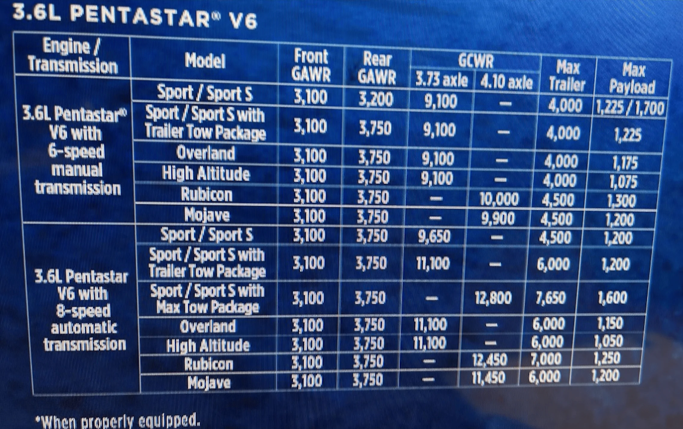

I can’t seem to find the official chart, but everything I’m finding on the forum says the rubicon is 7k with automatic, even without the factory package. Of course that assumes a class IV receiver. It seems that the rubicon is the only trim where capacity doesn’t vary depending on factory or added towing.
Here ya go

If you have an automatic, you’re likely at 6k towing capacity per the chart from @Elff above, unless I’m missing something about your overland. If your dry weight of the trailer is 2,900, what’s the GVWR for it?

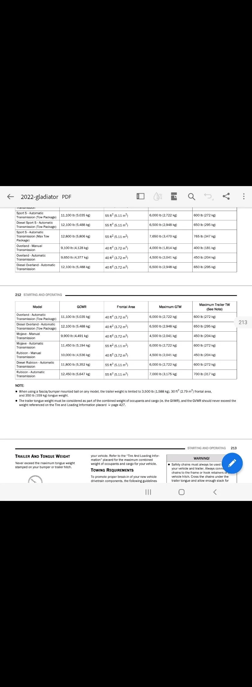

I got this information for the manual. My max towing is 4500 with the hitch
Jeep Gladiator Couple questions about JT towing. Screenshot_20220916-160952_Gallery

The OP didn't get the factory tow package, so his tow weight is the lower 4500 pounds.
What the chart DOESN'T say is that max towing weight is with a completely STOCK (as in factory options only) JT and a 160 pound driver. Every pound put into the cab and bed takes off of his payload which then in turn reduces his towing capability. Now you have to add weight of weight distribution hitch and anti sway setup.
It is NOT as easy as looking at a chart and saying you can tow X pounds. The JT is NOT an optimum tow vehicle.
It looks likely the chart has been updated. It’s only 4,000 if you had the manual tranny. Previous to this, I thought the lowest capacity of any trim/equipment was 4,500. If it were me, I’d avoid trailers weighing more than just over 3,000-3,500lbs, fully loaded. Anything in that range shouldn’t put you any any risk for being over tongue weight.
The only manuals with 4500 lbs of towing capacity are the Mojave and the Rubicon. The other trims are 4000. The Mojaves and Rubicon have 4.1 gearing.
My mistake. Thanks for the correction. Either way, 5,000 is way too much for an overland without factory towing in my opinion.
Yes, but I also don't think any Overland Manual ever had more than 4000 lbs. towing, so I was partially agreeing with you . If it did, it was a mistake in the book.
