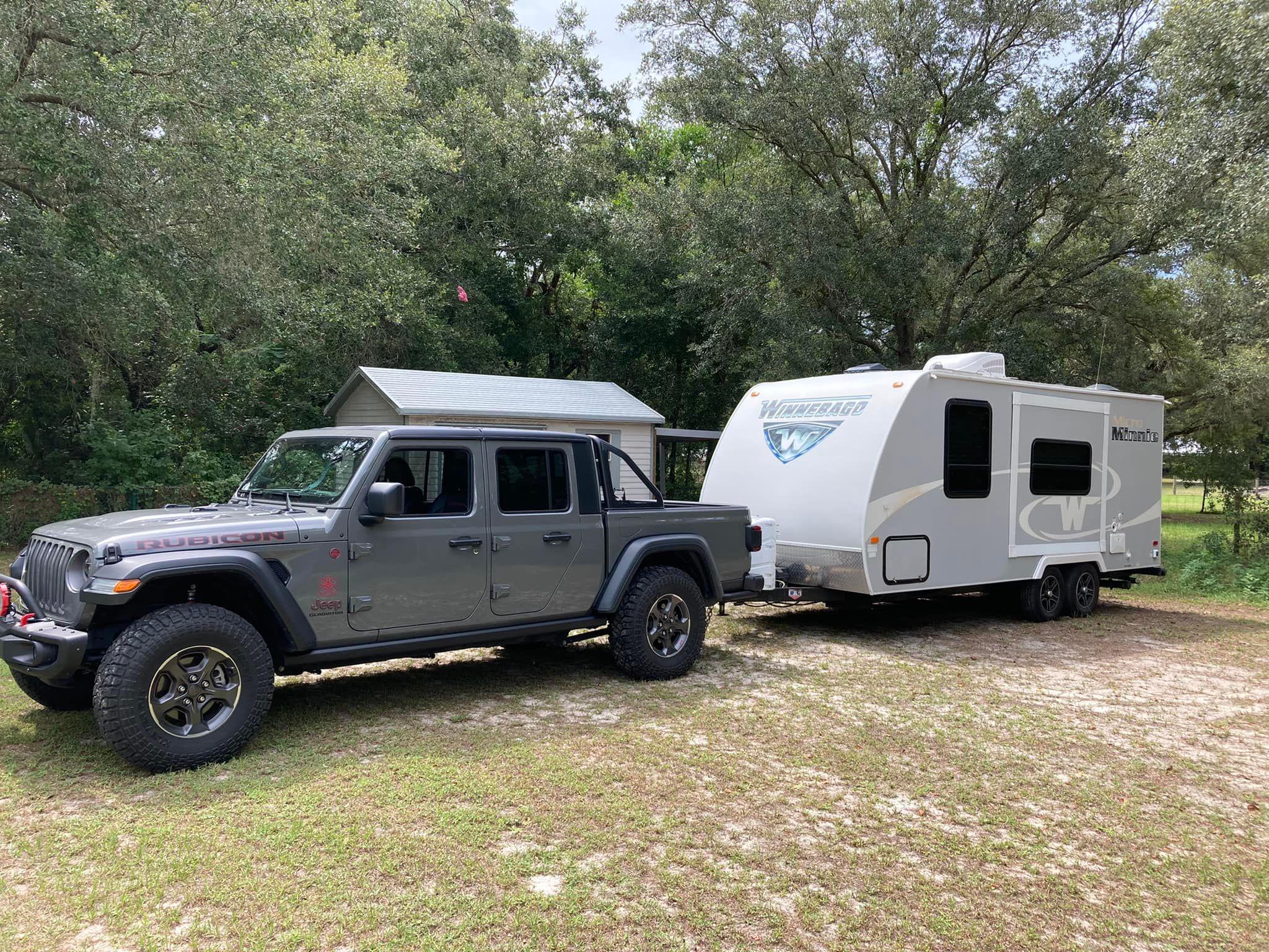

I tow a Winnebago Micro Mini 2106 with my Automatic JTR with factory tow package.
The micro mini weighs roughly 4000lb, give or take a few. You cannot trust the manufacturers information on weight. The only true way is take it to a scale fully loaded as you would be traveling.
The micro mini is 20ft length, 7ft width and rides on dual axles. This is the three reasons I went with this camper. The length and width size is much more enjoyable to tow with a Gladiator. The dual axle prevents a lot of the sway you get when pulling a camper on the interstate, without the need for a sway control bar.
I have installed a brake controller. I pack the truck light. I keep the weight of the camper evenly distributed. I tow the camper with all water tanks empty. I buy my food and drinks when I get to my destination. If I am under 5000lbs towing, I am comfortable in a JT.

Nice set up Kevin!
That's exactly how you do your JT towing. Nice, smaller foot print, narrow, light weight weight rig.
27' long 8' wide full size trailers give me the shutters.
