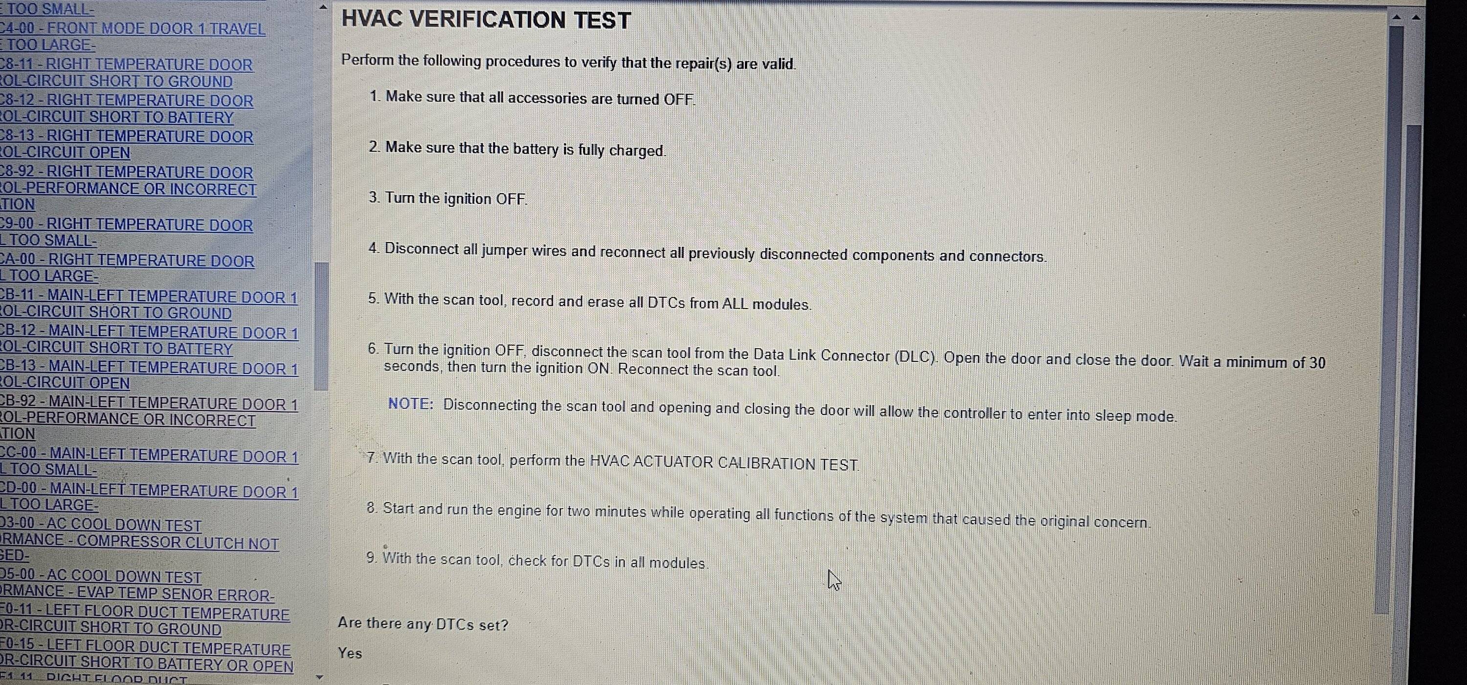

The service manual makes you believe you can replace the actuator without calibration. However there is a calibration procedure. It is done with a scan tool. If you can read nbr 6, clear codes turn off ign, remove scan tool,open and close the door, wait 30 seconds, turn ign on and reconnect the scan tool. Nbr 7 is the calibration test.

Reading the notes....
There will be a loss of cooling performance with an active dtc.
Check for bent pins on the connectors that you had off.
Thank you very much, I will try that and also check the pins
