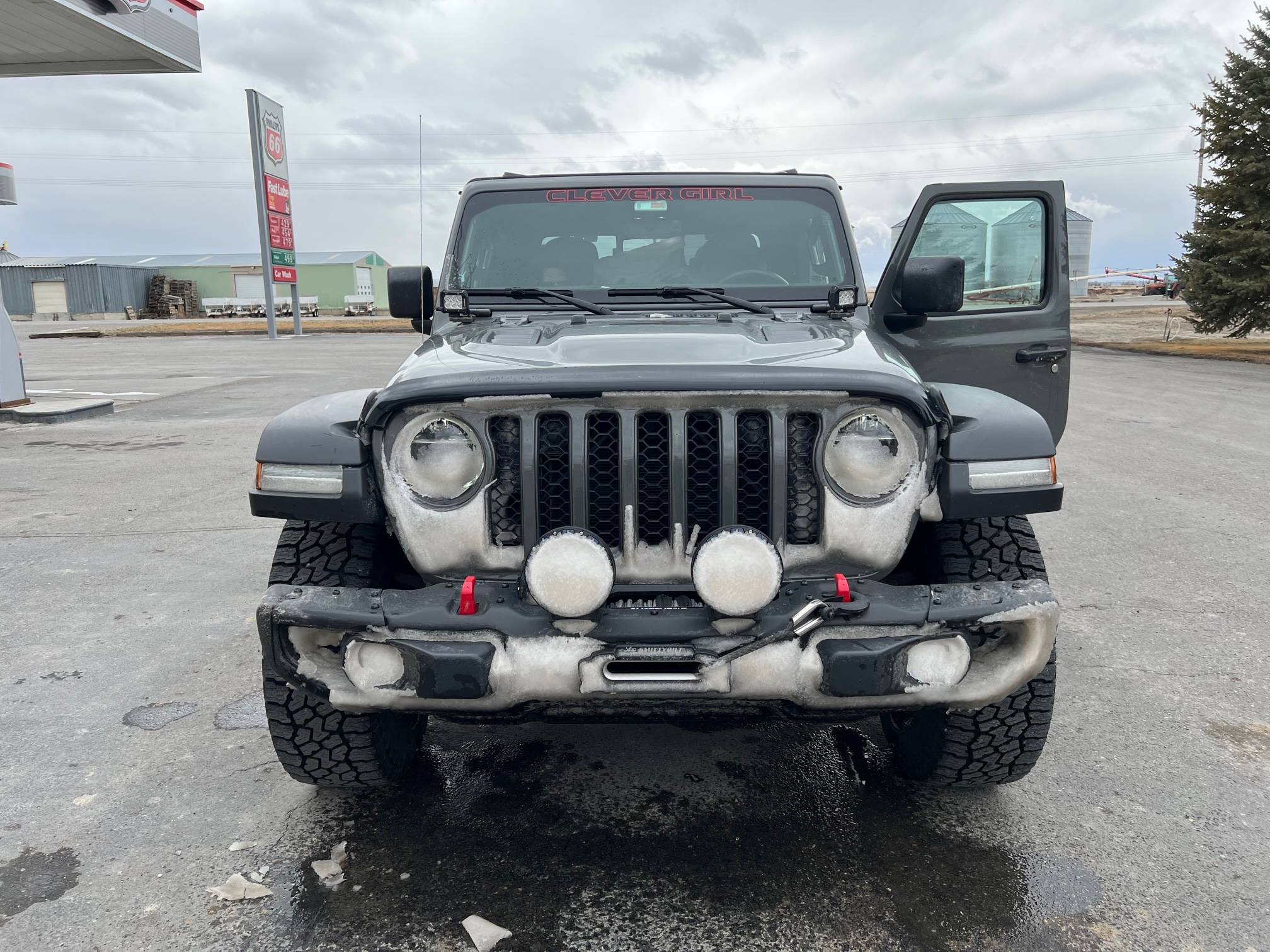

A couple years ago leaving Jackson in the morning, we hit a snow dumping going over Teton Pass (and someone putting chains on the rear tires of a Kia Optima). Then the farmland of Eastern Idaho where it was gusting hugely. Hard to see the road and keep it between the lines. Stopped in Mud Lake, ID and I took a gander at the front end. We had been driving in clear weather for about an hour at this point.
Jeep Gladiator Cowl Lights for serious snow? IMG_0163

Looks like my LP6s on the bumper would be pretty plastered?
