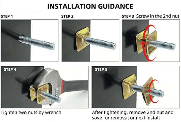

Baja Design has a tamper resistance nut system that uses two together to install and tighten
Jeep Gladiator Curious: Security for lighting bd1
then you remove the bottom one, leaving a tapered nut.

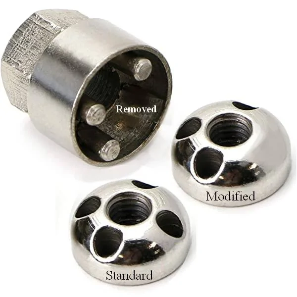

If you went with a locking nut that might be more popular (such as Amazon or eBay availability) you could weld one or two of the holes on the nut and cut the corresponding shaft on the socket off, making a nut that the common 'locking' socket would not fit on.
I like the idea, but how the heck would you cut that off if it’s recessed no the socket?!
A. When I use an abrasive cutoff wheel on my Dremel tool and they get really small instead of throwing them away, I keep them. So I have small wheels that can fit into a space like that to cut with. Normally it will take more than one since they are so small, but they are getting a 2nd use, so OK.
B. With a pointy rotary burr in a die grinder, you can get in at the base and 'cut' it off by grinding through it.
Jeep Gladiator Curious: Security for lighting burr
C. Most of the time the pins are just pressed in. So if it is a blind hole, the pin can be pried out like a tooth using vise grips or dikes.
D. If the pin was installed with a through hole, it can be drifted out with a punch.
E. If you have a drill press where it can be held securely, you can use a drill to 'poor man machine' the pin down. Will not work hand held.
mx5red
Paul
May 7, 2020
1,495
2,228
San Diego
That’s funny, that’s exactly what I would do, I just thought there was a way that people with more machining experience than me would do it. :CWL:
