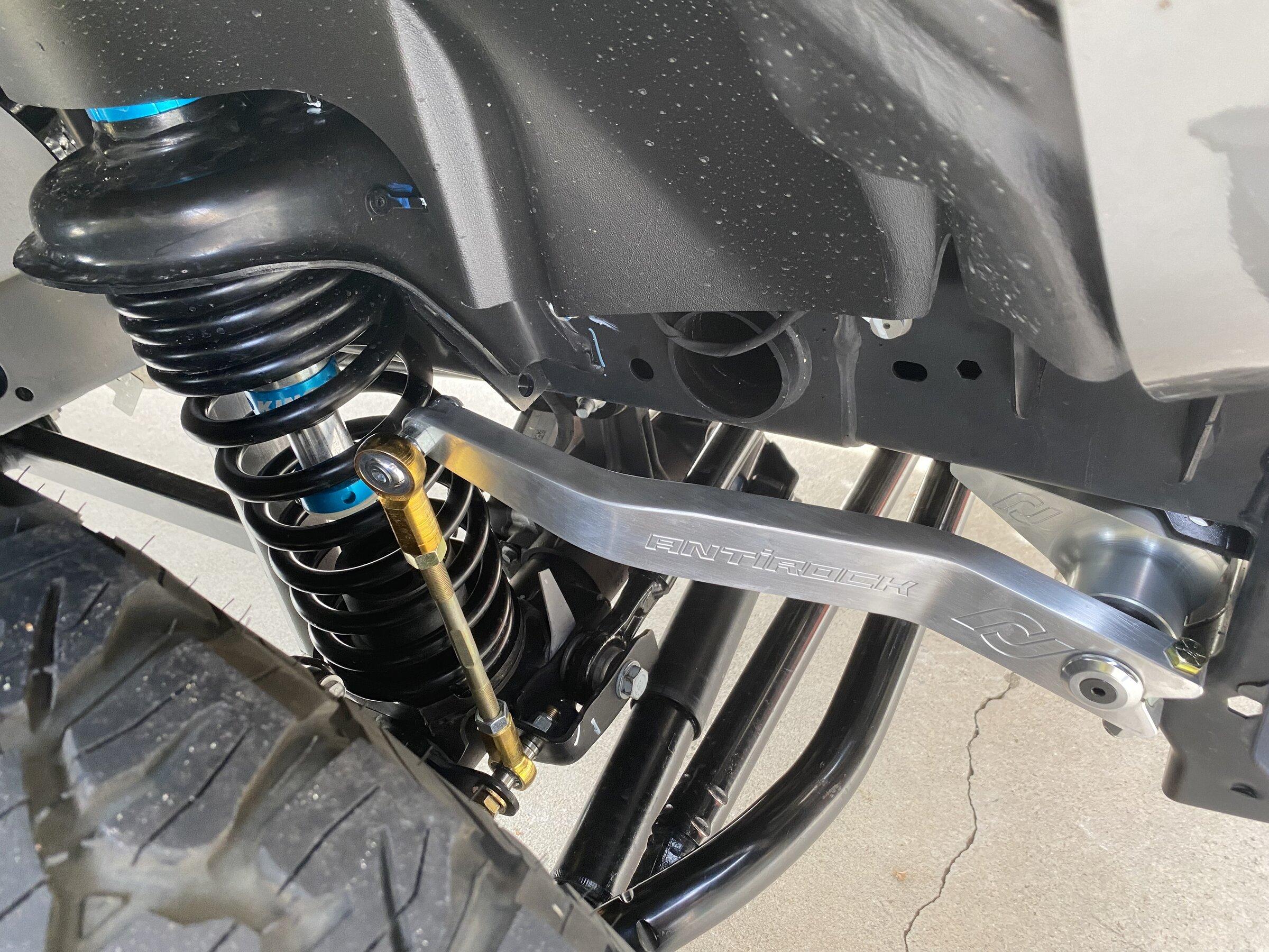

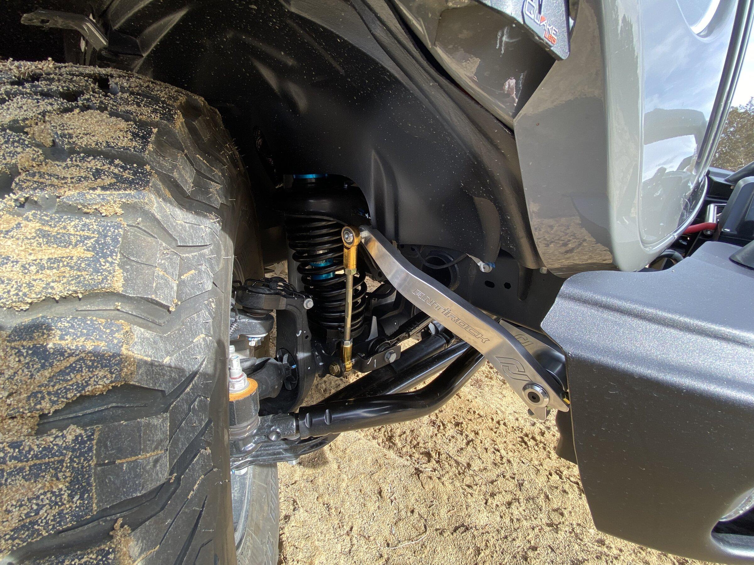

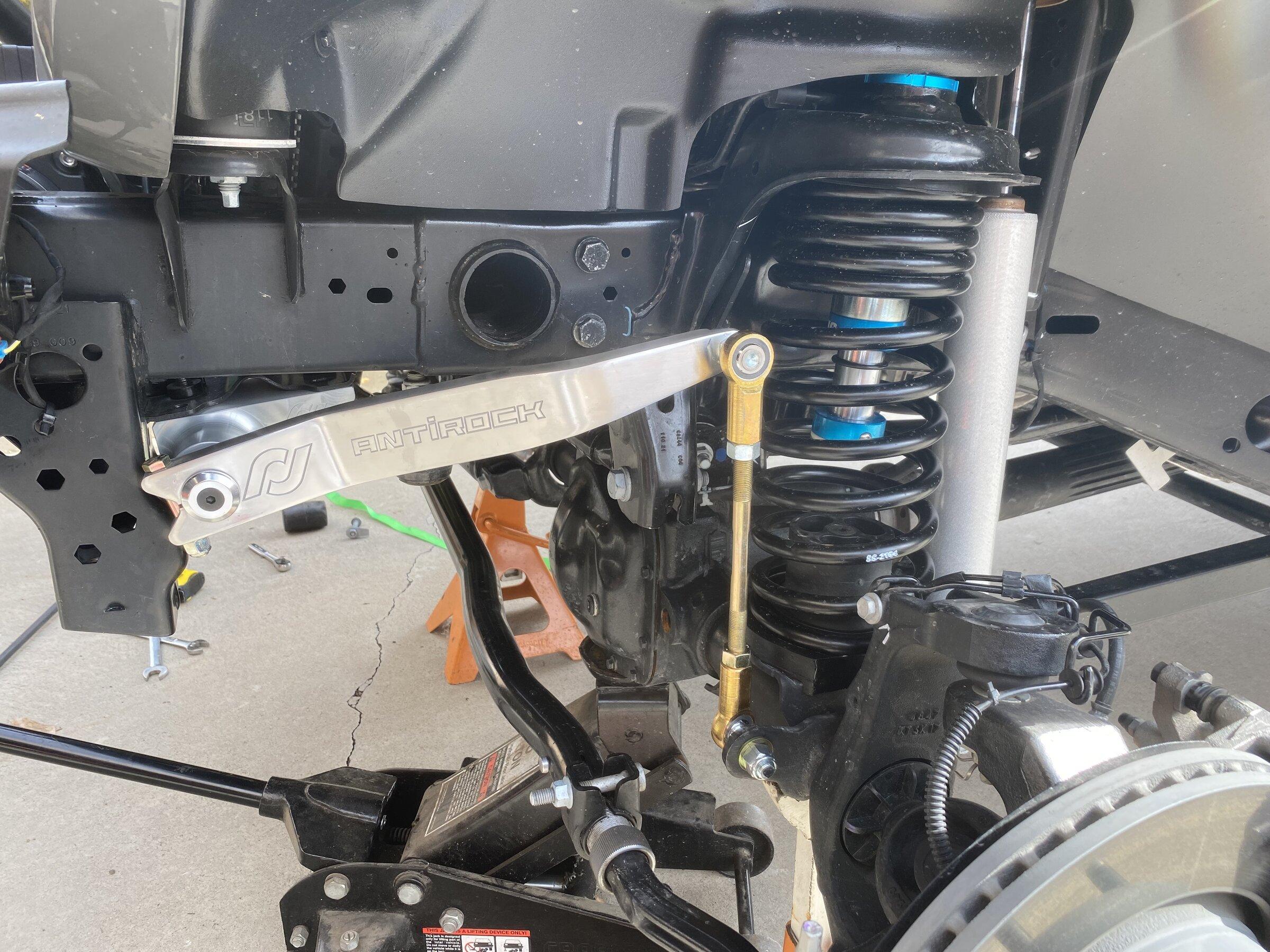

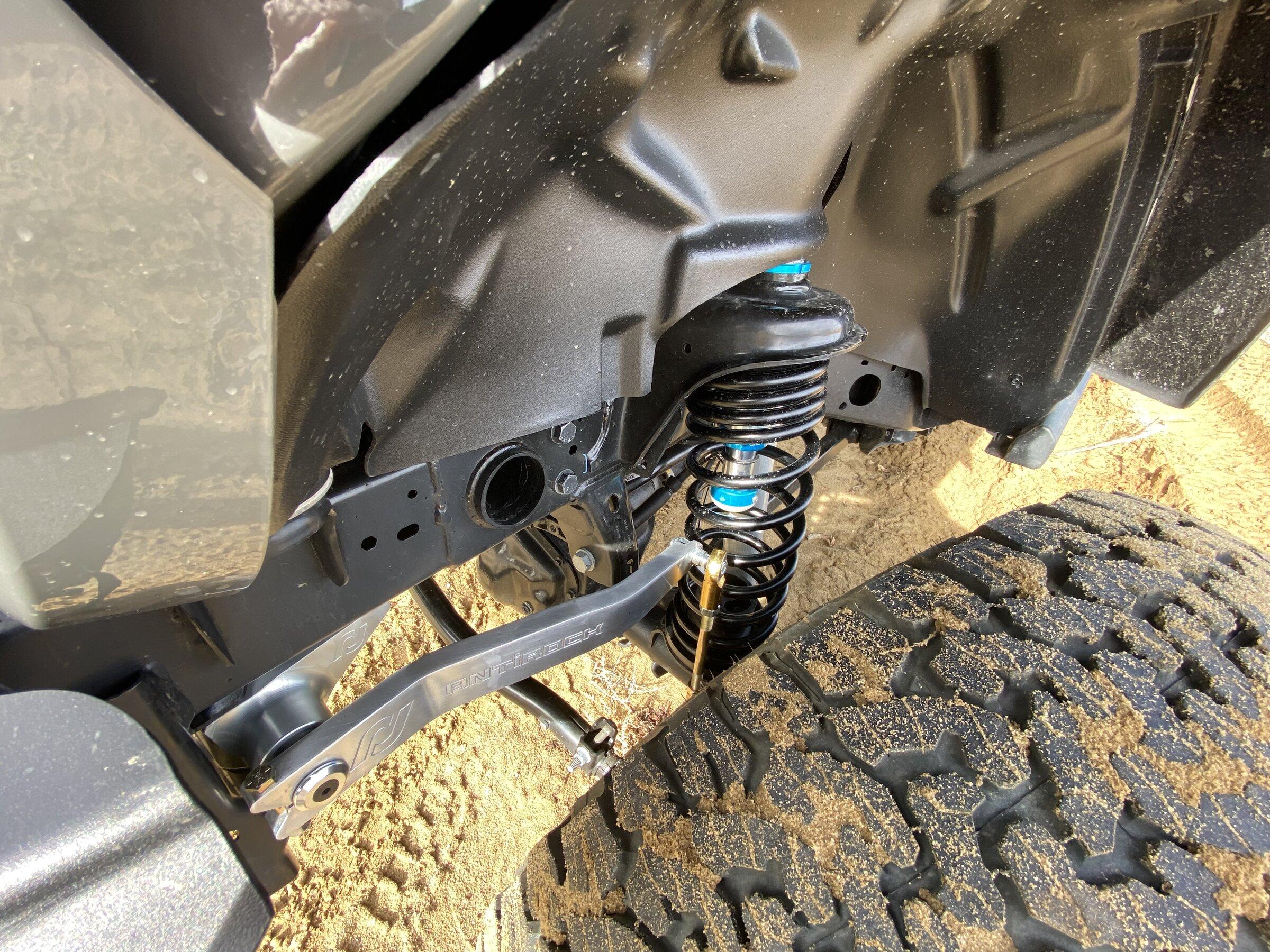

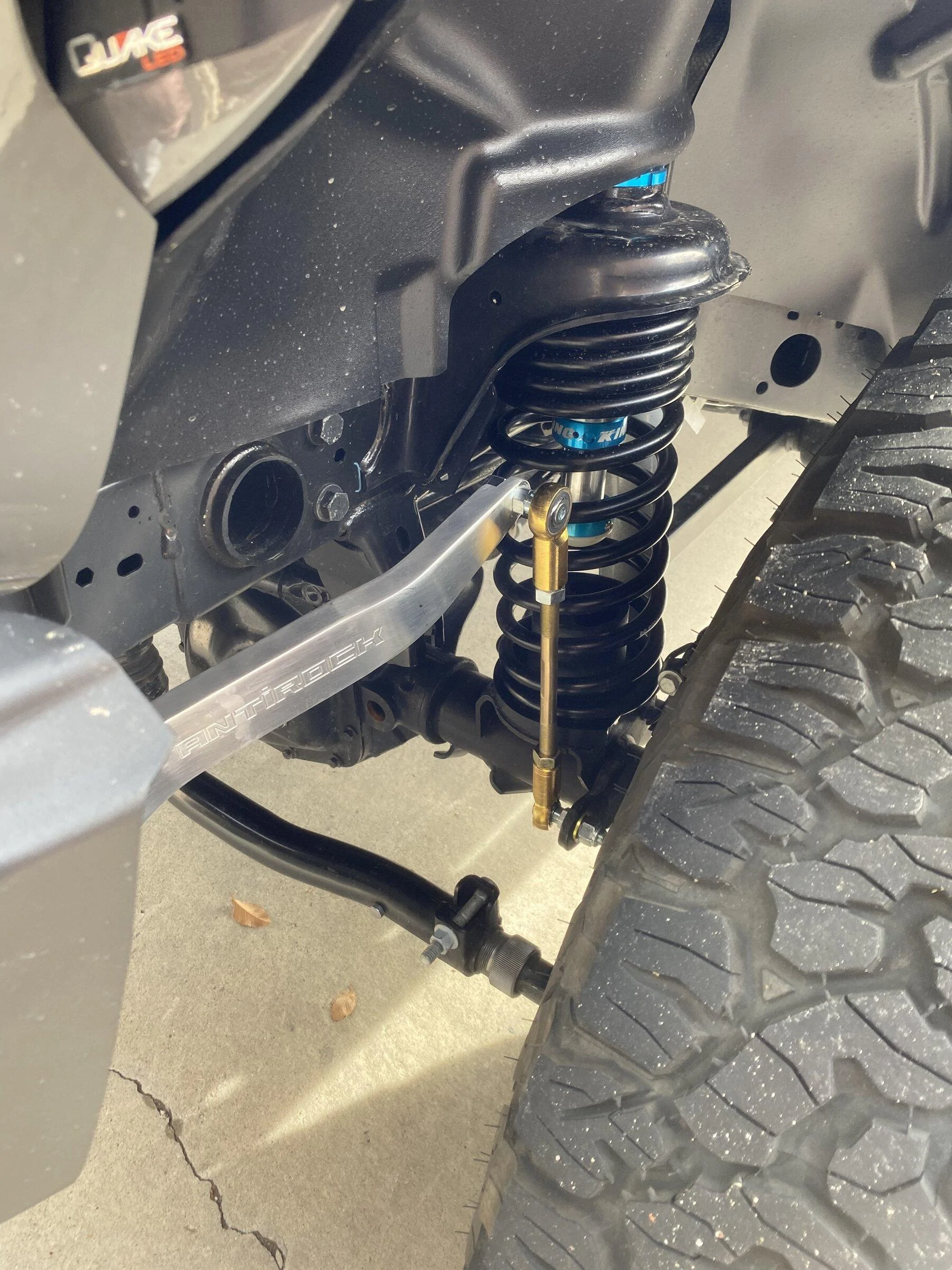

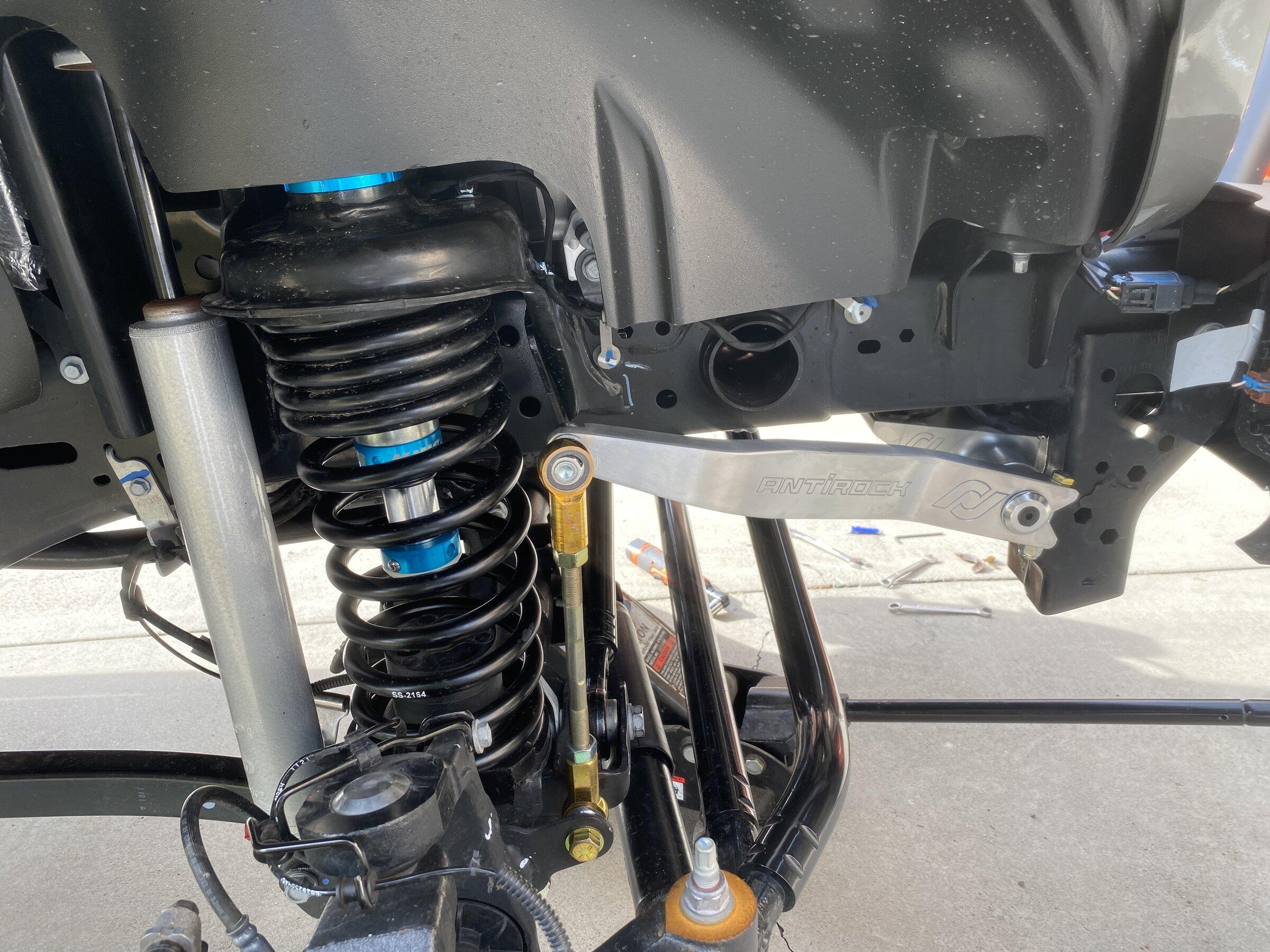

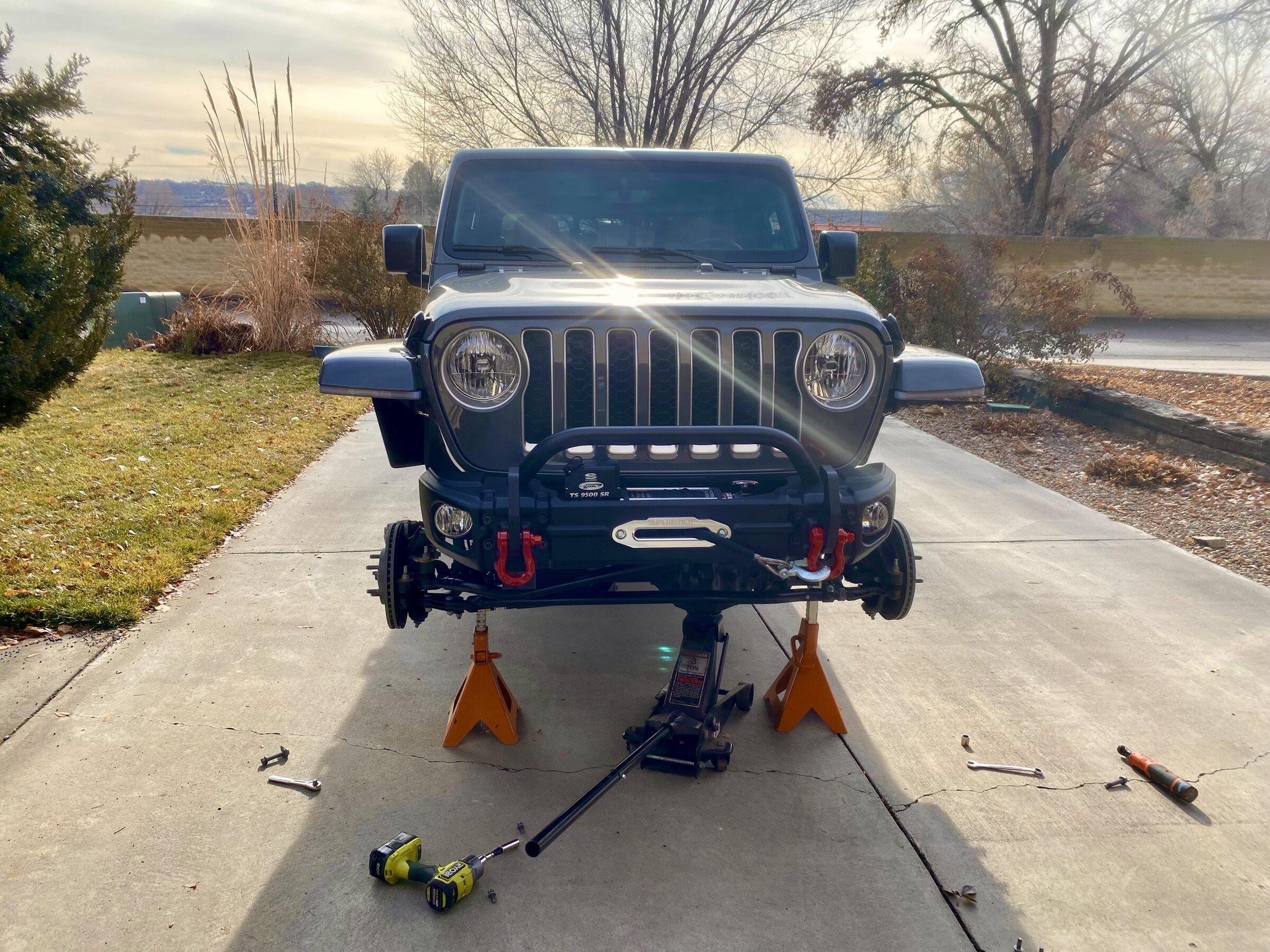

Since I didn’t opt for the Rubicon I needed some sort of sway bar disconnect. I decided on the AntiRock for several reasons. Number one was ride quality, then ease of use and price vs the so called “quick disconnects“. Yes they are expensive but very high quality and with the combo of the Rancho 9000XLs and King hydro bumps it is the best riding combo I have ever had. It is very soft and plush with a bit more body roll in the corners but nothing severe.

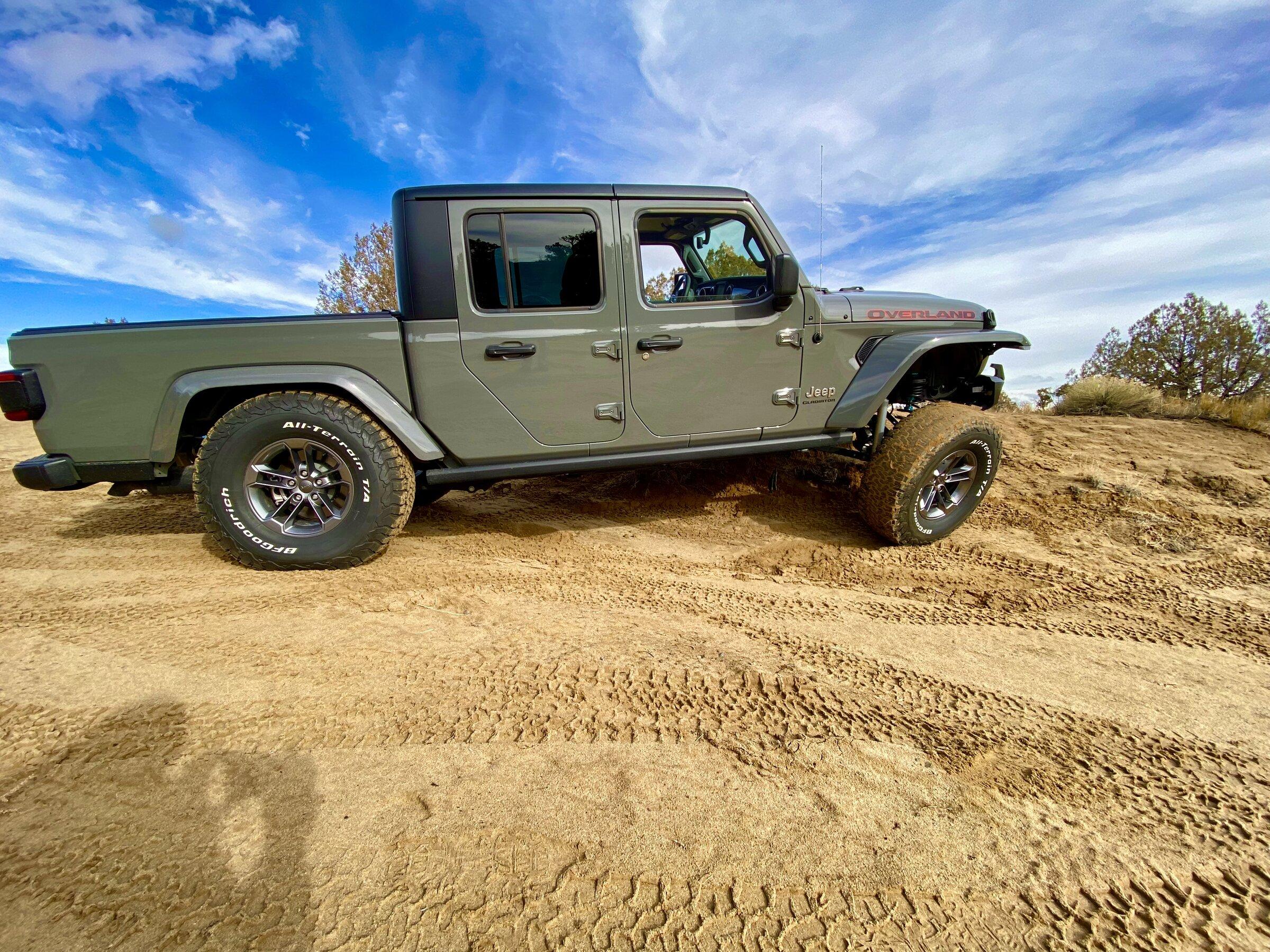

I have had many modified Jeeps throughout the years and all I have to say is WOW. I have nothing on this JT except MC 3.5” springs, the AntiRock, and Ranchos with a 3/4” spacer in the rear (I need to add about 3/4” in the rear to make it level, it’s a tad high in the front)That’s it. It drives great, no wandering, smooth ride on 37s with 28psi. I have the front Ranchos set at 4 and the rears at 3. Here are some pics as well as some in my little off-road area near me. Too wet for anything crazy.
Wow, gorgeous Jeep! What wheels are those, Quadratec 1941's?
Yes sir! What are you doing over here in not real Jeep land? Lol

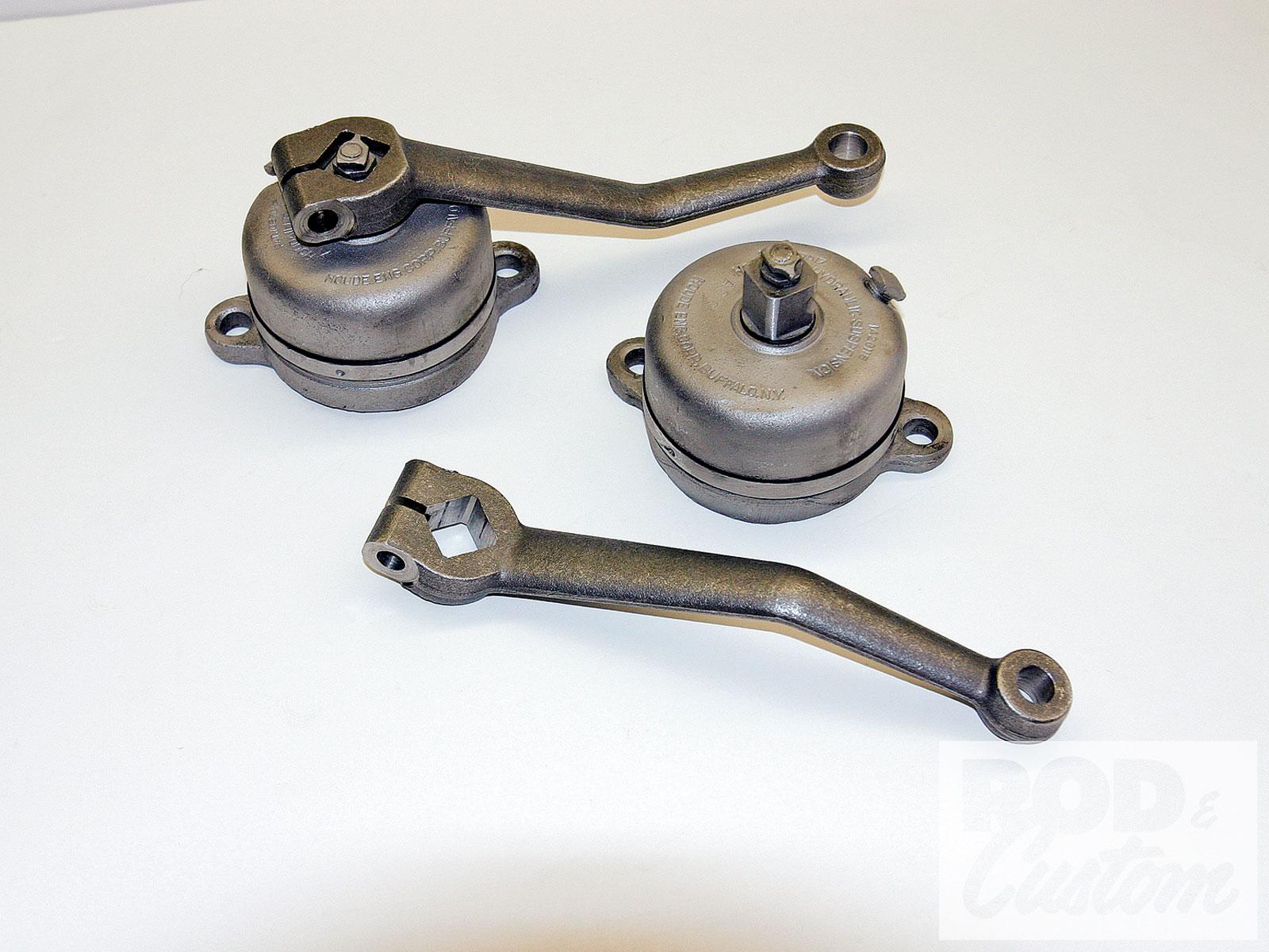

Now that would be interesting. When I saw the photos at the beginning of this thread, I thought it was a system that eliminated the roll bar and instead used roll dampers.
Like the old lever dampers used on pre WW2 cars.

For those Mojave owners who may be interested, keep in mind you will need to re-locate your shock remote reservoir from its current location.
I will need to see what options there are for that before making my decision.
