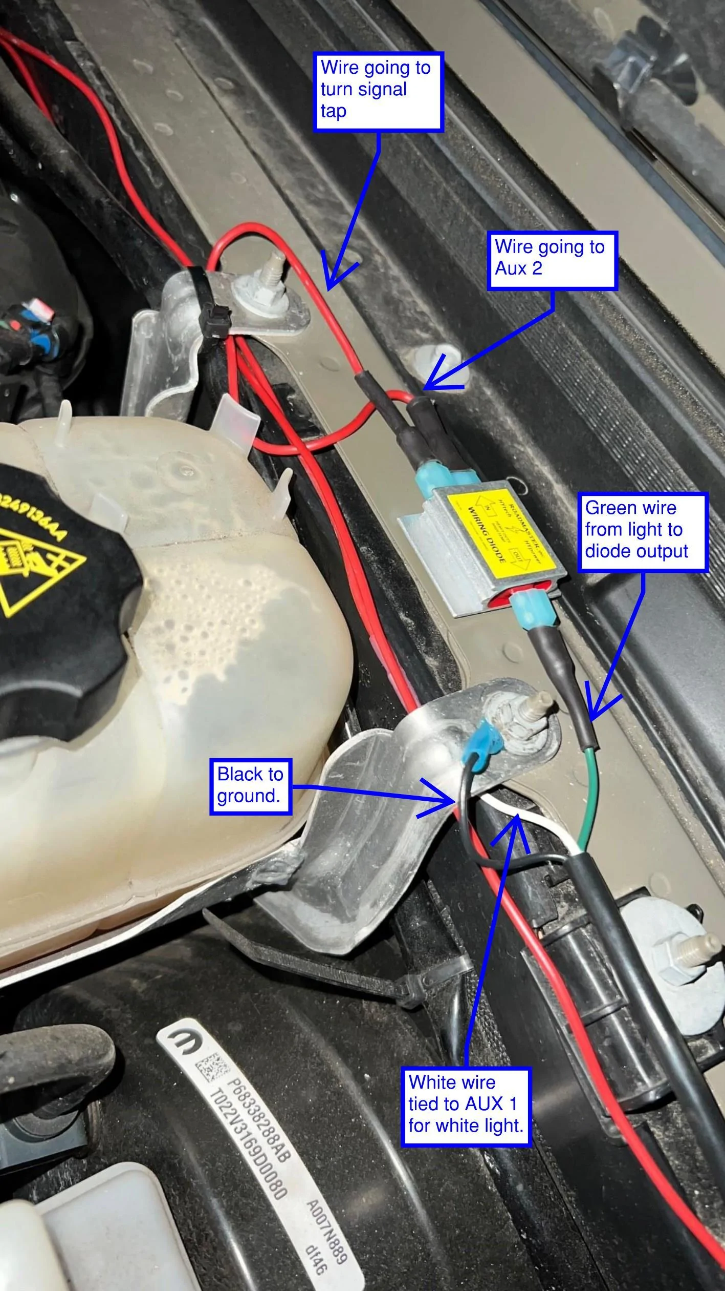

You need to include a diode. I used this…
Diode CLICK HERE
The two inputs to the diode, one will be from Aux, and the other is from turn signal. Output goes to the light (Green wire).
So drivers side you have aux 2 to diode input. Turn signal tap to diode input. Diode output to new light.
repeat on passenger side but white light goes to Aux 3 and amber goes to Aux4.

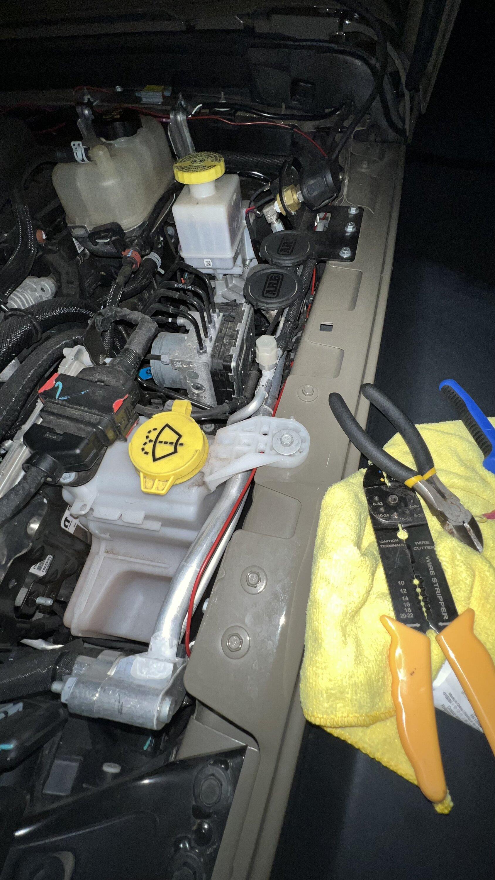

drivers side turn signal tap.

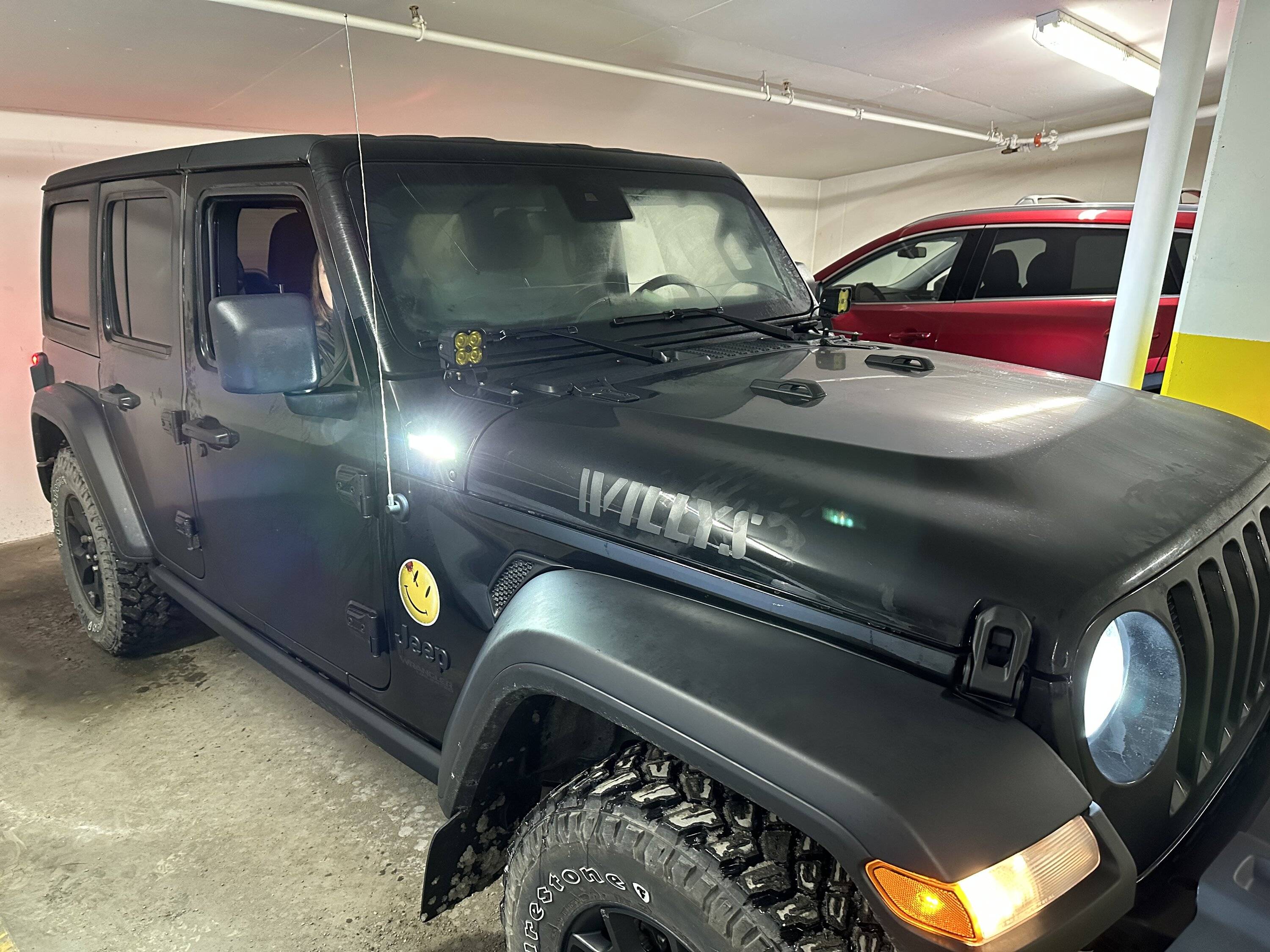

initial reaction on a street with street lights. These white lights are BRIGHT. (Can’t believe I didn’t take a picture of the ground with lights on :headbang:) it made the road look like it was daylight through my tints. Definitely worth the purchase. Just gotta determine what wiring set up works best for you and your needs.

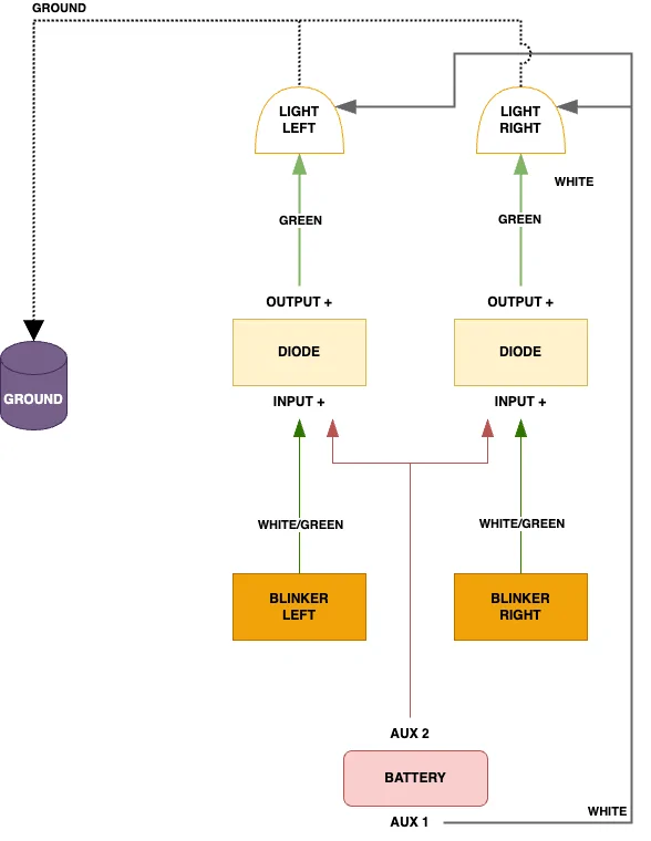

Like the diagram below:
Jeep Gladiator D&C Designs Side Marker JL-LIGHTS-DIAGRAM
Do you see anything off ? My first time doing this kind of install and I'm basing it on your work.

Looks fair to me. Disclaimer, I don't actually have these lights. But I am following along.
That would work fine. I don’t have my DC design lights setup like that, but I’m doing the same thing for my aux reverse lights. I have my DC design lights on the blinkers and white to aux 2. They work great. I didn’t need to turn the ambers on with a switch, and my aux switches were used up anyway. :) but it should work great.

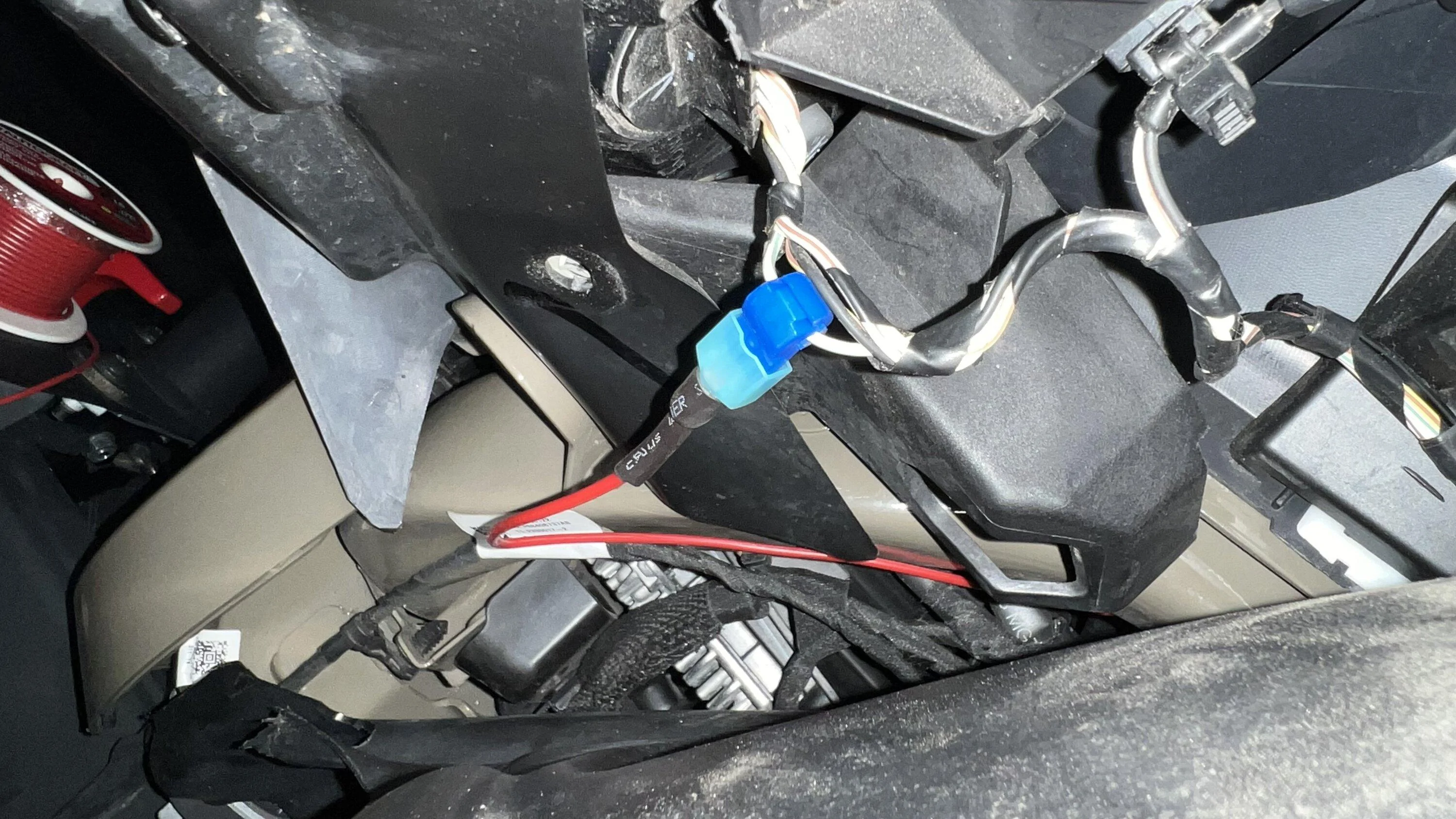

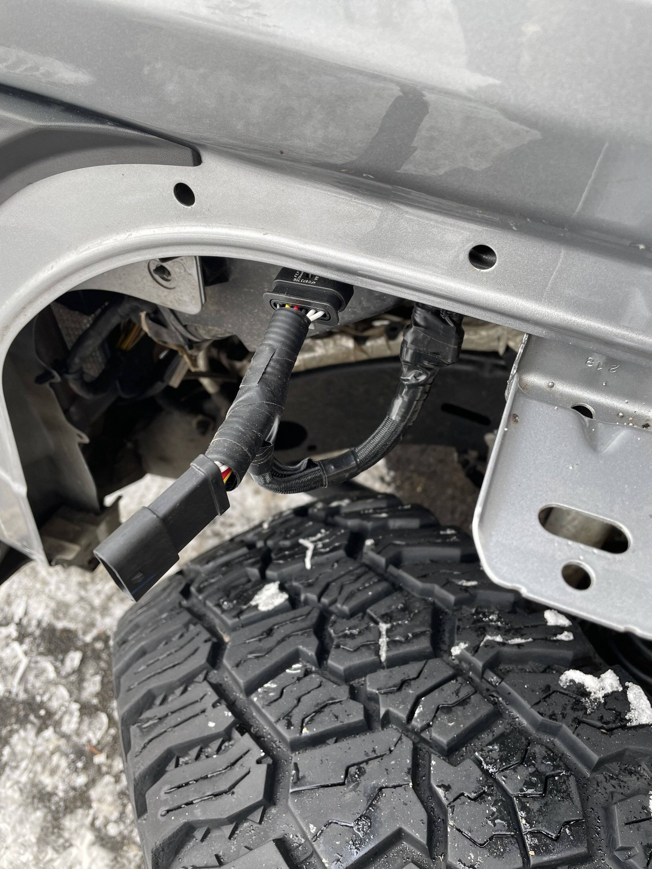

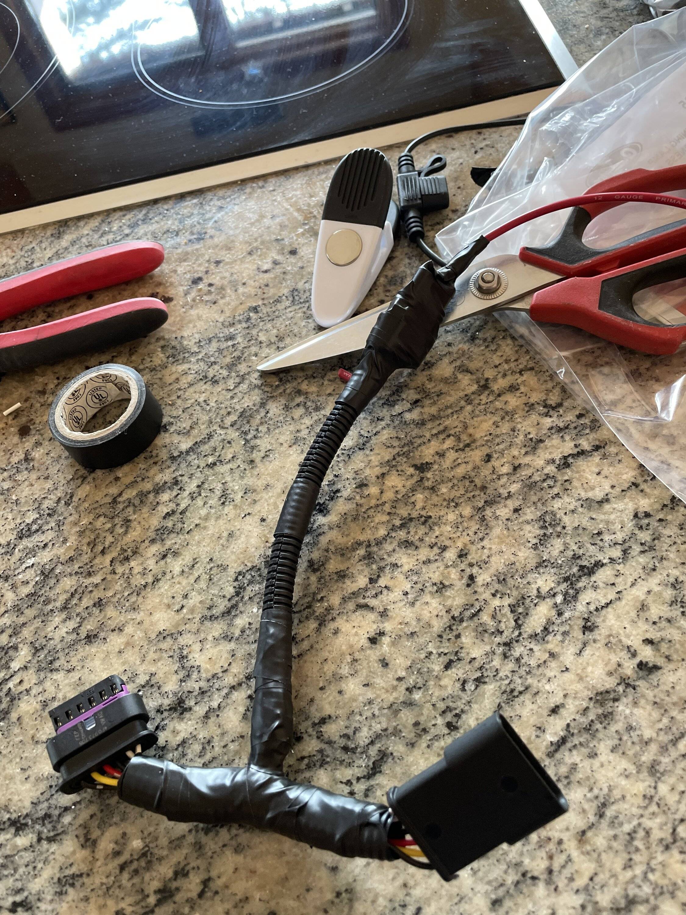

@Vanzano Your timing is impeccable! I'm planning to add these in the same configuration you've outlined and I'm expecting the lights to be delivered today.
Your thoughts on tapping (posi-tap or other method) into the harness? I've seen a few discussions about more complex (and possibly 'better') options.

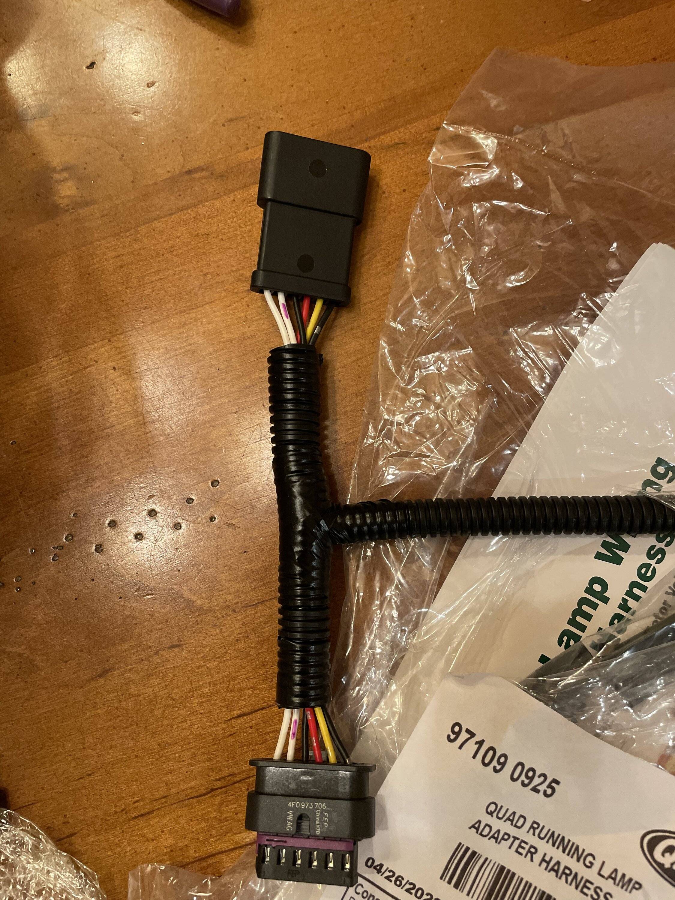

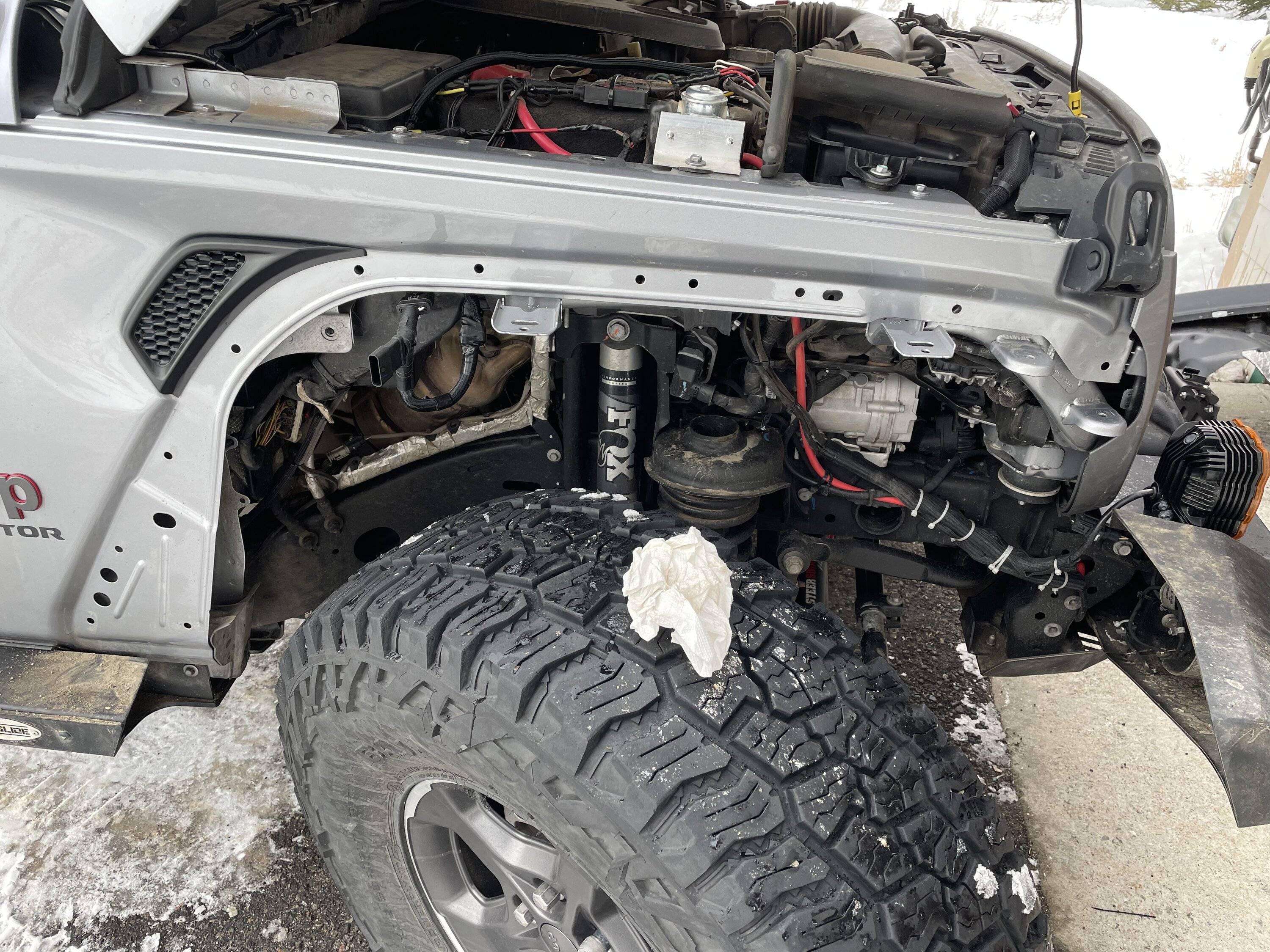

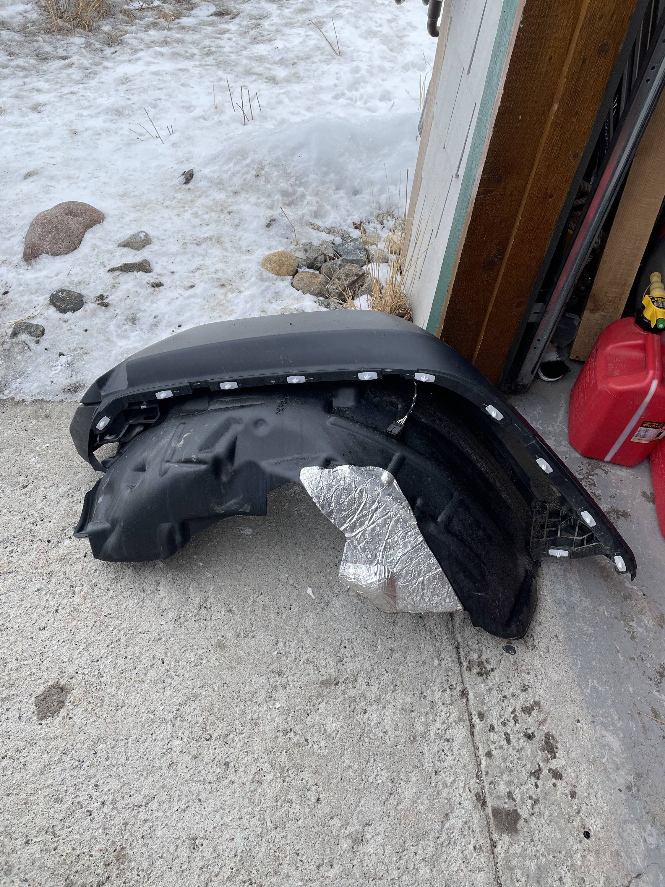

I’d highly recommend against tapping. It just doesn’t hold up well. And I hate touching factory harnesses. I’d recommend a harness between the fender and truck. There’s a connection there. I got quadratec DRL harnesses, then did my splicing in their harness to access the blinker wire. That way all I did was put the harness in between with no permanent changes. Here are some pictures.
That looks nice, for sure this may be the cleanest way possible to do this install. But it comes with a price tag on it, $60 bucks for two of them, they are sold out at this moment.

You can totally solder the connection, and if that’s the only way, I’d recommend doing it within the fender wiring, so you don’t impact the main harness. The entire fender/liner assembly can be removed way easier than the liner by itself. Be sure to buy some of the white clips in advance, like a dozen at least for both sides. I’d also recommend setting it up with connectors so you can remove the fender. There is virtually no access or slack on the truck harness side.
Edit: I’ve seen harnesses also from Oracle, while I hate them, and one other company. It’ll come to me. But I’m spacing it at the moment.

FYI, I found the Quadratec DRL harnesses at VividRacing and they appear to be in stock.

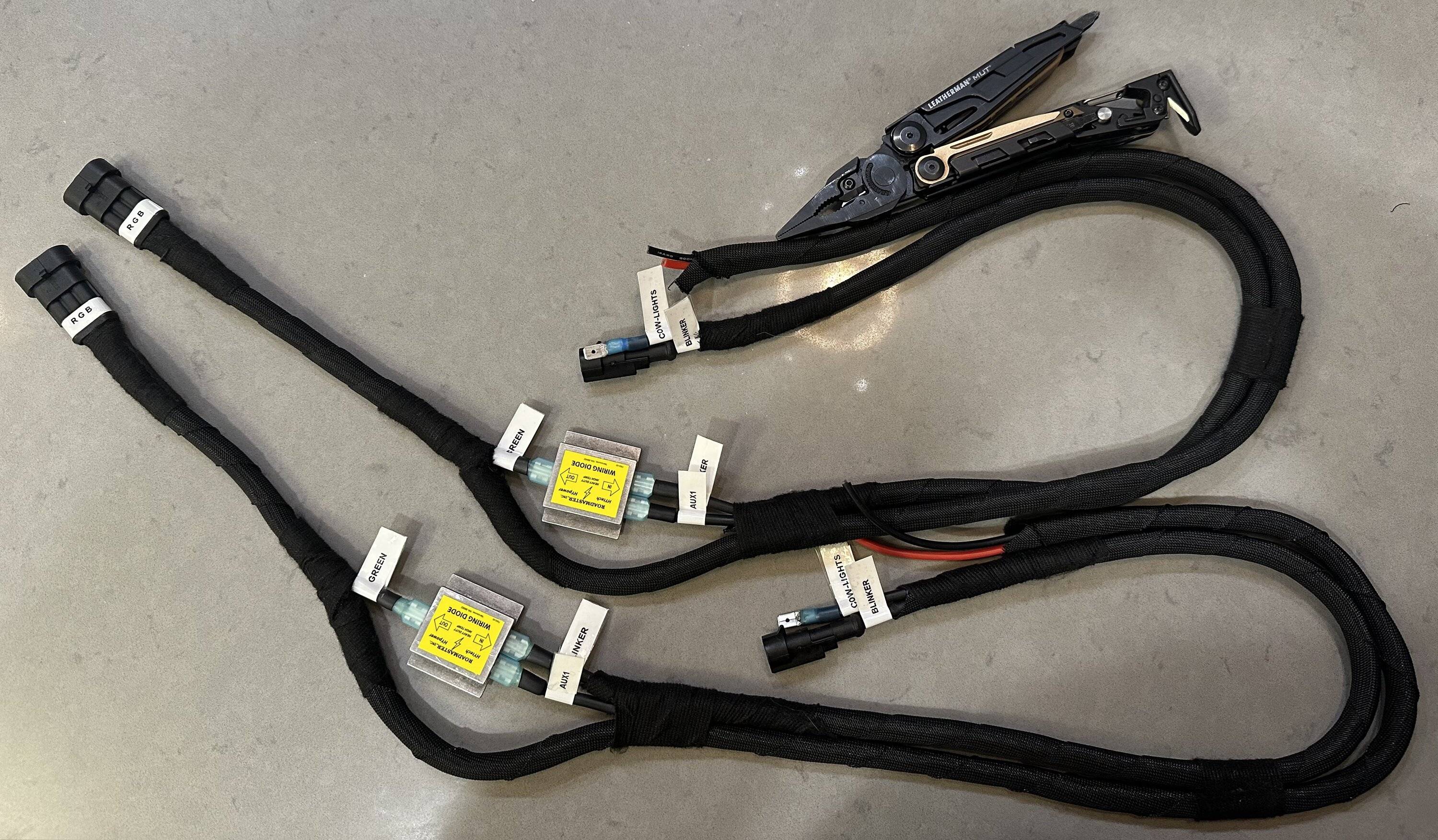

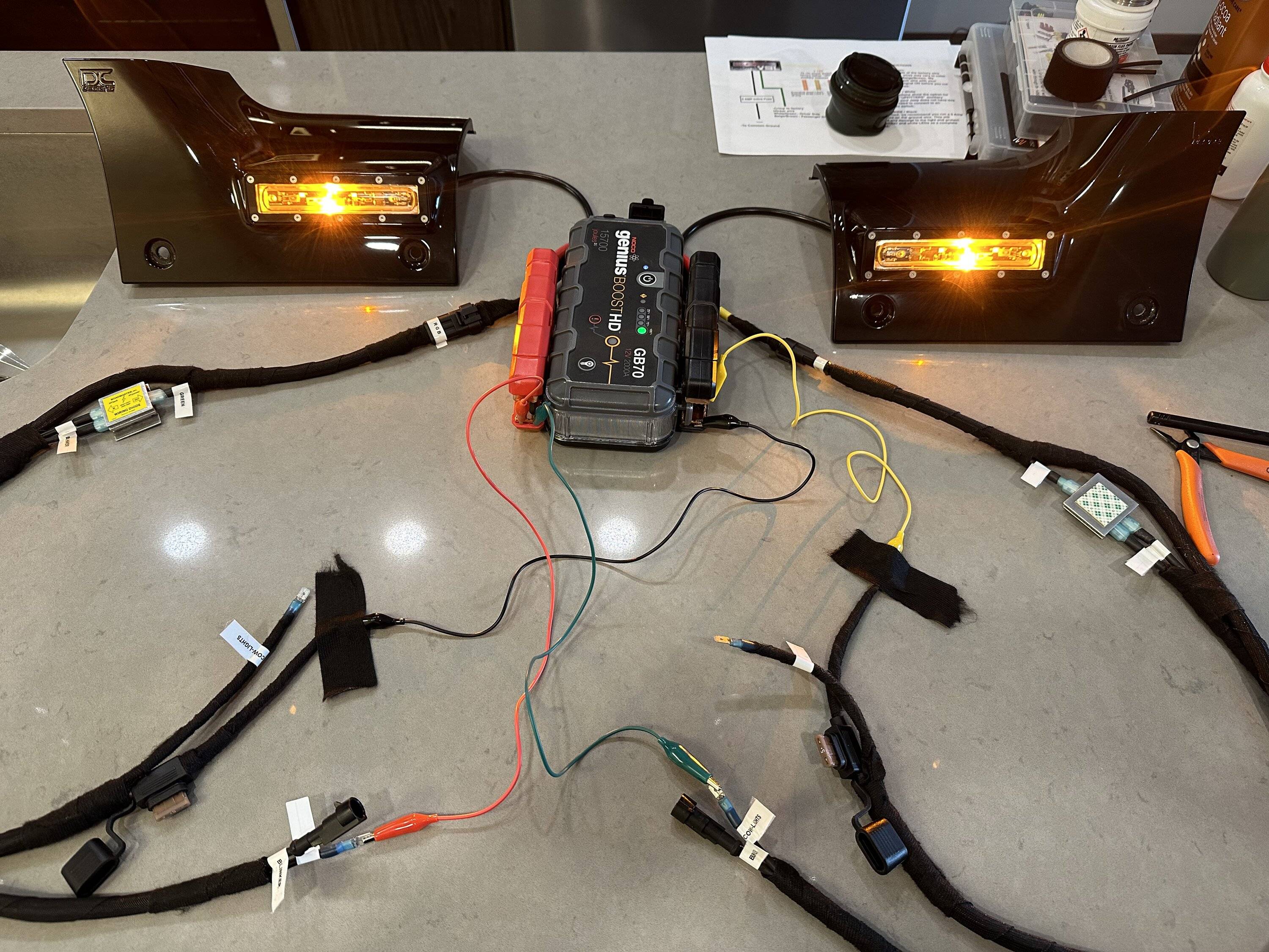

Mine finally arrived today. So I built this harness following my previous post, so I wanted to have the ability to turn the amber lights on
Jeep Gladiator D&C Designs Side Marker 68116133-FE76-4EA5-B78D-F893204AAEB1
Quick test:
Jeep Gladiator D&C Designs Side Marker 60687178-795B-42F5-9955-A816BD03676E

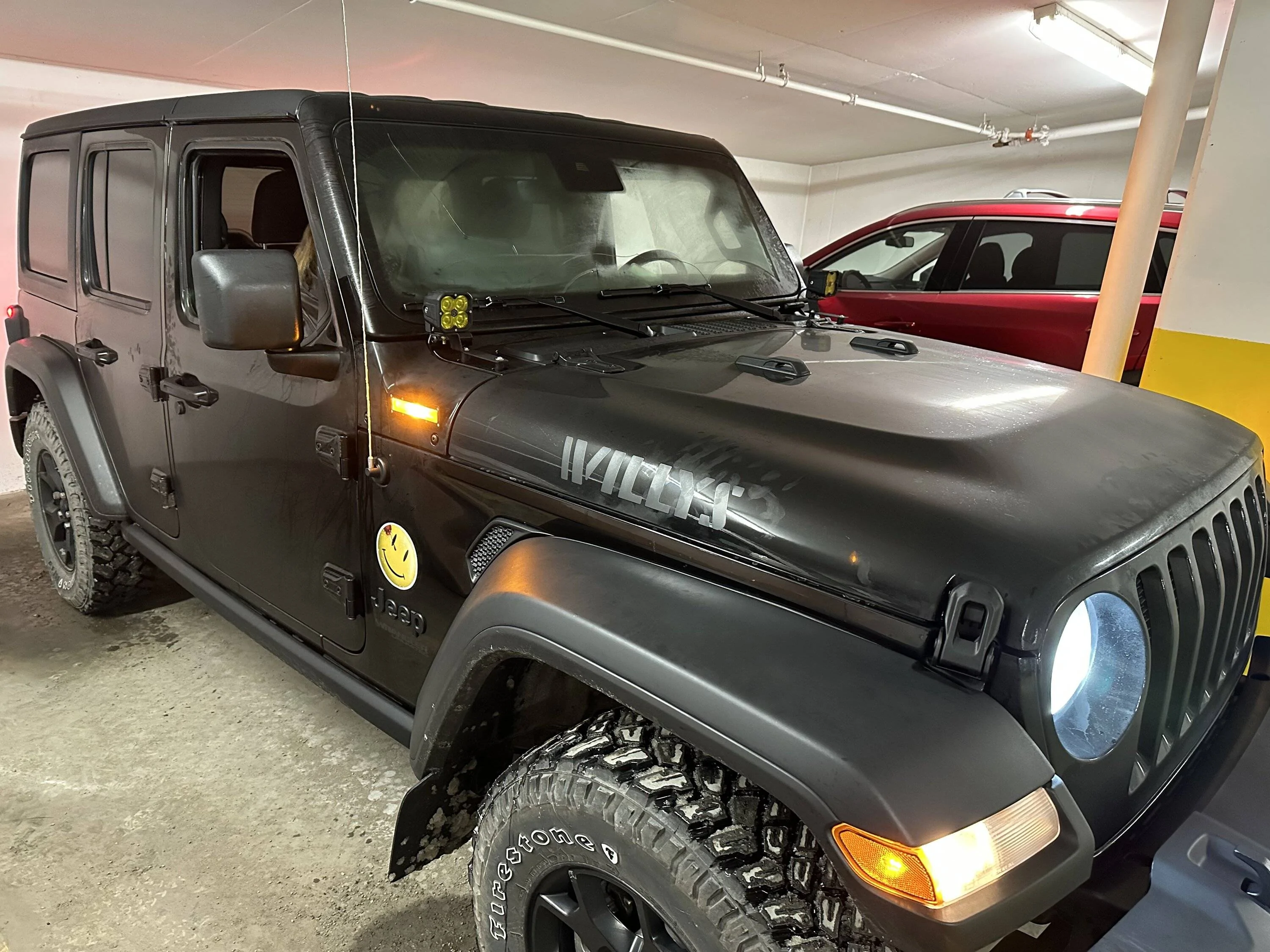

Here is the final result:
Jeep Gladiator D&C Designs Side Marker 2D2436BC-5AB6-4D4F-AF28-AE3BB5F7DCF3
Jeep Gladiator D&C Designs Side Marker 70716F14-1B26-48C9-A9A8-4E3114F5EE37
overall it’s a great product! My only comment is at this price range it should include a harness, not a big deal since I could build mine. But still, at this price point it should have that.
