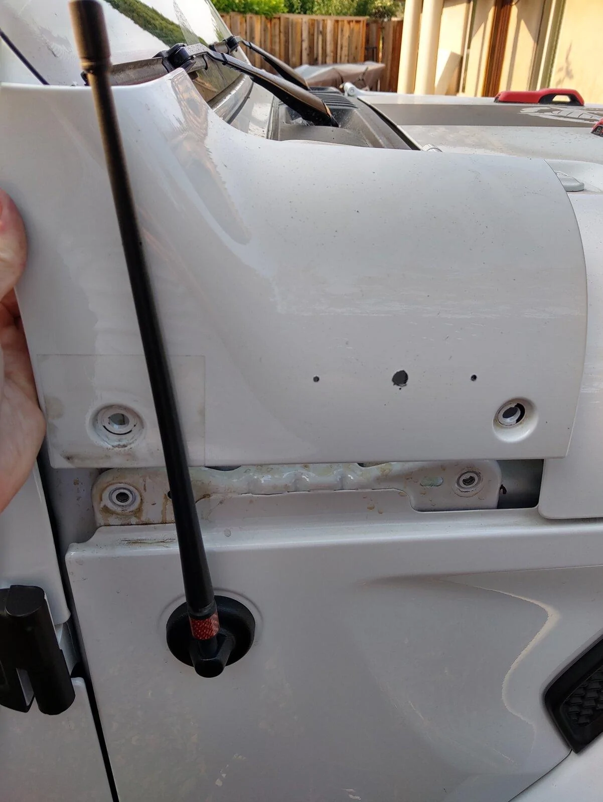

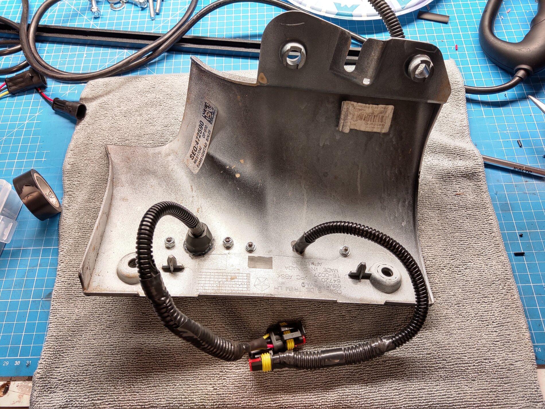

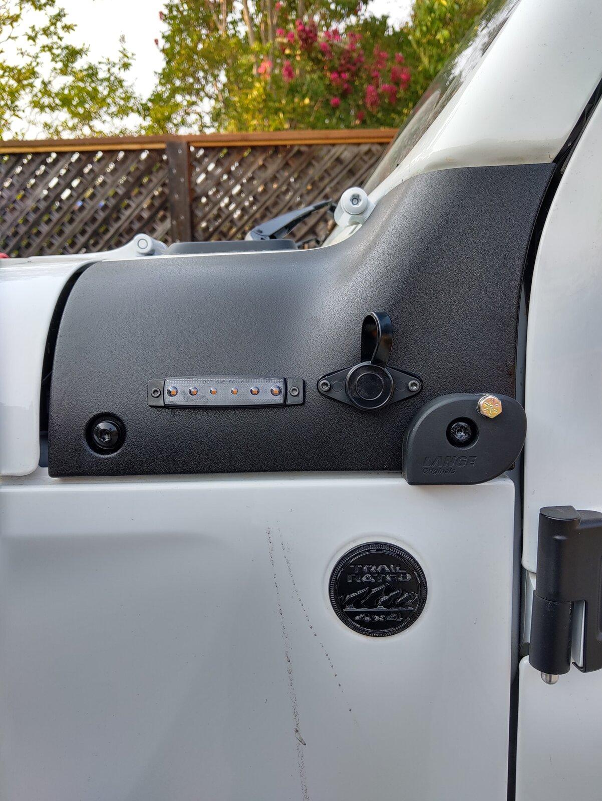

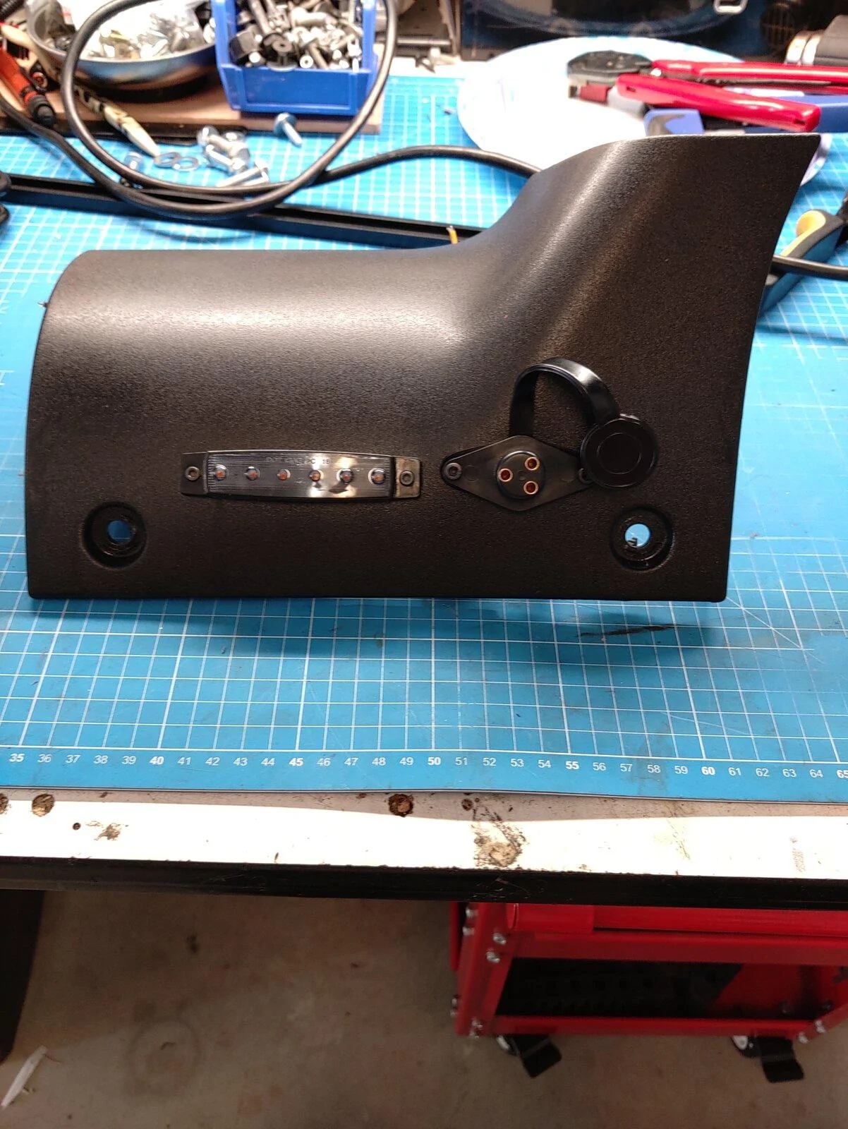

So I really like these, and have been trying to talk myself into purchasing them, but the price tag was a little steep and I wanted a few different functions... So I made my own.

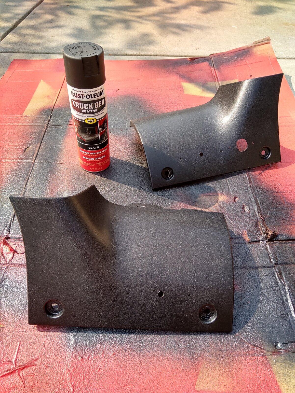

I used the cowls that were already on my JT, a rough country winch extension harness, and some cheapo led side markers from the 'zon.
I mocked it up, drilled my holes, rattlecanned them with some bedliner, then secured the LEDs and Winch Socket with miscellaneous hardware from Ace.
I tapped into the white / green turn signal wires on the front fender for the side markers.
For the winch extension, I chopped it in the middle and spliced an additional ~7ft of wire in. One end is mounted to the driver's side cowl, and I've got a 3 pin waterproof plug on the winch side and a 1 foot pigtail that goes from the harness I routed to the winches controller input (made with the other half of the RC extension).
Waterproof connectors on everything so I can unplug and remove the cowls easily if needed.
Mocked them up with my Lange Coyote mirror brackets in place to make sure there would be no conflicts.
I now have side facing blinkers, and I can plug my winch remote in right at the driver's side cowl so that I can operate the winch from the driver's seat, meaning I can self recover easier and safer.

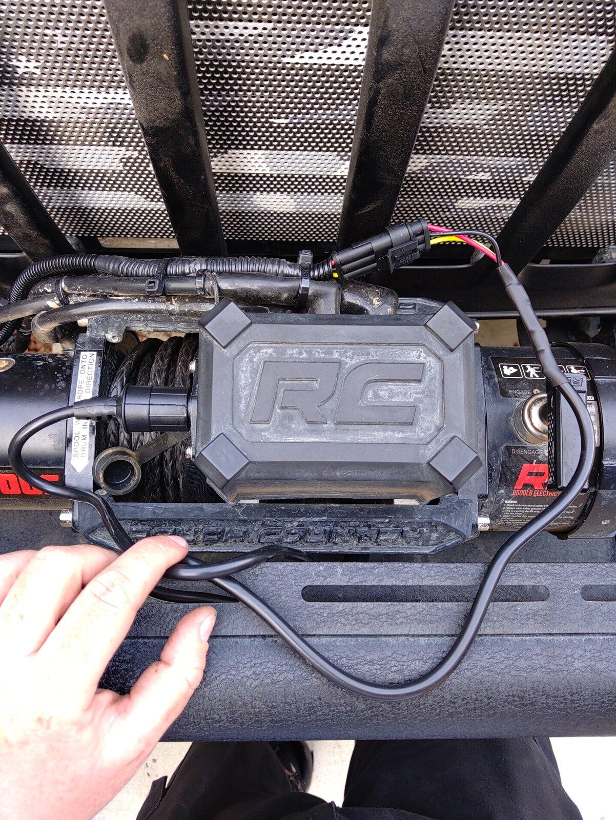

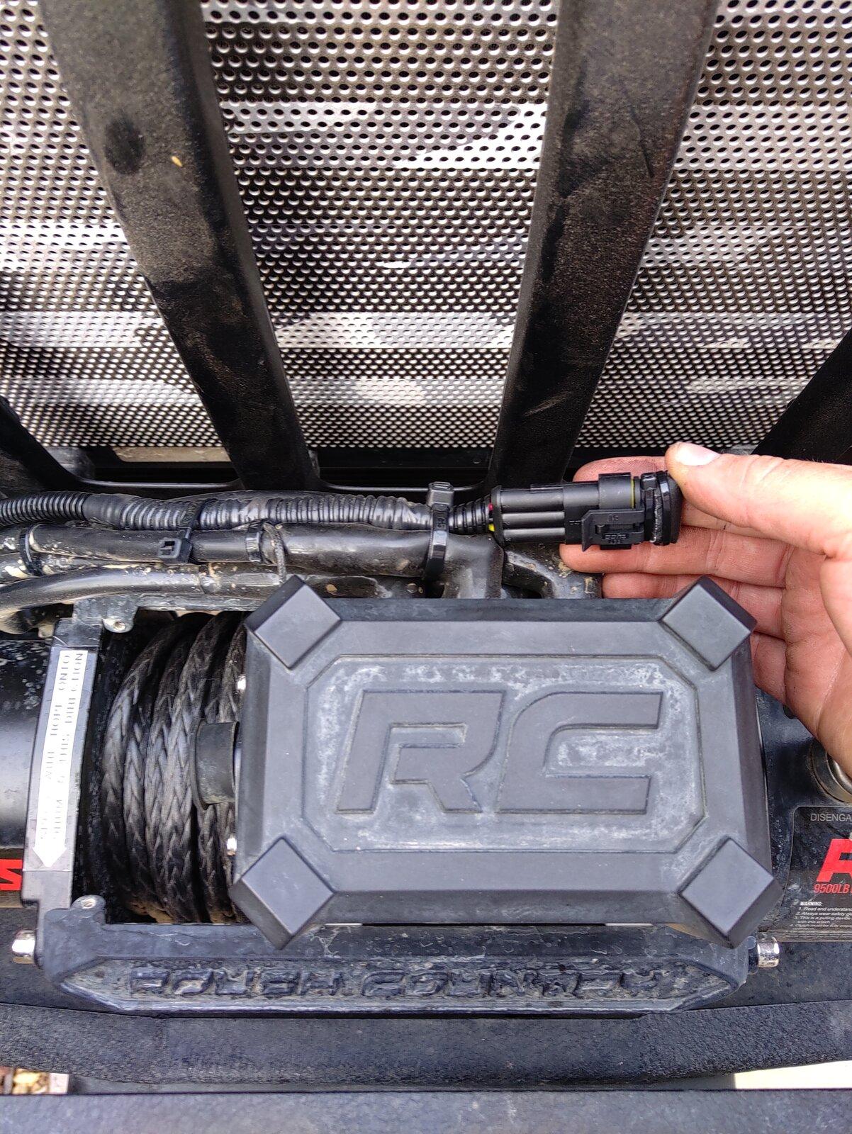

Pigtail jumps from the waterproof connector in my hand to the rough country controller connection as shown in the second picture.
Sacrificed one of my harness connectors to make a plug for when it's not in use. Will keep the pigtail in my gear bag with the controller.
Jeep Gladiator D&C Designs Side Marker IMG_20210815_180736056
Jeep Gladiator D&C Designs Side Marker IMG_20210815_181518904
Edit: to be fair to the dudes at Rough Country, the controller cable is long enough to reach the driver's seat without all these shenanigans, but I like that I can hook it up this way and not have a bunch of slack hanging around near the winch / over the hood etc. I'll be bundling the slack in the pigtail for the same reason.

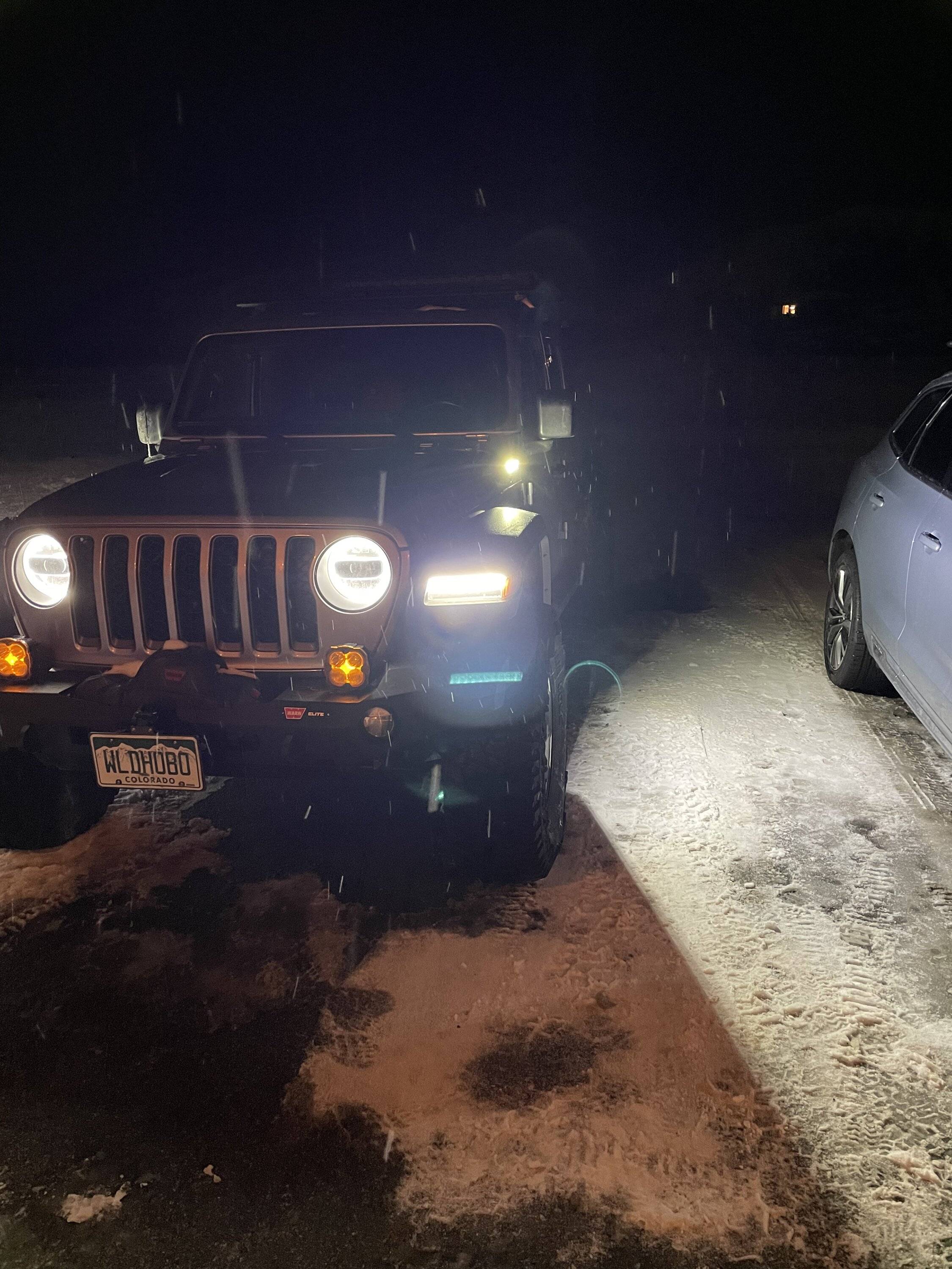

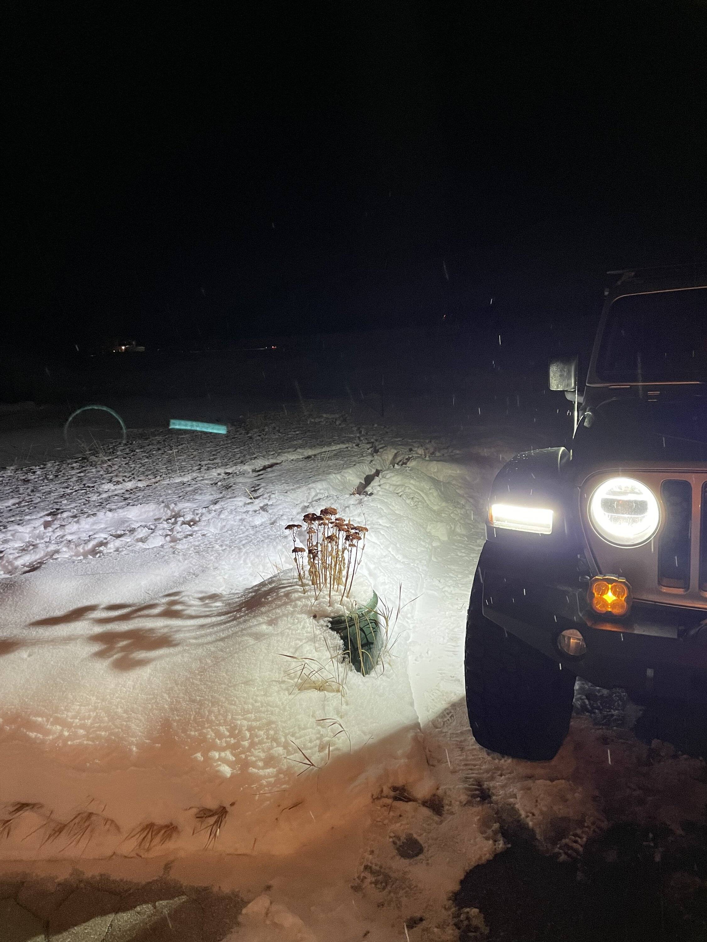

Okay. Products arrived. Product installed half way… but only because it got dark out lol. reaction….Do I wish for the price it came with standard wiring and some connectors and what not…. Absolutely. But it’s hard to do that since everyone installs them a little different to suite their needs, which is what I did.
Jeep Gladiator D&C Designs Side Marker 9322C09D-3004-4E48-9919-AD41013697D0
So what I did, was what they recommend. Wire the white to an AUX switch and amber to The turn signal. However, I also wanted the amber on an aux switch for constant on. AND I wanted to control each light individually, so I can only turn on the right light or just the left or both. This is so if at camp I wanted working light I have white light on the side I’m on and not bothering others or if I wanted just casual light to light up the ground amber would be used. So this ended up taking all 4 aux switches. (I haven’t used any aux switches for two years but I do plan on getting an 8 switch controller, just wanted to get these installed and see how they are until I get that controller, so don’t freak out people lol)
To do this is rather simple…
White light (White wire):
Drivers goes to Aux 1. Passenger goes to Aux 3. Done. Easy.
Amber light (Green wire):
You need to include a diode. I used this…
Diode CLICK HERE
The two inputs to the diode, one will be from Aux, and the other is from turn signal. Output goes to the light (Green wire).
So drivers side you have aux 2 to diode input. Turn signal tap to diode input. Diode output to new light.
repeat on passenger side but white light goes to Aux 3 and amber goes to Aux4.
Jeep Gladiator D&C Designs Side Marker 81A9CA52-CC17-495F-80DB-56C7A9EAABDA
drivers side turn signal tap.
Jeep Gladiator D&C Designs Side Marker FF12F3D6-5EA7-4531-BC9A-BC3A15BA868F
Jeep Gladiator D&C Designs Side Marker 81FB46CC-819D-4108-9476-12FC73C2FAEA
video going thru the switches and turn signal.
Now. To really see if the work for this was necessary, I’ll be on the beach at night tomorrow and will take some pictures. I’m hoping the amber is bright enough to light the ground at camp. If it’s not…. Well that would suck and wasted some wire and everyone can ignore my post (minus the white lights being individually controlled cause that is nice) ?
initial reaction on a street with street lights. These white lights are BRIGHT. (Can’t believe I didn’t take a picture of the ground with lights on :headbang:) it made the road look like it was daylight through my tints. Definitely worth the purchase. Just gotta determine what wiring set up works best for you and your needs.
more pictures to come. ??
