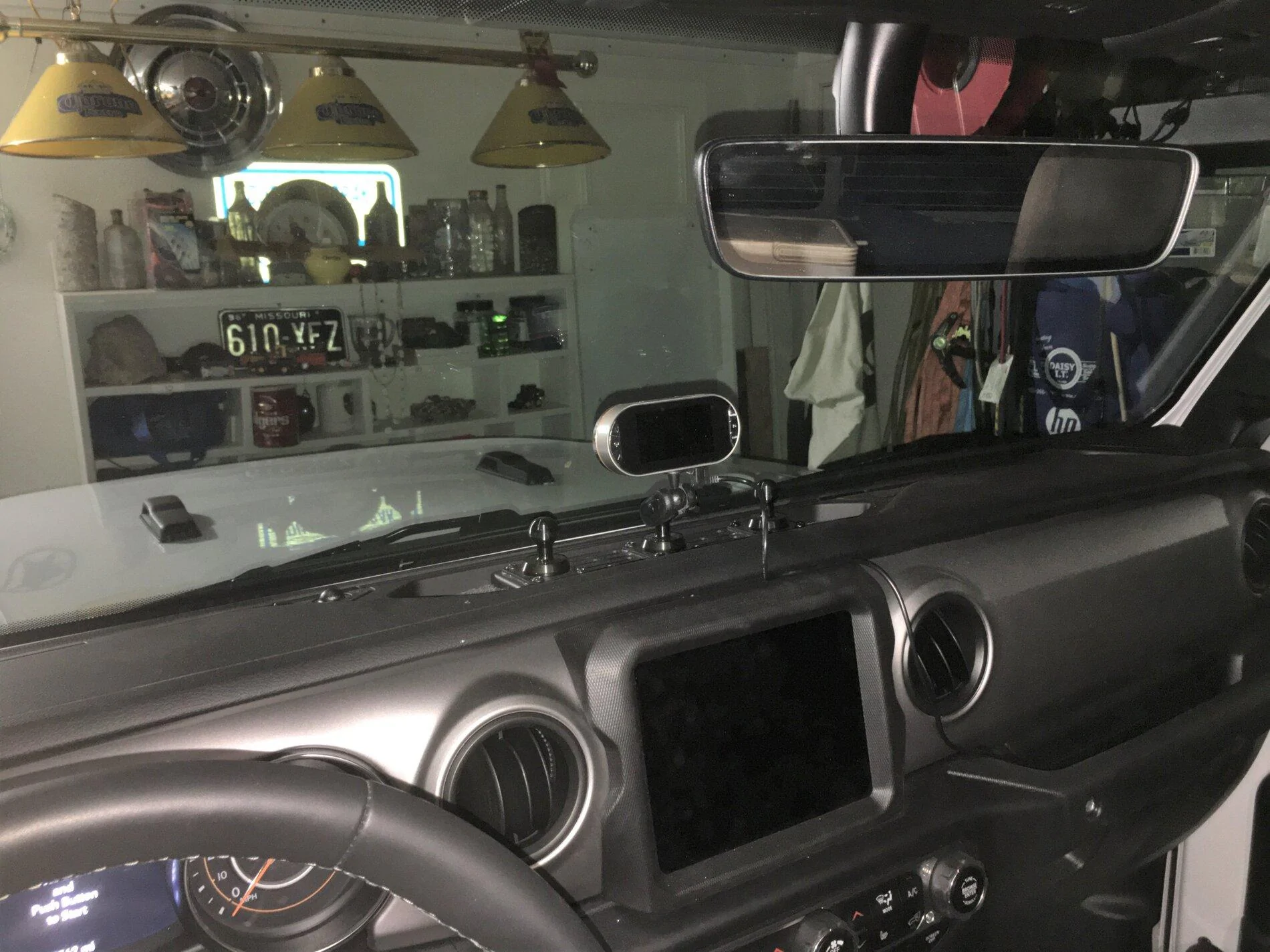

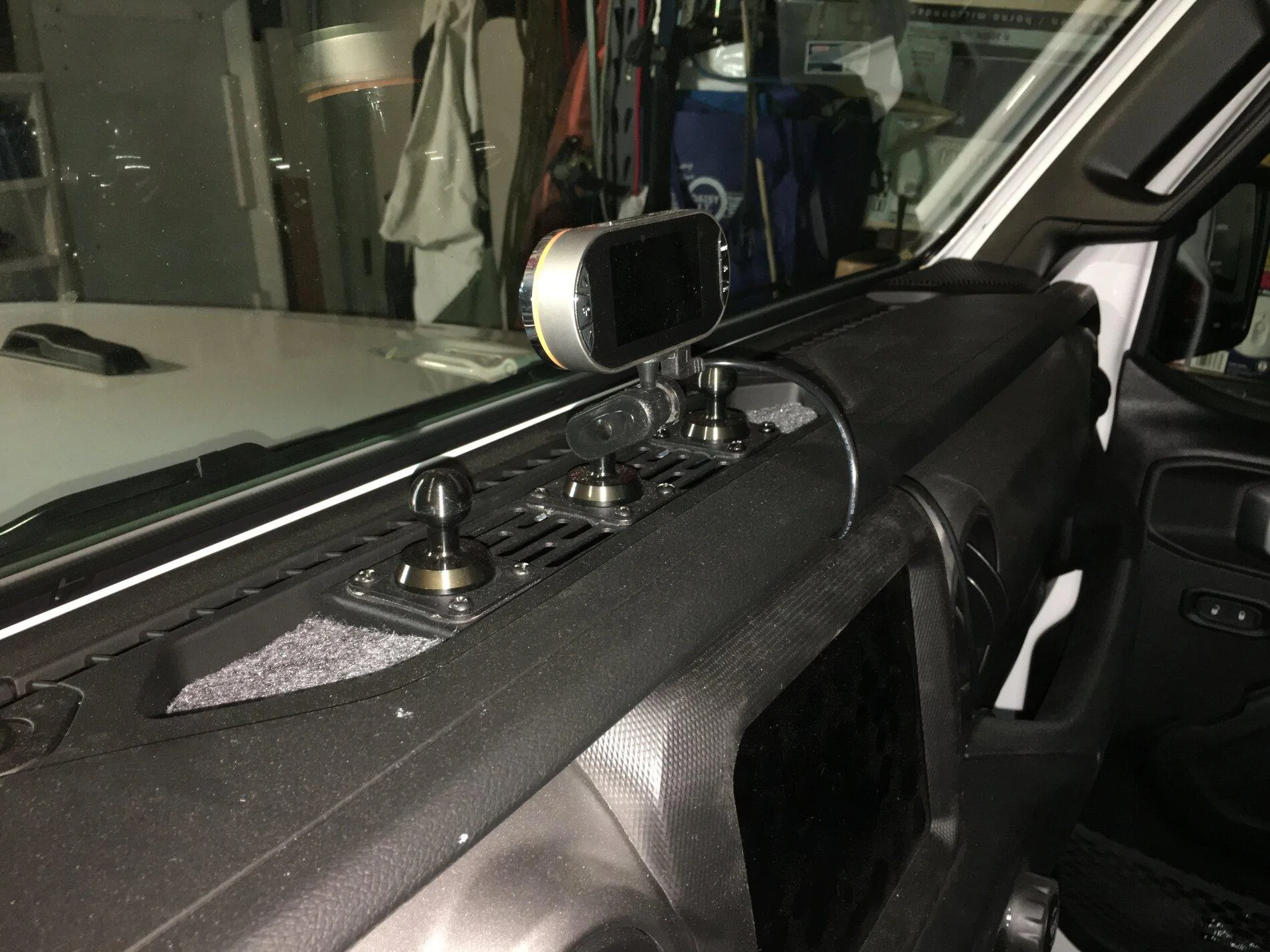

This is a work in progress but I like the concept. I used and like the bulletpoint Rubigrid dash mount. It is a very easy install and provides tablet, phone, camera mounting. In the pictures I have an old dash cam mounted that I am looking to replace but haven't decided on replacement yet. Also, the camera power wire I am still working on. My idea for the power wire is to run it up under the dash through a hole (to be drilled in mount location under the felt seen in picture). I have thoughts of installing auxiliary switches in the dash. These will go where factory auxiliary switches are located. When I install the switches I will run the camera power wire along with Apple and Galaxy cords through the hole (to be drilled) to the bulletpoint mount location.
Jeep Gladiator Dash camera? Dash cam insid
Jeep Gladiator Dash camera? dash cam felt

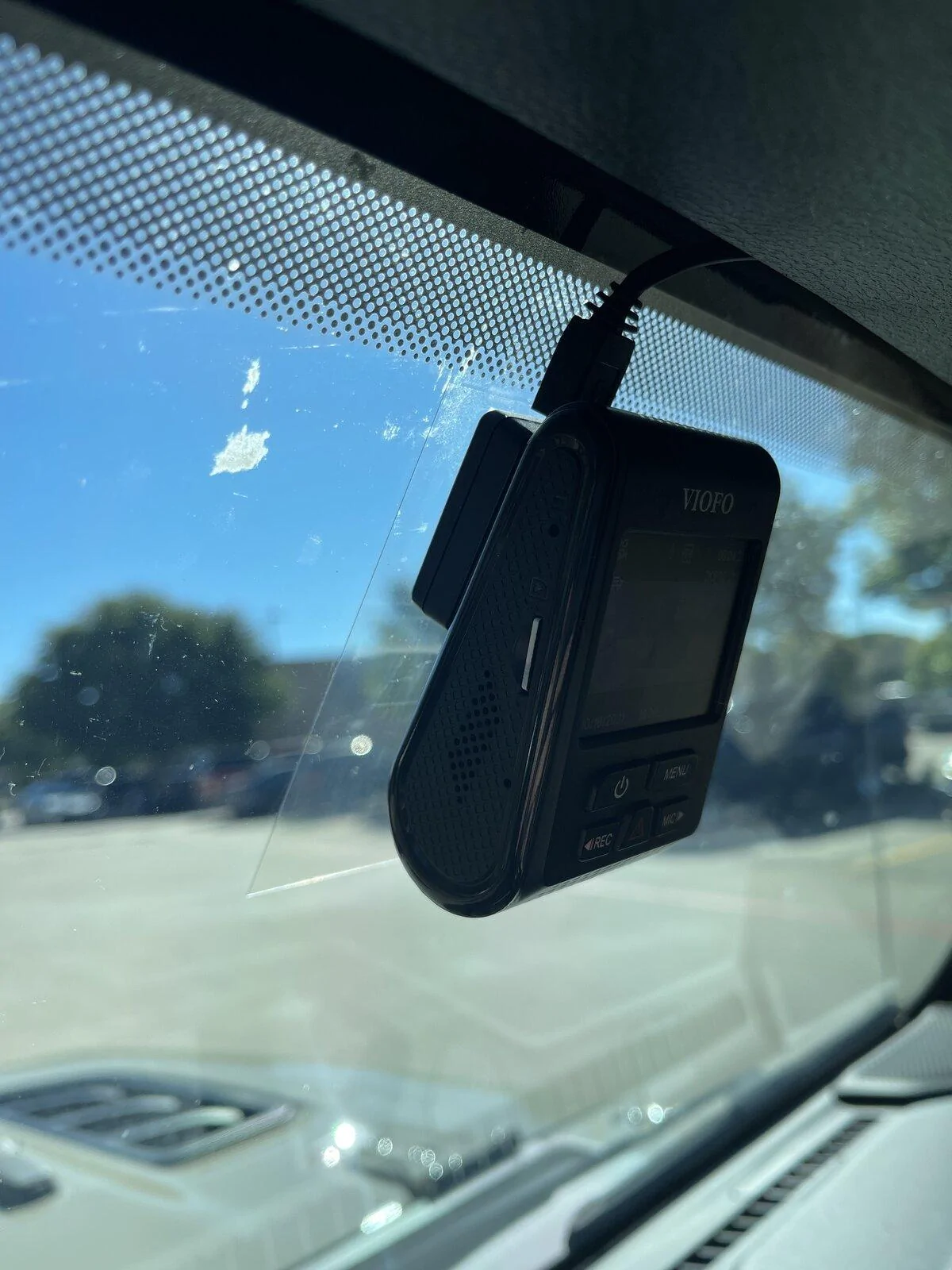

I have tint on my windshield as well. I put a square of static cling film on it, then attached the dash cam to the cling. It held for trails in Moab and Colorado. I probably should’ve cut the square smaller, but I just used it as the size it was.
Jeep Gladiator Dash camera? imag
