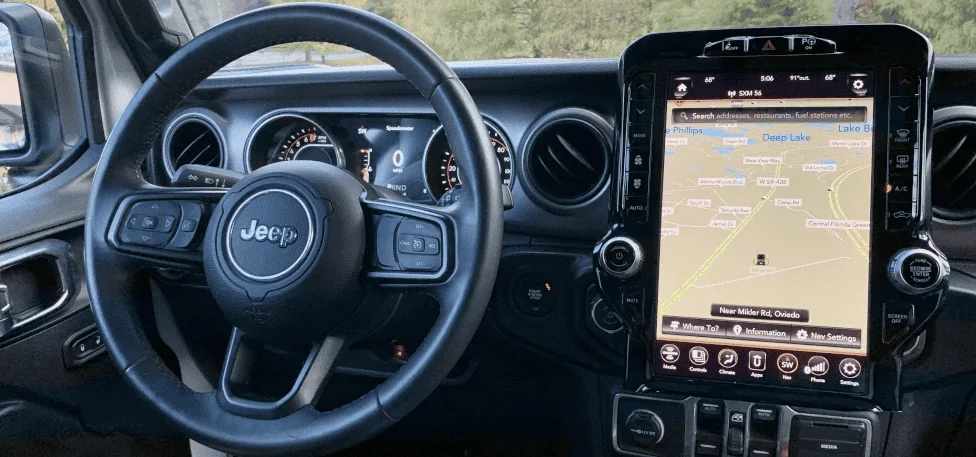

Have you seen the Insane Audio JL3001 or Stinger Offroad HEIGH10?

Thanks for the suggestions - I have looked at these two units, and while they are valid options, there's quite a few bad reviews out there, some of which are about sound quality. That makes sense, both these units do everything - for the price of them they can't be audiophile grade.

I have the Insane Audio unit and and very happy with it.
They can be a bit slow with updates but I have had it for a year now and they have worked with me directly on a few things to get them sorted out
Using the RCA pre outs the sound quality is excellent. The signal strength is adjustable and is clean & strong feeding my amps
The Stinger unit is a little bit bigger screen and from a few screen shots I've seen some of the menu interfaces look more refined but I have no personal experience with it

Stinger10 or Teyes CC3 both have a toslink port for a DSP. Sound quality problem solved
