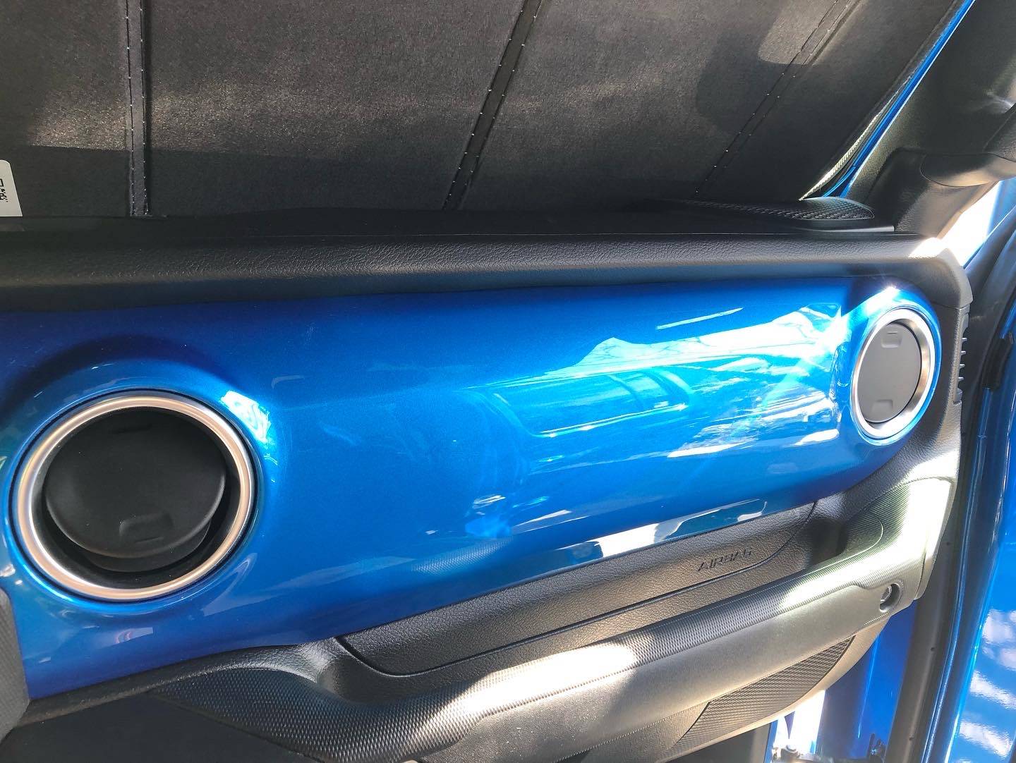

I hated the red plastic looking dash on my Gladiator. I went to Distinction Applied, https://www.distinctionapplied.com/product-page/custom-dash-panels
It was pretty easy, just take your time, and follow the video, make sure you remove the secondary battery connection and check it, because that is what controls the air bag. But not a difficult project, and the results we awesome, every time I get in my Jeep. Basically you go online, order the color you want, they ship them to you, you swap them out, ship the old ones back to them and they give you a credit. Like I said, not really that difficult, just take you time and follow along on the video.

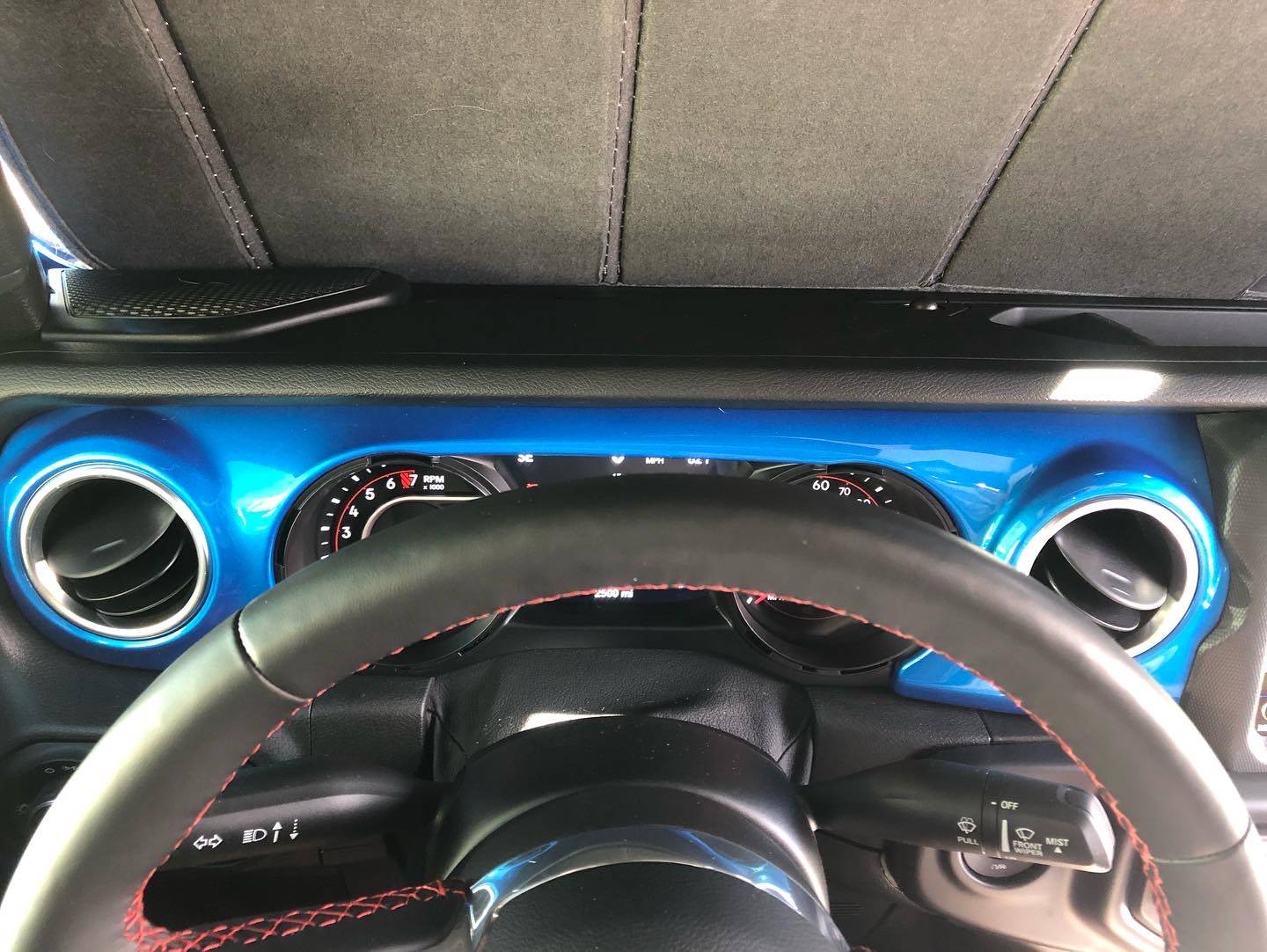

another vote for Distinction Applied. great bunch of guys and easy to do business with.
my wife kids and says "we must be putting one of their kids thru college."
changed out the vent & dash colors on the Mojave. looks much better IMO.
