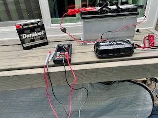

Adventures in batteries continues. I bought a couple batteries today and am charging them up, as the forum has recommended, before dropping them in. I've learned a bit about battery chargers/maintainers as well as multimeters! So that's something.

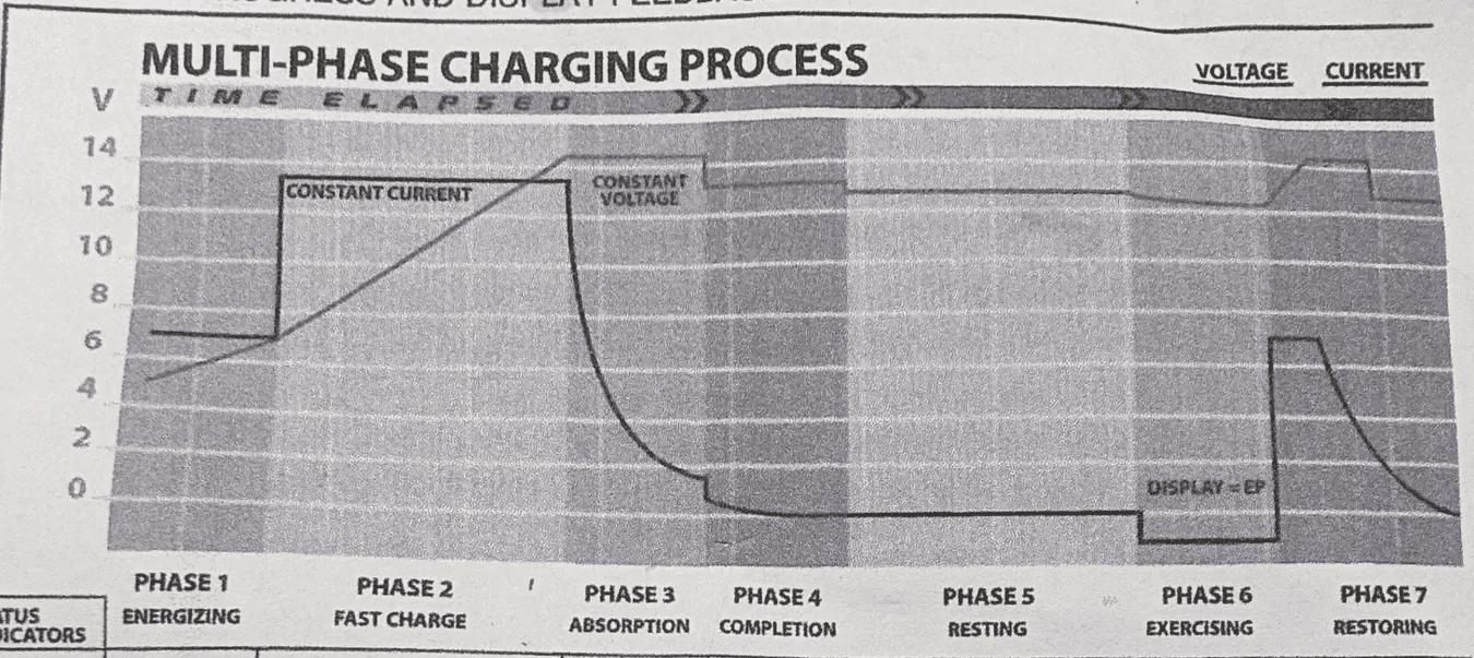

Unless the new batteries are very dead, extremely low, a good charger putting out 10 to 20 amps should charge a battery overnight.
I've had it take a full day to do both of mine in the vehicle, still connected in parallel.
A small charger is going to take longer. It should go through roughly 4 phases, including one at constant voltage and another at constant amperage.

I have the Noco 10amp charger and it's set to AGM. Its indicator is pulsing green which means the battery is or is near 100% charge. It will go solid once it's completed. As soon as I connected the charger to it the new H7 battery it went fairly quickly up to pulsing green so it's in a pretty good state.
I'm a little more concerned about the new H14 aux as it has a build date of 08/23 but the multimeter has it at 12.6. Last one they had.

Just keep them on the charger until the light is solid. It takes a few days sometimes with my NOCO charger. I figure it’s just cause of all the phases it goes through.

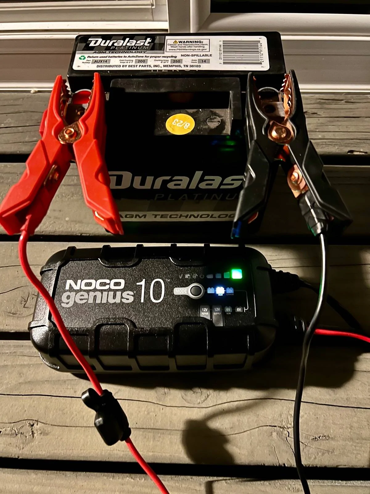

So, the main H7 battery is now fully charged and the Noco 10 went into maintenance mode so it’s done. However the AUX14 I tried putting the clamps on the blocks around where the + and - posts would be but it’s not getting a good reading. What bolt size do I need to go buy to use the posts? I need to leave the current AUX battery alone so I can drive until the new one is fully charged. Can these even be purchased? I’m striking out on my google-fu for this particular issue.

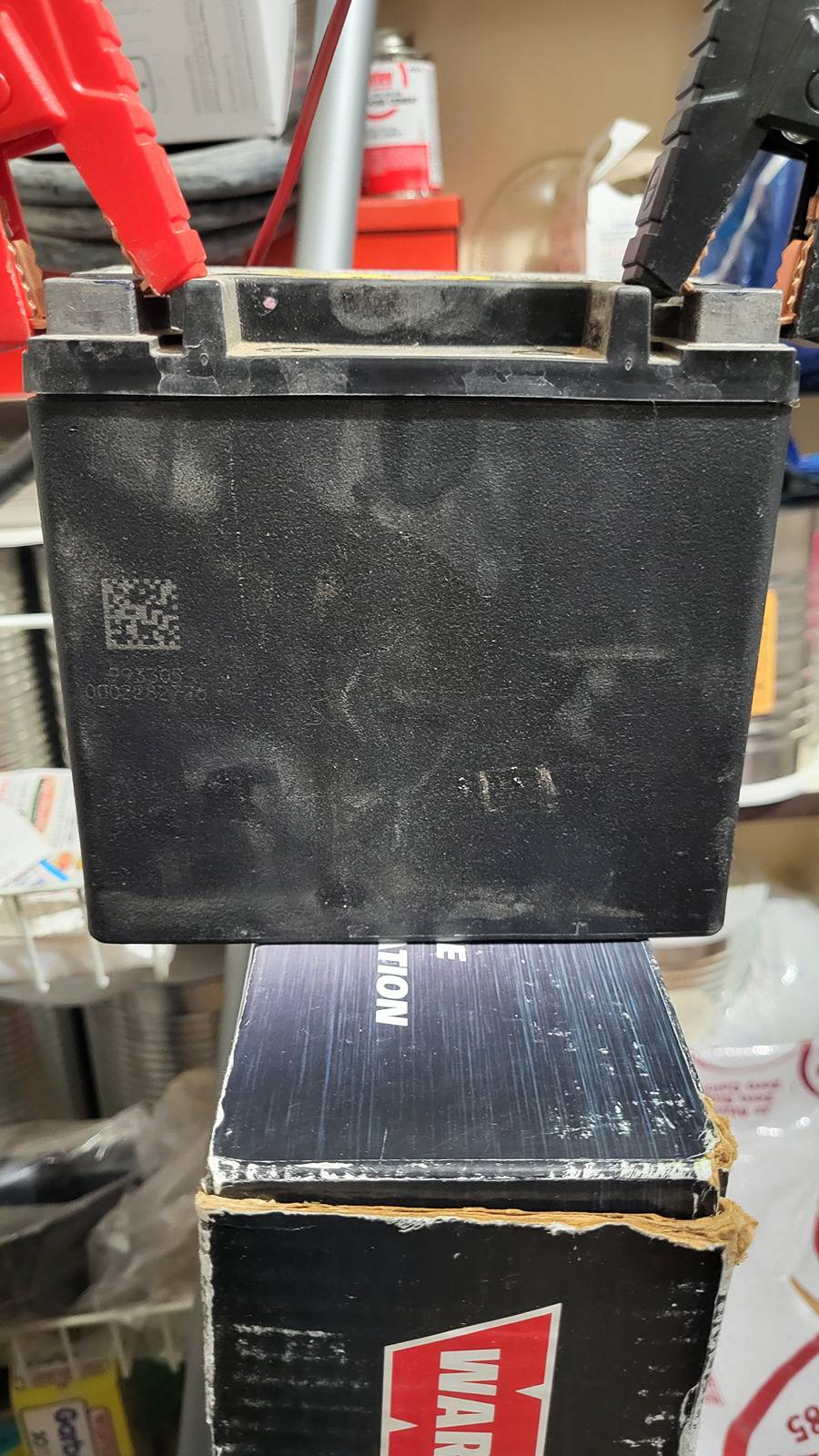

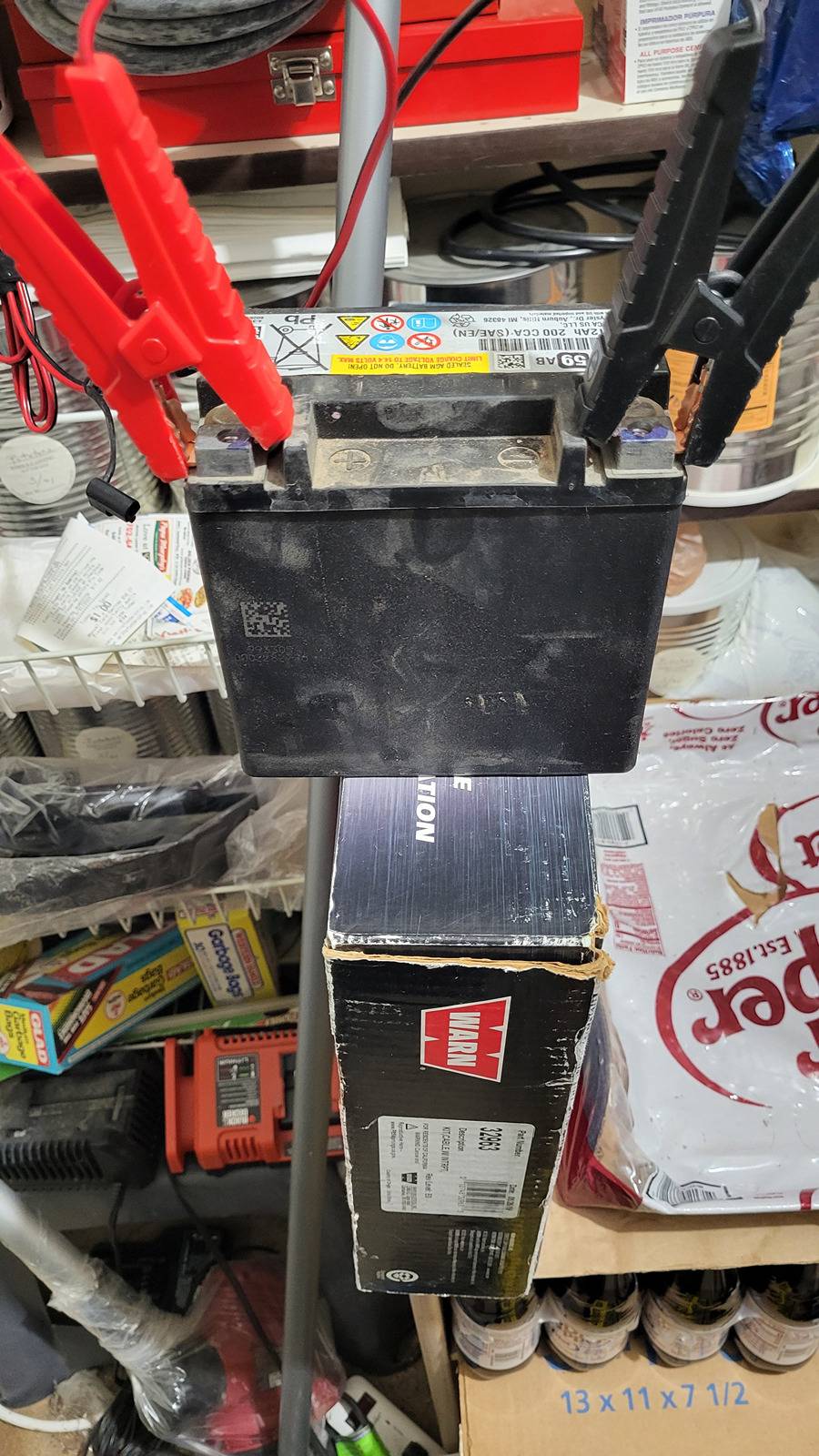

You don't need bolts in the posts to charge the battery. It does take some effort to get the clamps attached in a good position. You can insert any bolt with the correct thread size and pattern to attach to for charging. I suppose that not all chargers will have clamps that open wide enough to work easily.
They are barely on there, but this works for me.
Thanks for the late night reply @Mr._Bill. I was able to get the clamps on in a position where the battery registered to the Noco 10 charger. It shows fully charged and running in maintenance mode but I’ll let it go overnight. The multimeter had it at 12.6 volts before I hooked it up.

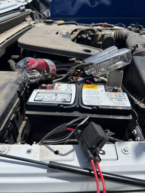

I used the [Banned Site] video for replacing batteries as a reference as I went through the fuse box (I wish I owned a cordless ratchet tool).
I had a few modifications to it based on forum feedback and having to manage my winch and air compressor wiring/connections.
I removed the starter battery and disassembled the negative wiring to reset the IBS.
Jeep Gladiator Dealership Battery Replacement Cost? IMG_1943
I used some plastic bottles over each negative wire and the positive wire bundle. Thanks to @Mr._Bill for the suggestions. The negative wires were sparking a little when touching each other briefly while moving cables around until I could get the bottles on them. ⚡

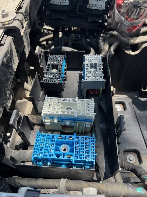

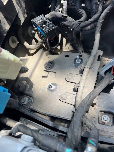

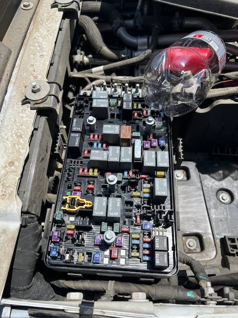

Removed screws from fuse box and lifted fuse box but all the connectors came with it. This took a bit of time to get them disconnected from underneath but not too bad. Just used a screw driver for leverage to remove them from the connections. Just went easy.
Jeep Gladiator Dealership Battery Replacement Cost? IMG_1945
Once the fuse box connectors were removed I took note of how they are positioned and the wiring is ran:
Jeep Gladiator Dealership Battery Replacement Cost? IMG_1946
Groomed the wiring out of the way and lifted the fuse box up and out of the way with a bungie cord.

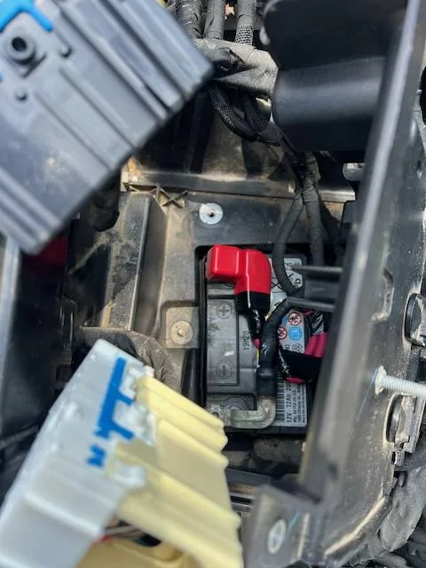

Removed the auxiliary battery cover to gain access to the battery itself.
Jeep Gladiator Dealership Battery Replacement Cost? IMG_1947
You're now able to get at the auxiliary battery.
Jeep Gladiator Dealership Battery Replacement Cost? IMG_1948
Remove the battery connections and your system is finally dead. From here on out it's just reversing this process to complete the replacement of both batteries!

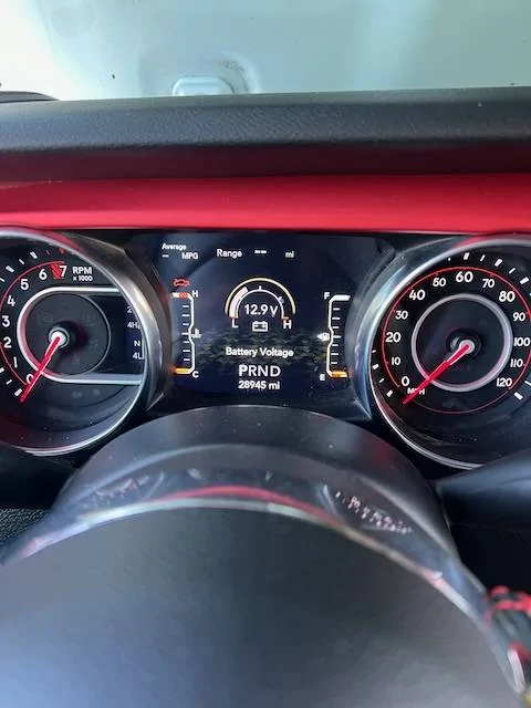

One more curiosity. On my way to Overland Expo West today I noticed the battery voltage meter in the truck isn’t showing the typical 14.something volts when the engine is running. It’s in the 12.6 - 12.7 range. I assume if something was wrong my batteries would have died on the ~500 miles here.
is this due to the IBS reset still trying to figure things out?
Mr._Bill
Jul 22, 2019
6,667
7,808
North Las Vegas, NV
That's about normal for fully charged batteries. You should see it jump to 13.x or 14.x when it first starts, but then drop back down to the 12.8 range. The IBS will take a little time to learn. Keep an eye on it, but don't get too worried as long as everything appears to be working like it should.
