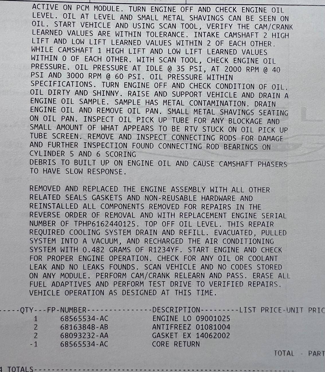

So today I got this from my service rep
“Alrighty - so not the greatest news. But we checked the oil and there was a lot of metal in the pan, which means that it has contaminated the system. This is causing the actuators to not properly function, and trigger the check engine light. At this time, tech would like to replace the engine. We can get that done by the end of the week next week, Friday 7/26 at the latest. Luckily, we have access to an engine quickly. Of course, all of this is covered under warranty too. “
Holy crappola. Looks like I’m getting a new engine.
I think my first question after the engine replacement is how does this problem occur and what can be done to avoid it.

I just picked it up on Thursday.
As it turns out when they took the pan off and looked at the oil pickup tube there was RTV clogging the screen that reduced the oil flow enough to scrape the camshaft. I call that a random factory defect.
Here’s a pic of the tech’s notes on the work order.
Jeep Gladiator Did I just join the misfire club? Yes I did! IMG_1886
I'm now in the breakin period and will go overboard with the breakin, I.e., for the 60 mile initial light driving I’m going 100 and for the 300 mile breakin I’m going 500 and will change the oil somewhere between 500 and 1000 miles.
Thank you. That's refreshing to read. It truly was just one of those freak things, and nothing to do with the engine design.
You’re welcome.
I said the same thing.
It was good to see the analysis on the work order and that it was a fluke.
I’m glad they found it.
