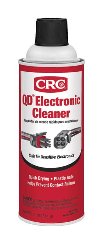

This is the stuff that you want to use to clean the connector. Spray thoroughly before unplugging it, then unplug and spray both sides until clean. Let it dry (it dries quick) before plugging back together.
