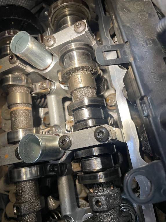

Same thing happened to me at 68K miles with my 2020 Gladiator. I bought it Oct. 2019. Same exact symptoms. The passenger side intake cam (high lift lobs) and rockers were toast. totally wore out. The exhaust cam and rockers were fine. How was your driver's side intake cam ? I have not checked mine, and my truck is running great again with the new intake cam and rockers on the passenger side. I am worried the other side may have the same problem..... Thanks in advance for any info.

why : how would a mechanical issue manifest itself and then completely disappear?
hjdca
Oct 27, 2019
1,733
2,494
Southern California Mountains
All the error codes and misfires were only the passenger side head, intake cam. The intake cam and rockers were replaced and the engine is running fine again. It is a whole other job to remove the intake and the driver's side valve cover to inspect the driver's side intake cam.... Since, I have no known issues on the Drivers side, I have not uncovered that valve cover to take a peak... So, I was wondering if anyone had the same issue on the Drivers side head.

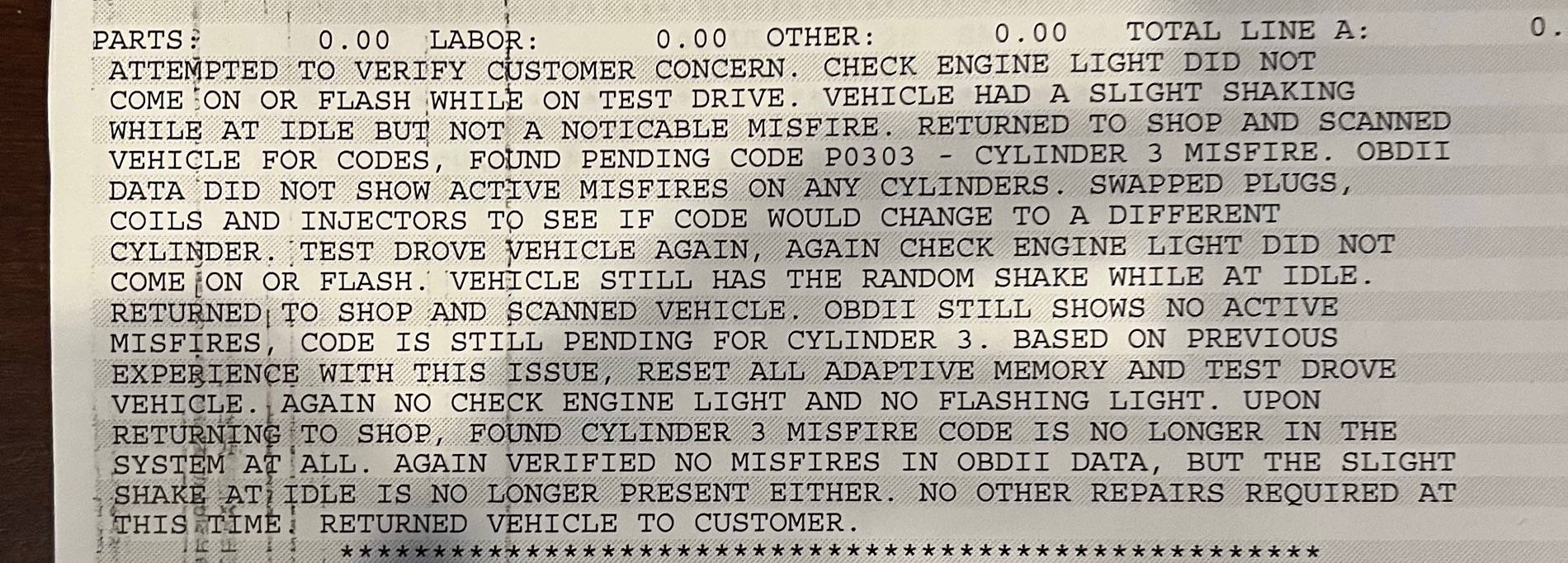

Update:
Jeep Gladiator Did I just join the misfire club? Yes I did! IMG_5017

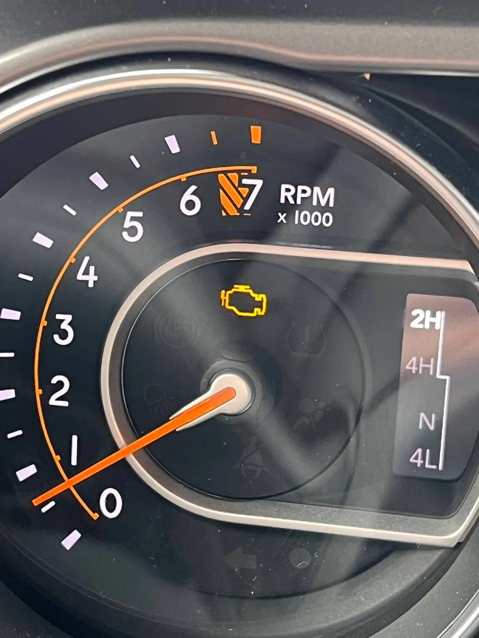

Update to the update.
That didn’t last long.
Jeep Gladiator Did I just join the misfire club? Yes I did! IMG_5019

The adaptive memory reset was a Hail Mary pass. I probably would have done the same but knowing it was 50/50 at best of being solved.
I think it was 2021 when they redid the PCM programming to make the misfire detection recording more tolerant (more misfires) before setting the CEL. My speculation is the adaptive memory reset just bought a bit of time but the caseation is still there.
The #3 is the right passenger side bank. Should not be that much trouble for them to pop the valve covers and take a look.

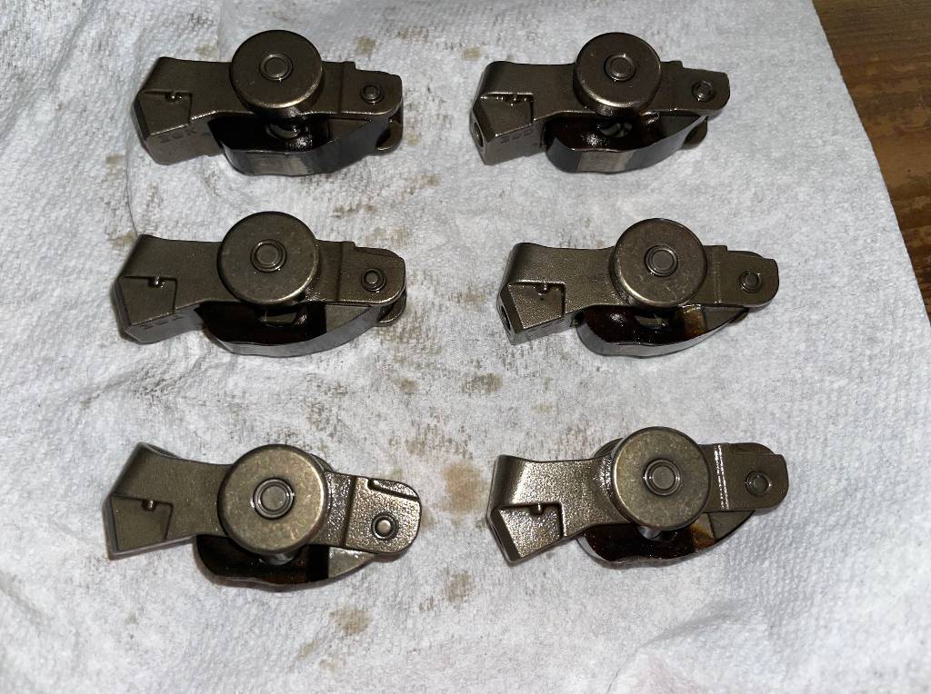

Update number 3.
picked up the gladiator today. They replaced the passenger side intake rockers and camshaft. This is a 2021 (ordered in August, built in October) with just under 30k on the odometer.
I don’t really know what to do with it now. I guess I still have about half of the powertrain warranty left so maybe I’ll just drive it and cross my fingers.
