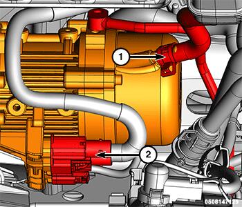

I do not know what PSC is talking about. Maybe this will help, you can look at the pump you have . It is mounted on the pass frame rail.
According to the Service Manual: 2023 JT 3.6
Jeep Gladiator Difference between Electric Power Steering and EHPS Pump 1737569022834-8h
Open In New Tab Zoom/Print
1 – Supply Line
2 – Wire Harness Connector
  1. Disconnect and isolate the negative battery cable(s) (Refer to 08 - Electrical/Battery System/Standard Procedure) .
  2. Remove the air cleaner body (Refer to 09 - Engine/Air Intake System/BODY, Air Cleaner/Removal and Installation) .
  3. Disconnect the two Electric Hydraulic Power Steering (EHPS) pump wire harness connectors and remove the wiring harness routing clips from the EHPS pump.
  4. With the hose clamp released disconnect the supply line from the EHPS pump and secure the hose end higher than the power steering pump reservoir.
  5. Raise and support the vehicle (Refer to 04 - Vehicle Quick Reference/Hoisting/Standard Procedure) .
  6. Remove the right front wheel house splash shield (Refer to 23 - Body/Exterior/SHIELD, Splash/Removal and Installation) .
