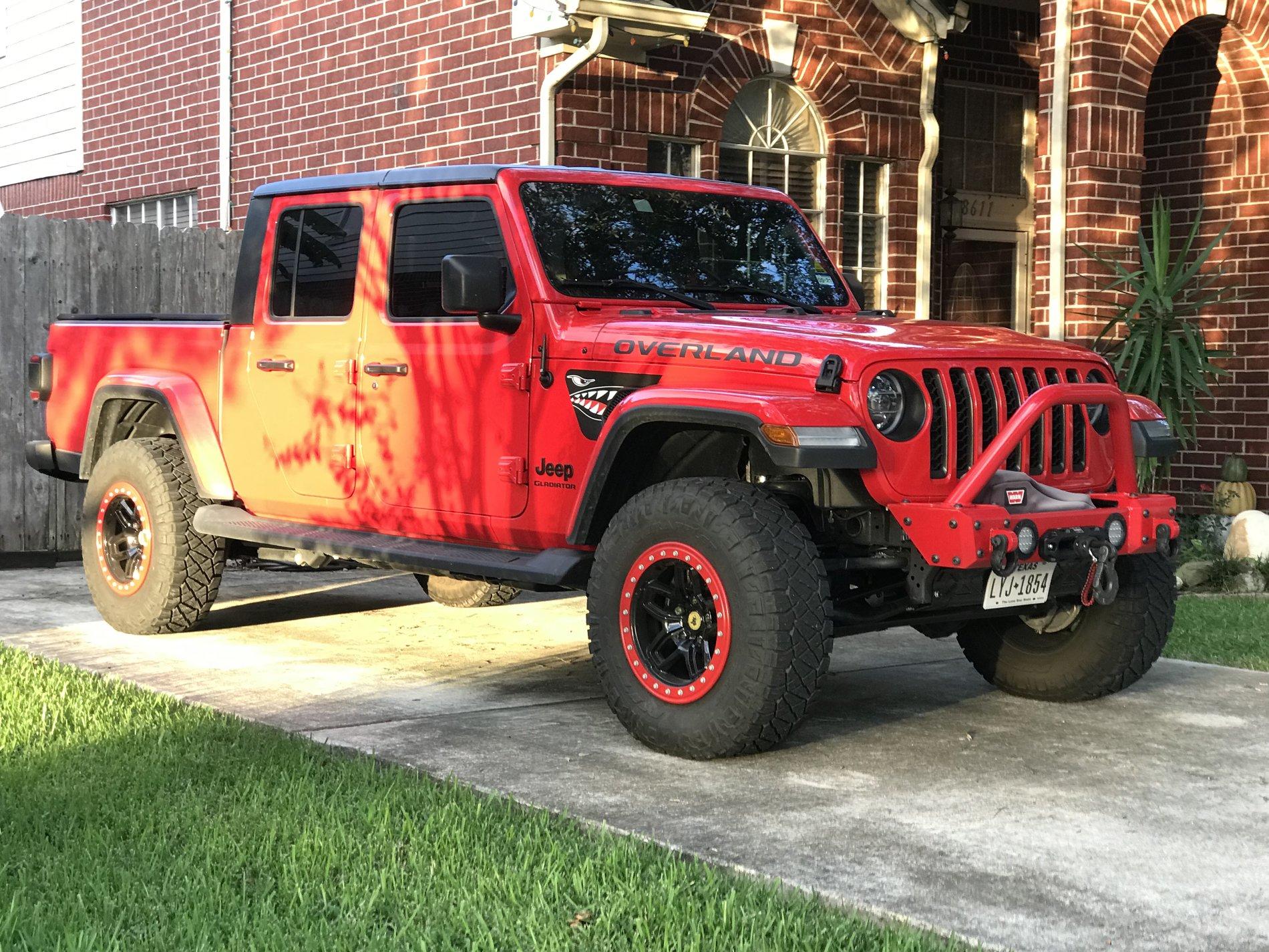

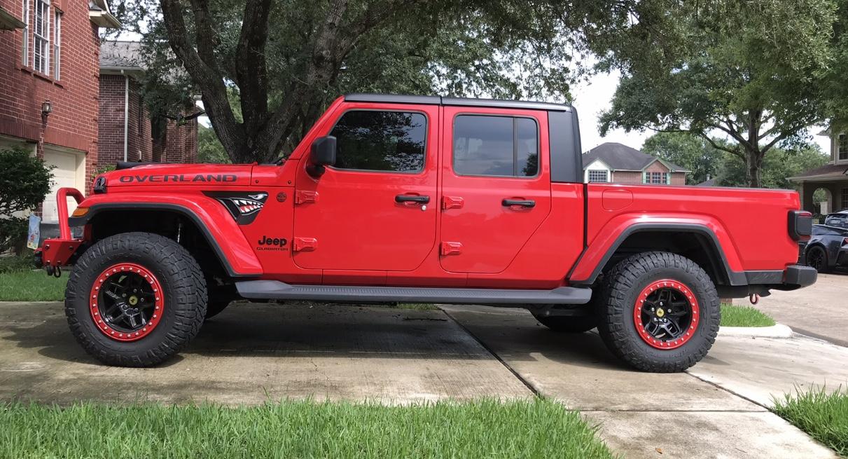

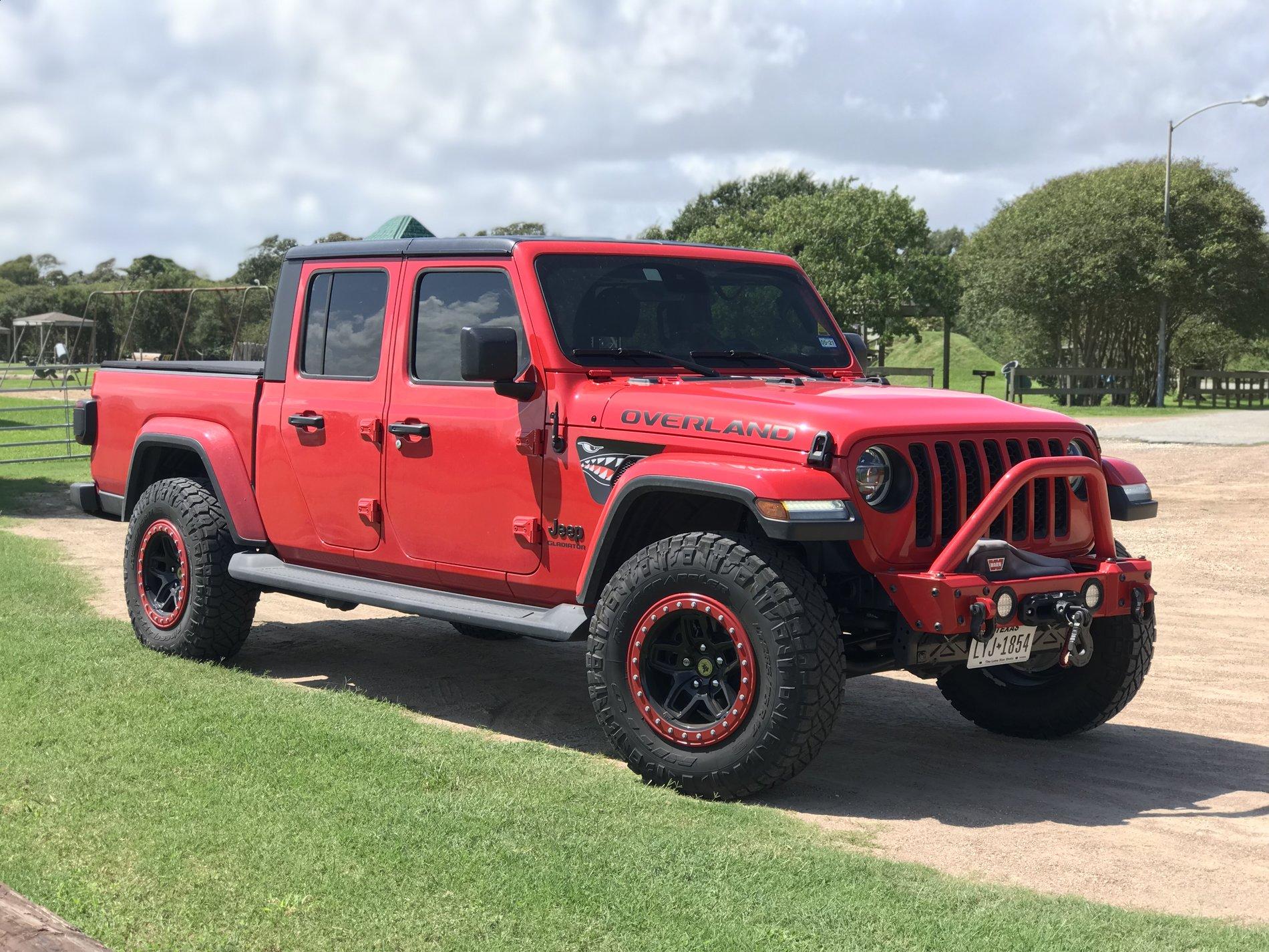

Today i rotated my tires passed due 5,000K on it now. While i was at it i swapped in Rubicon suspension along with my alloy USA level kit 1 1/2” front but added 1/2” factory isolator because i lost 1/2” with front bumper & winch. Also added a 3/4” spacer for rear. Sitting better i tow a camper so i can’t go 37” & a big lift. So I’m happy with this set up. I was too tired to measure height difference but looks like an inch higher or maybe a little more. I only drove it down the street & back so I’ll see about ride difference later.

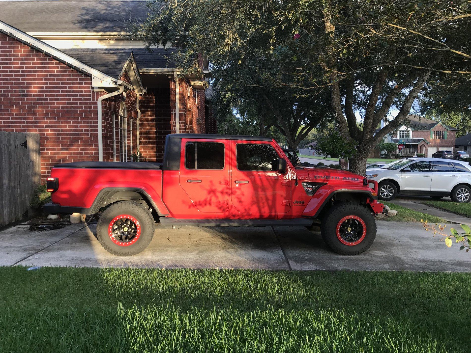

Before the Rubicon suspension & added 1/2” front 3/4” rear spacers.
