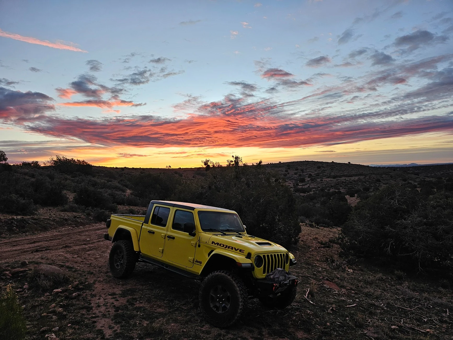

Triangulated 4 link rear to eliminate the side to side head toss hitting bumps at speed. You could get away with 2" of lift if you were never going to run rocky trails. Since we do run rocky trails and freeway speeds in the desert I ended up in 3.5" of lift and 37s. Widened the stance by about 4" total. Front geometry correction brackets to flatten out the control arms for better bump absorption. And flipped the drag link for better steering angles. Works great as is now. The only way I see making it much better would be ADS triple bypass shocks, but not ready to drop another $6k just yet.

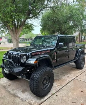

3.5" clayton, falcon adjustable piggybacks, 4:88s and 37s Glad I did. FWIT, I waited for 40K miles.
