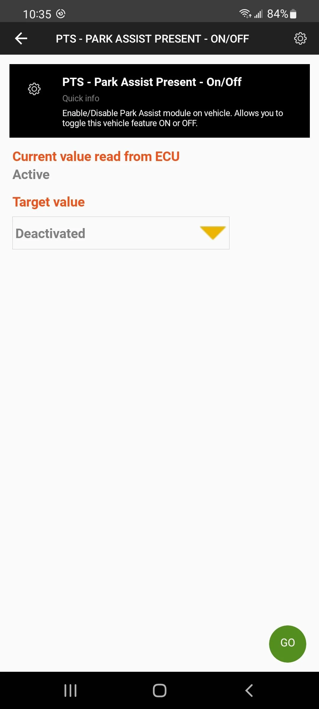

Park Assist can be disabled with Jscan app.
Tazer too.
If the sensors are disconnected, there won't be anything for them to beep at, but maybe the graphics will change in the center dash to not have the distance gauge.

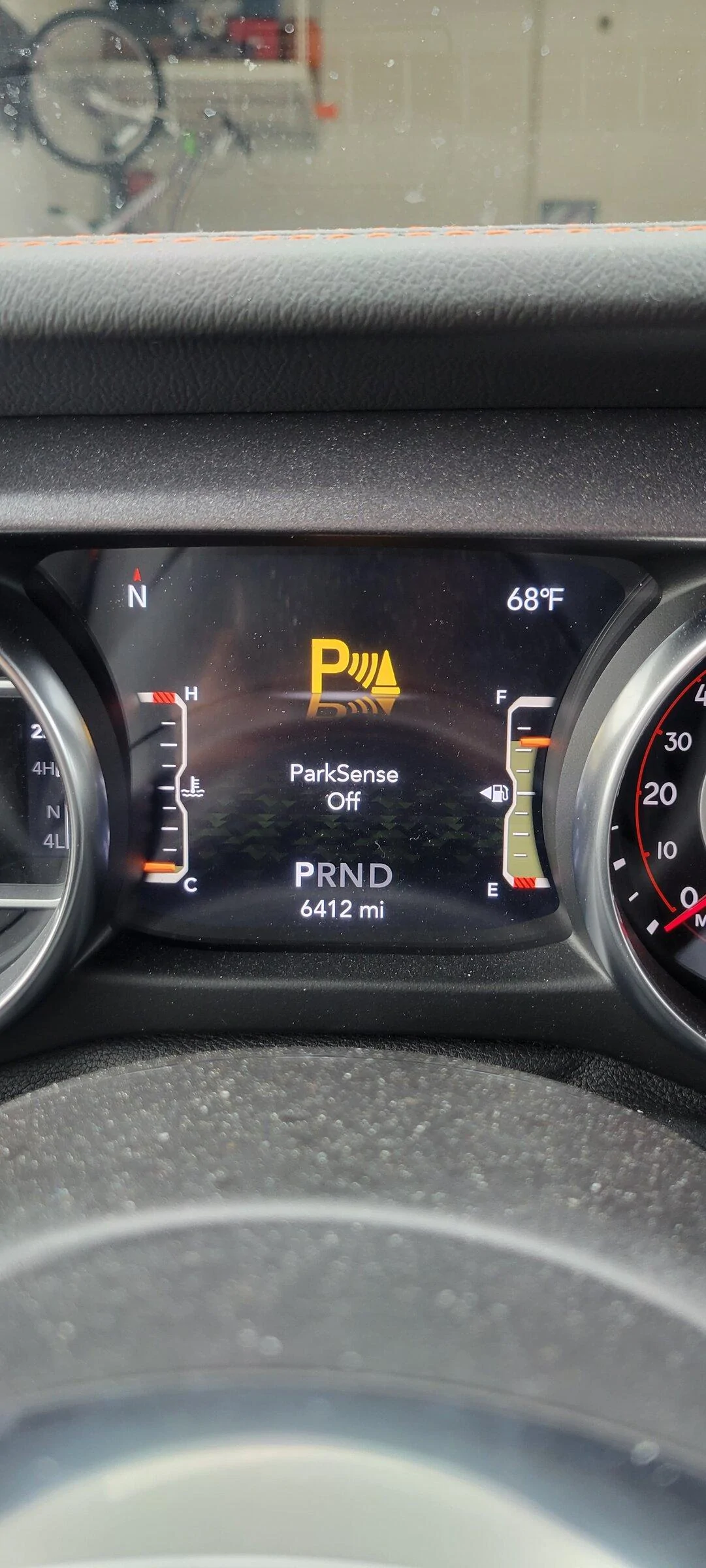

Well, for posterity if anyone else tries this, you get an error on ignition about ParkSense not available, and service being required.
I had an OBD plug to use with JScan ready, but apparently I need another security bypass plug, and I have to plug the OBD Bluetooth into THAT thing.
$45 to make a stupid error code go away. Ugh.
Hootbro
Apr 13, 2019
10,219
20,041
2025 Gladiator Sport
Still a good bit of kit to have for anything else later. I have messed around with my setup enough to be able to remove and connect the security gateway bypass adapter cable just by feel without having to take the knee bolster panel off.
So, I deactivated that (JScan, SGW bypass cable, and OBD bluetooth dongle), and I'm still getting this error when I start up. Is there something else I need to disable?
Isn't that telling you it's deactivated?
kooltoys
Tony
Dec 19, 2020
432
288
Central Florida
21 JTD, 90 300zx TT, 07 Nightrain, MB 3.0L Diesel
AV Design/Programming
from the pattern I have noticed is that each feature has 2 setting, one to make show up in uconnect? and one to actually enable the feature to work.. But hey what in the hell do I know?!?!?!? I just touch wires tell something happens!
