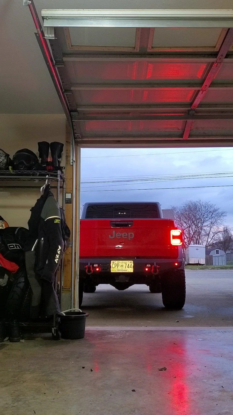

I can't speak for plugs, but 3/4" grommets and 3/4" marker lights did the trick for me on my aftermarket bumper. I don't have sensors, but didn't want to waste the space, so I installed these as accessory brake/turn signals. This bumper is made to accommodate the factory sensors, so I would imagine a 3/4" plug should do the trick.

@TheHops Looks really cool, but I'd black out your plates and then repost the pic... personally. Just a thought, some people may not mind.
Thanks!
Yeah, I couldn't care less honestly haha. Been doing it for years. I'd be much more concerned about whoever takes the time to try to pull my information in order to trespass.
I do appreciate it though!
