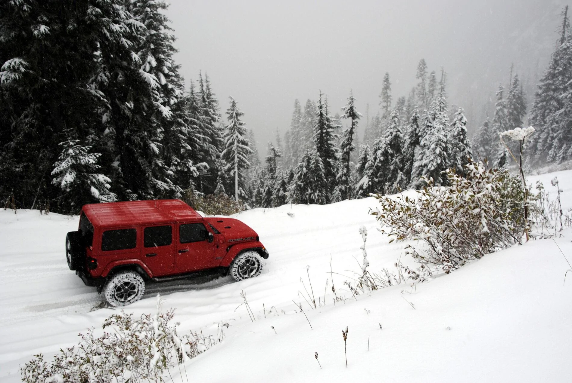

If a Subaru Outback is your frame of reference, the closest setup to that on a JL/JT would be Select-Trac + rear LSD. This provides maximum traction on snowy/ slushy/ slippery road conditions. This is the setup I have on my JL; it is truly seamless and virtually unstoppable in winter conditions.
I believe you can add a rear LSD only on Sport S, Willys and Overland trims, but I could be wrong.
My Wrangler Sahara —equivalent to Overland— with Selec-Trac, rear LSD and ATs
Jeep Gladiator To Select-Trac or not?--Found one without it for a steal... 29D3D175-83AC-4EFF-9F66-F91DC46AD36B
