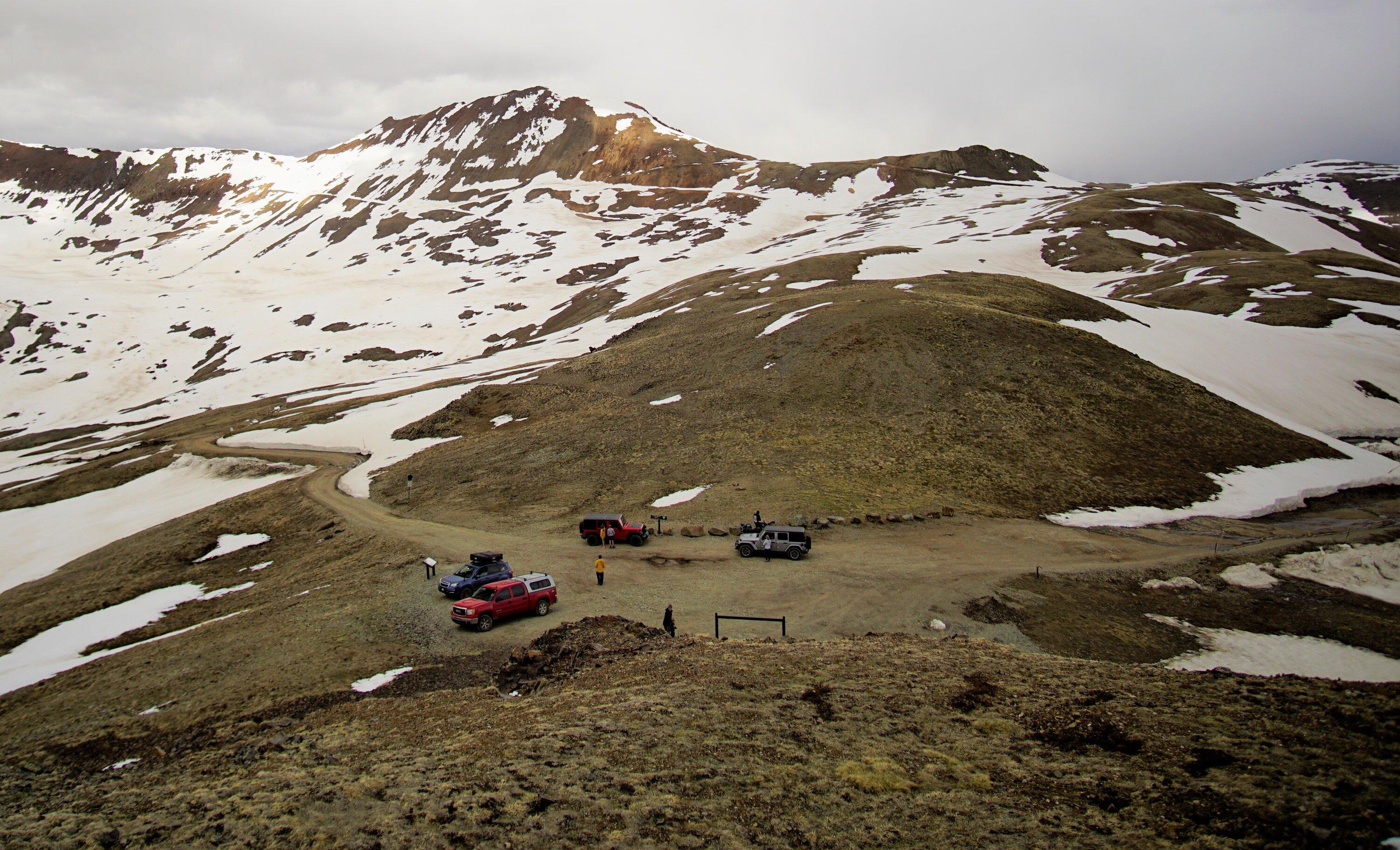

Here is a shot of the old girl in jeep territory at the top of cinnamon. That trail seemed to be about the limit with lack of power being the main issue. I had to slip the clutch coming up from Animas Forks and was wishing I had a low range something fierce.

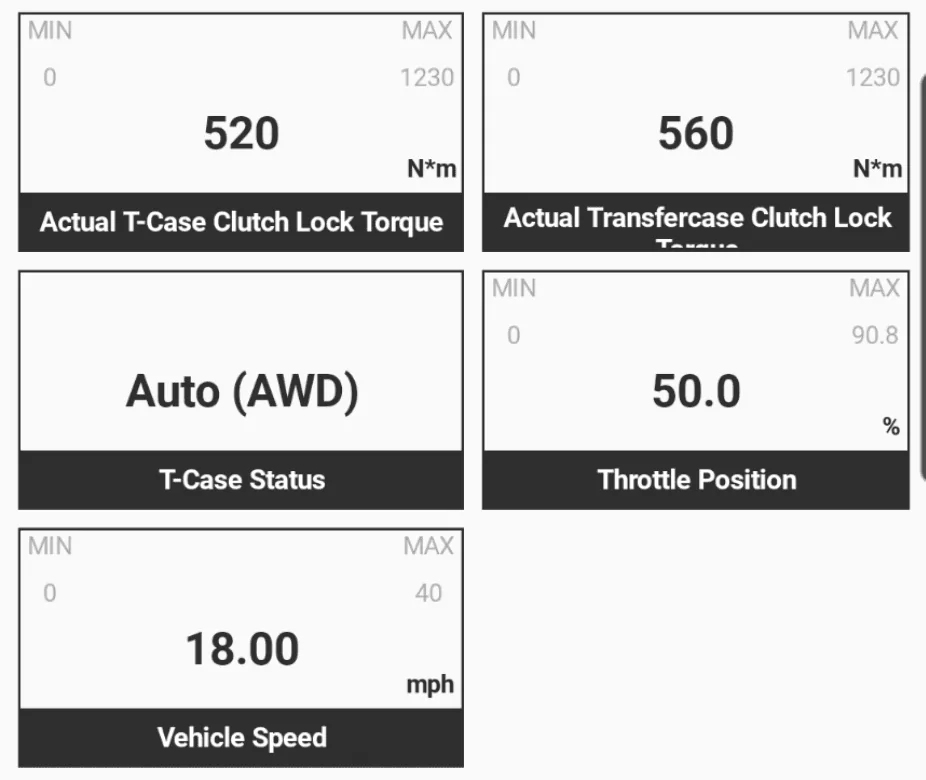

Yes, it must be connected any time you are in 4HA because the clutches are applied at times you'd never expect - such as when sitting at a stop light. Then as you apply throttle, the clutches relax until a certain throttle percentage is reached.
Jeep Gladiator Loving select-trac! 1695066635480

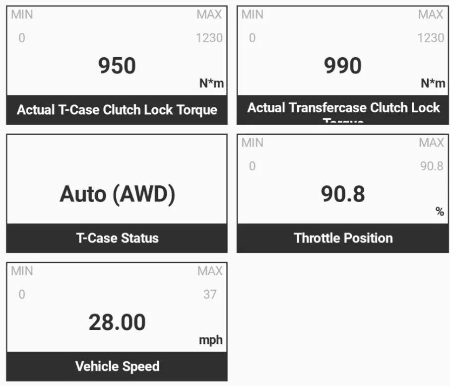

Also, if you start off, then nail it, wheel slip or not, there's heavy t-case clutch application -
Jeep Gladiator Loving select-trac! 1695066542367
