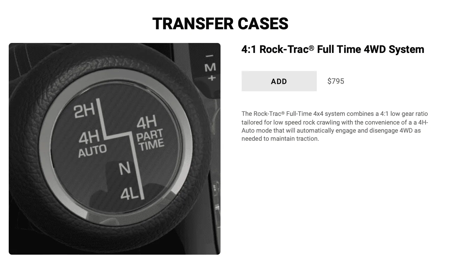

The Selec-trac for the Rubicon is listed as "4:1 Rock-Trac Full Time 4WD System" on my window sticker.
Yes, they have added the option to Rock-trac of the full-time automatic system.
Still, it's different.
You can, and would have, Rock-trac on your Rubicon even if you didn't order it with that full time option.
All Gladiator Rubicons have Rock-trac, even before Selec-trac was even a thing on Gladiator.
But not all Gladiator Rubicons have the full time system.
Even if it does, it's different as it's a different transfer case ratio and technically, Rock-trac has locking differentials.

So I guess the right way to say it is that Rock-Trac Full Time 4WD is the same as Selec-Trac.
The only exception being that the Rubicon's transfer case is 4:1 and everything else is 2.6:1 (I think that's the ratio) in low range.
So in 4H Auto, there is no difference between Selec-Trac and Rock-Track Full Time 4wd.
............ in the fact they both have a full time auto mode.
Otherwise, still different transfer cases and the Rock-trac has lockers and the lower ratio 4L
It's closer, anyway, in that they both have that full time mode.
Part Time is so misleading. If the selector is there, it's Full Time. Lol. Auto is more Part Time.
