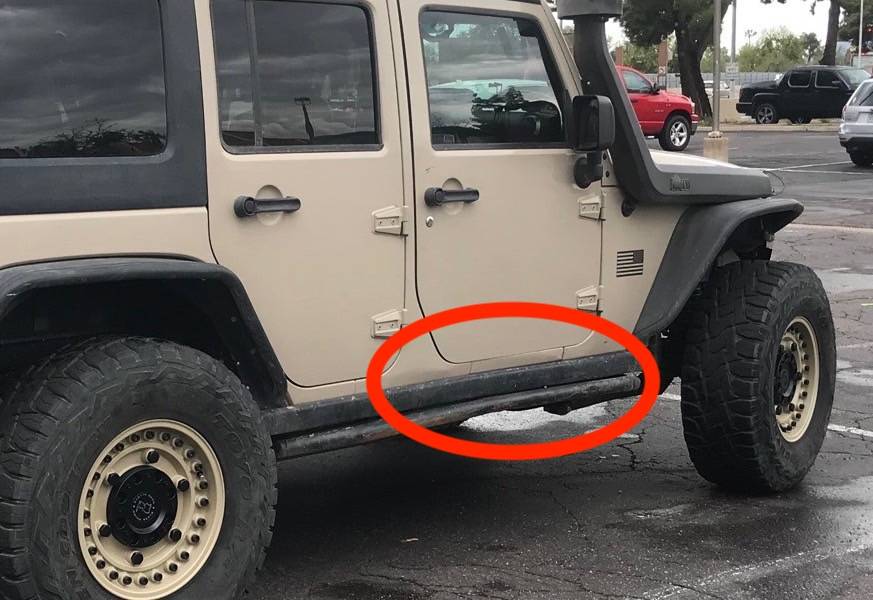

Just a friendly warning about those Ace sliders: The ACE sliders mount using the body mount bolts. Between where they mount and the frame are BIG rubber bushings designed to accommodate the frame flex and not transmit to the tub. This means that if you come down hard on that slider, it will flex upwards, compressing the bushings and striking the tub. You can see the buckled tub in the pic. It also changed the door gaps all the way around the door...
Jeep Gladiator Do ACE Rock Sliders Interfere with RokBlokz 1719340154180-g1
I am grateful it is on the passenger side so that I don’t have to be reminded every time I get in the Jeep.
Just a cautionary tale…
