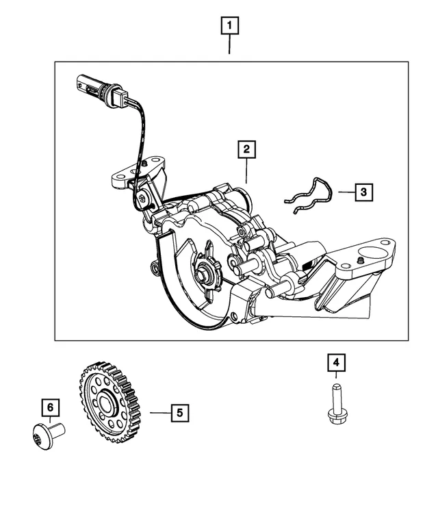

The oil pump only ramps up at 3000 rpm because that's when the oil squirters kick on for piston cooling. That's the only time it needs the added volume.

the oil pump is NOT two speed. it's variable displacement. It's driven off the crank (chain drive)
It kicks into high volume at 3,000 RPM, not 3500 rpm (right there that tells me no one knows what they are talking about - two speed? 3500 rpm?)
Unless the PUG is different, those jets are in the main gallery........ and thus oil all the time. Granted, you need MORE squirt, more oil volume at higher RPM, but.........
So you are suggesting the piston jets are turned off at below 3,000 RPM? Makes little sense as you can generate a heck of a lot of piston heat at lower RPM, high load.

That's how I understand it. I've looked for a solenoid or something, maybe it's integral to the oil pump assembly (which has an electrical connector on it)? Or maybe a vane or reed valve that opens at 3k? I'm not saying it makes sense, but if they are trying to meet CAFE standards by reducing internal drag / resistance within the operating range the engine spends 90% of its' time, maybe? This came from a recycler on YouTube who makes videos of failed engines and disassembles them to determine cause of failure. It made a lot of sense to me. He was comparing the Pentastar to the Maserati version (side-by-side teardown) and there was a LOT of this engine that crossed between the two. Also, don't forget this engine ends up in LOTS of stuff that doesn't generate that much heat below 3k, and we can't say for sure what did and did not get badge-engineered over to the Gladiator. Maybe I should have confirmed before starting internet rumors, but like I said, it made way more sense than anything else everyone else speculates about ("dad-gum stop-start system, China be watchin' us") especially the huge difference in volume on either side of the changeover point.
The electrical connection/solenoid for the oil pump kicks it between low and high volume modes I've also looked and can't find where they shut off the nozzles, only the pump volume control.
Fact is, you don't need a whole lot of pressure. Even in the old days with far less efficient engines and oiling and oil - 10 psi/1,000 RPM was deemed plenty.
That means they guys who run 80 PSI at 5,000 RPM are wasting wear and energy (and they are the ones griping about pump drives failing!)

Do you really think the squirters would be fed right off the main galley though? Path of least resistance dictates if you have one VERY VERY IMPORTANT thing that has resistance to flow(i.e. main bearings, top end) and one ancillary thing that has no resistance (i.e. squirters) wouldn't you have to have some sort of a separate feed, or a PRV or something preventing all your oil from spraying the underside of the pistons and leaving the bearings dry? I get you don't need a huge amount of oil there but you need some, you can't just turn on an open tap elsewhere on the same galley and cross your fingers.
That's why the squirter cutoff made so much sense to me. You have either a separate feed, or a PRV / reed valve that is set to, say, 50psi, that blocks them off, and that PRV would also create backpressure in the galley that kept the important bits slippery after they opened too. 3K, pump ramps up, PRV opens, squirter port opens, PRV maintains backpressure on main feed, everyone is happy.
