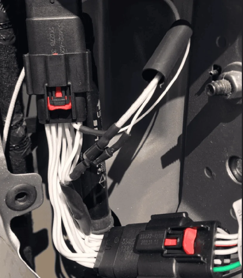

I did the cool tech, and like it...but it was scary as hell. For a couple of days I had warnings on my console, like "left rear turn signal not working". After a couple of start ups though it has completely disappeared.
I also put a switch cover on, over the switch to keep it from accidentally getting flipped.

I liked the CoolTech solution, but was turned off by their price. So, I went online and got a 4PDT switch for about $5, some bulk 7-conductor double-insulated trailer wiring for about $30 for 50 feet, and instead of using the butt splices like CoolTech I used spade connectors so I can easily return the harness to near-OEM condition. I also mounted the switch on the dash, to the right of the glove box. The one thing I'm going to add now is that cool-looking switch cover! I used 7-conductor wiring figuring I might have a need for the extra wires sometime in the future, but I could have easily used the regular 4-conductor trailer wiring.
The connections to the OEM harness are hidden under the front passenger door sill and there are no OEM connectors in there so the chance of a dealer needing to open up that area during any troubleshooting should be low. Last month I had it in to fix the center-mount brake light and they did their complete troubleshooting procedure, from the light up to the BCM, and no mention was made of my mod so I feel pretty safe.
