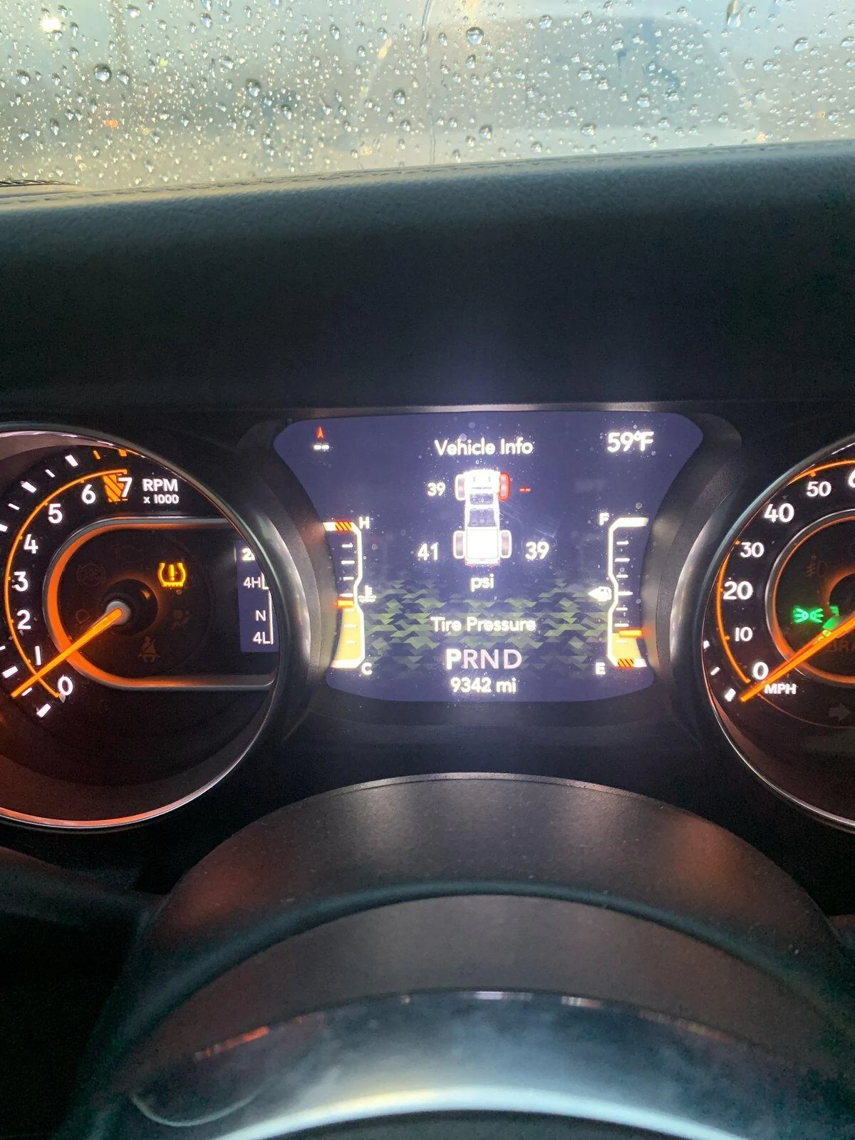

I have a 2020jeep gladiator overland. Does anyone know if the spare tire has a TPS in it. I had my tires rotated with the spare in the rotation and now the TPS light is on. Any info would be great thanks.

The spare does not match the rest of the wheels...at least on my sport s it doesn't. I don't think it has the TPS but i'm not 100% sure.

So there is a sensor in the spare?

By the way. if you want to buy another tpms for your 2020 Gladiator, you want 2020 Jeep Gladiator OEM TPMS Sensor Schrader 29093 (supercedes discontinued 29117) 433MHz .
Did you get a 5th Overland alloy or put the steel spare on with 3 alloys?
No I bought rims and put new wheels on but did not think about the 5th tire not having the sensor till I had them rotated.
