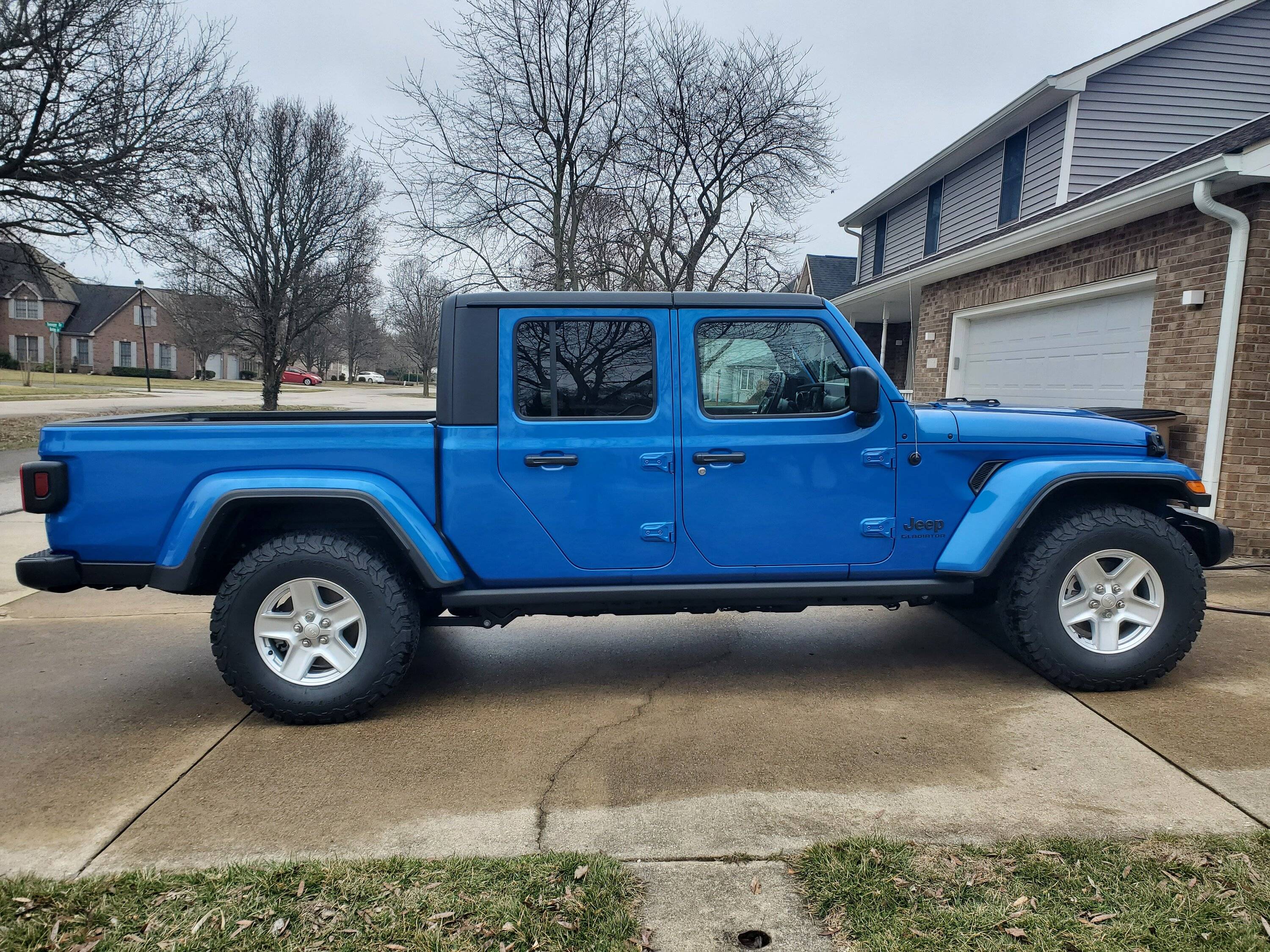

I just put on 285/75/17 tires on my OE wheels. For my 5th wheel spare tire, if I'm going to spend the money for a matching 5th tire I would rather put that on a matching Aluminum OE wheel. I noticed the bore on the steel wheel is much larger than the bore on the aluminum wheel. I measured the center cap knowing the bore will be slightly smaller and its questionable that the tire carrier bracket will fit through the hole. Does anybody know if the spare tire carrier bracket will work with a Aluminum OE wheel? Including a pic of my Jeep to show what wheels I have.

Any lift on your truck or is that factory suspension? I like the ratio of tire to fender space.
No lift! I'm thinking about putting a front leveling spacer up front just to get rid of the front rake. Otherwise I'm happy with it. The tires lifted the truck up 3/4".

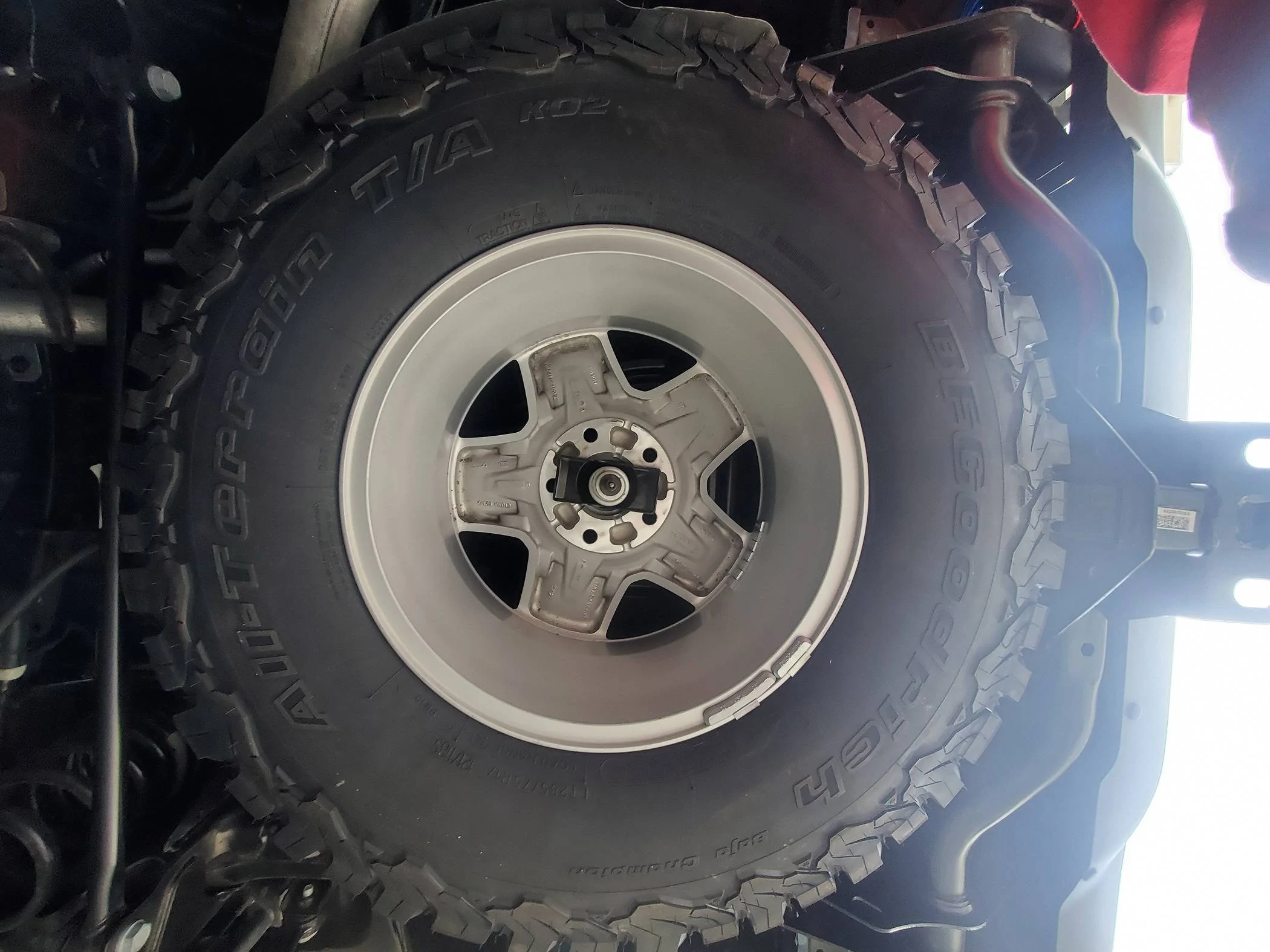

Following up incase someone else references this thread. Here is a picture of my new spare OEM Sport wheel mounted. As everyone stated the mount just barely fit through the hub hole.
