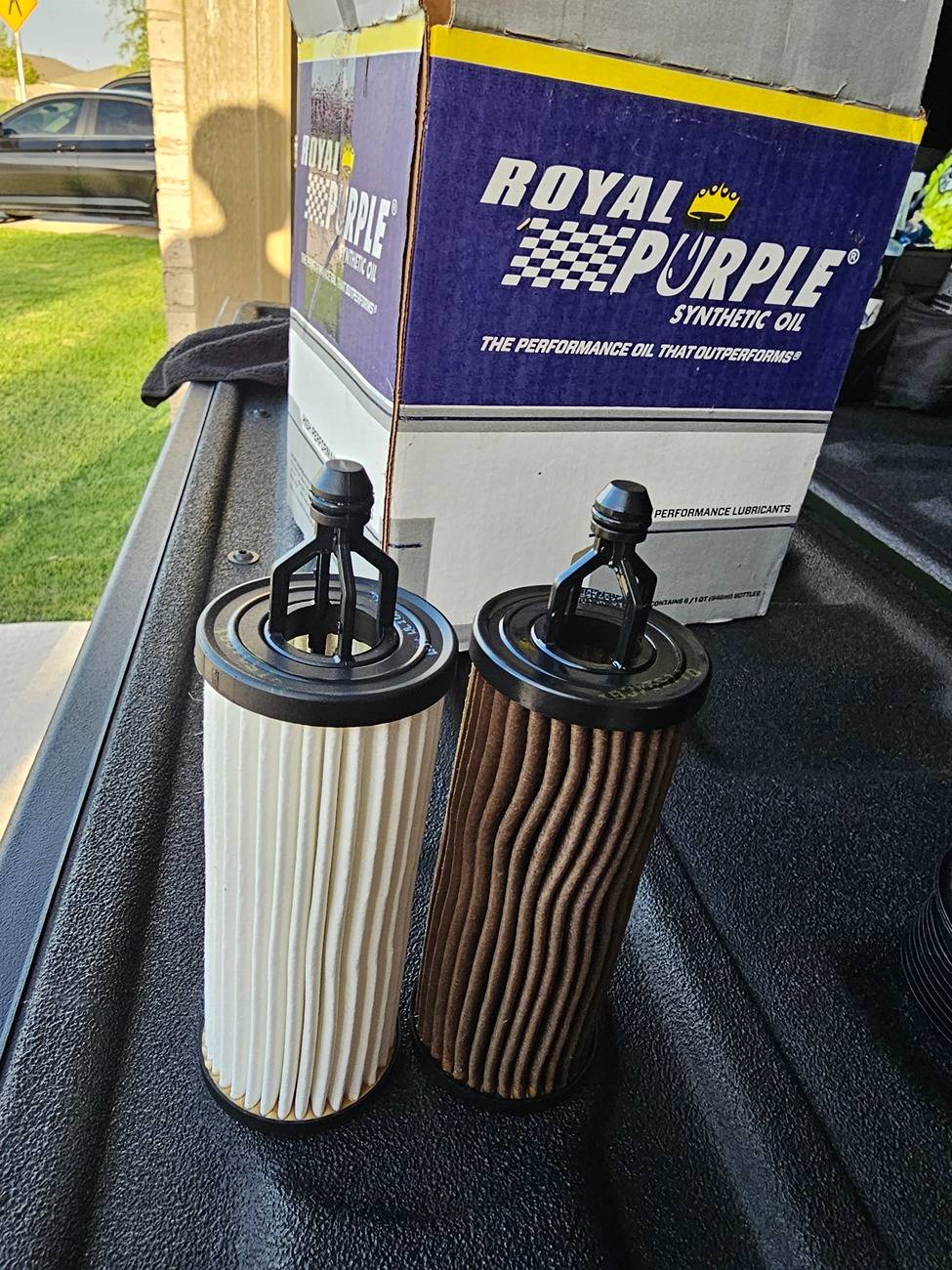

Checked filter and at least by eye no metal debris. My first oil change at 500 miles had just a small amount of shavings deep in pleats but that's to be expected.
You can have wear that is not visible to the naked eye. Going just by a oil filter examination and not doing an actual oil analysis sampling is leaving a lot of unknown out there.
